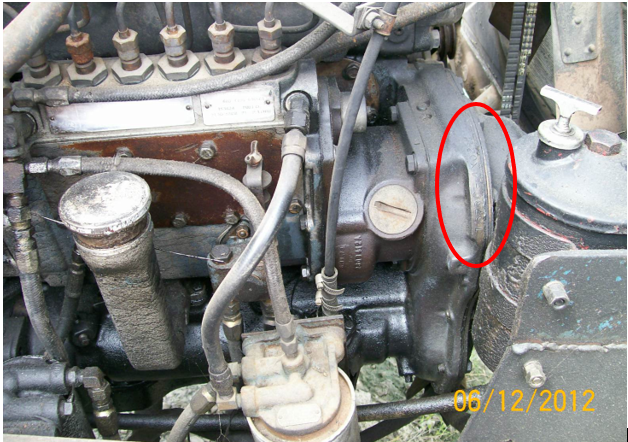

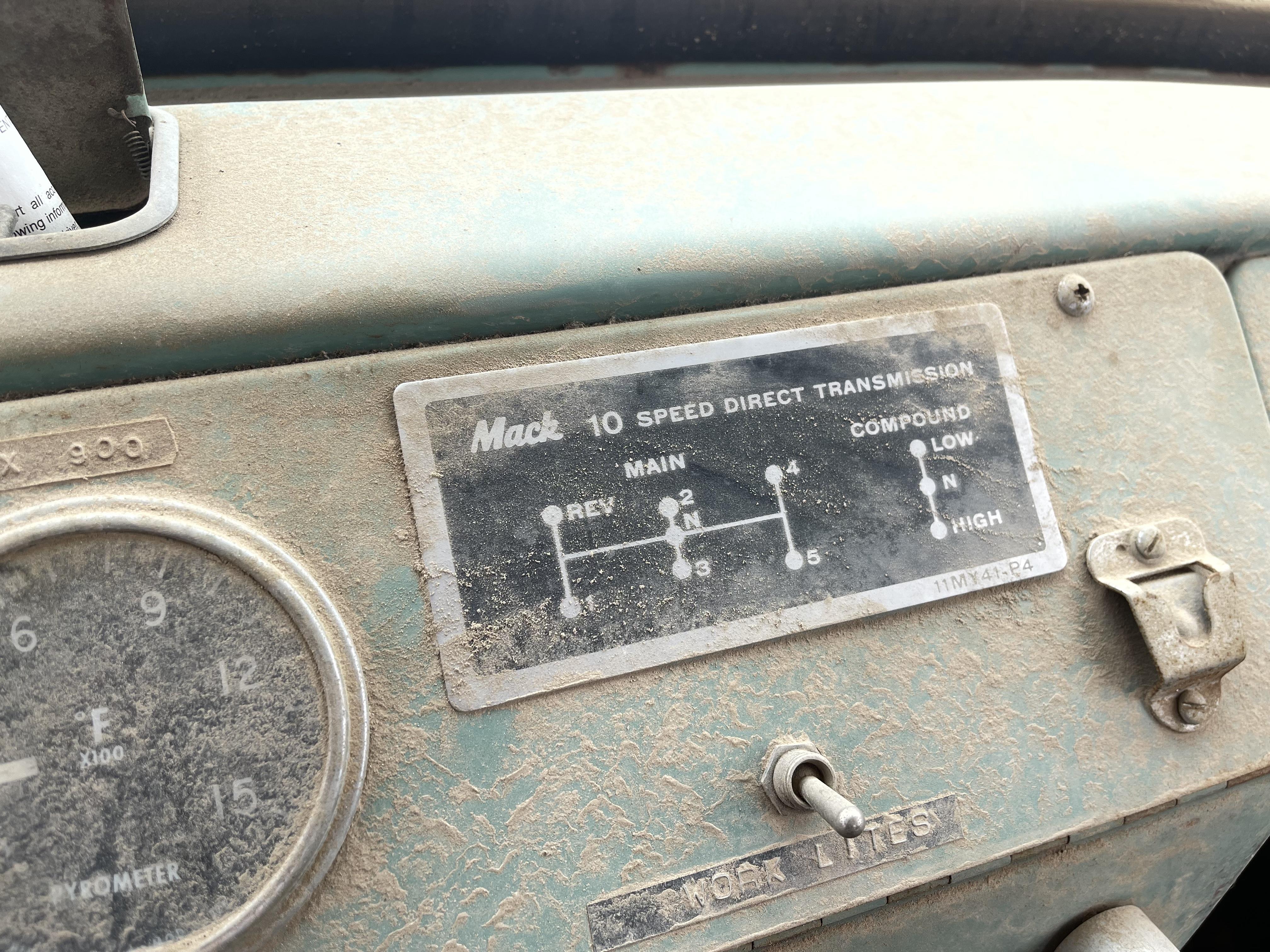

Sounds like a Duplex.  2 sticks?  Got picture of shift plate?  Could be 9-speed (overdrive) or 10-speed (direct).  Very common behind a 673T.  On the gearcase at the front of the engine, you should see numbers like "T673" or some variation (see below).  Those numbers can help identify the specific variant of the engine.  This one says "T673C", indicating the 250HP version, the ENDT-673C.  Also, there could be a tag on the engine that shows the actual HP rating.  On the pump, maybe?  Can't remember.

This is the shift plate. I believe the transmission is a TRD(L) 722(0) it has two sticks and a third one to engage the pto in forward or reverse. I’ll look for some engine numbers this weekend but in another thread I asked about the vin number because on the title the vin number says ENDT673C. According to what I’ve been told is that they didn’t really do the vin thing back in 69 and using the engine code was something they did.

The transmission may actually be just a 722 and not a 722(0).
Yes, then you have a direct drive trans.  The "0" at the end would have made it an overdrive model, and it would be called a 9-speed (hi-4th and lo-5th would have been basically the same gear).  With the direct 10-speed, you can split each gear in the main using the compound.  On the 9-speed model, you could split the first 4 and only (typically) use hi-5th.  Depending on the axle ratio, you should be good for 60mph or so.
If you do have the 673C, that is (IMHO) one of the best versions of the Thermodyne.  I had that in the '70 I had, and I drove one (too) many years ago to pull a lowboy trailer.  Seems like it was a '66 or '67.  Had the 18-speed Quadruplex.  Was a tough, tough motor.  Of course, it was nothing compared to the HP of the later ones.  But, it was a good, reliable piece.
The one I drove back then had the air filter retrofitted to use a paper element inside the original oil-bath housing.  When I had my other one a few years back, I tried to find one of those conversion kits, but had no luck at all.  I think Donaldson has a complete unit that will work, though, if you're interested.
