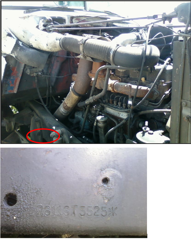

Look right in here...
Thanks! I’ll check there this weekend. Finding that number is on my to do list this weekend along with cleaning up the interior of the cab.
