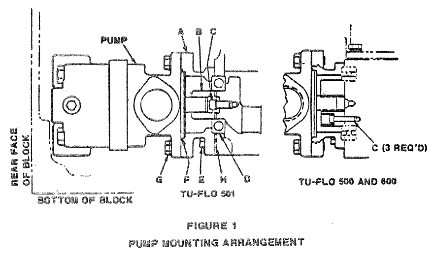

Here is a little light reading for you...
Mack_Tu-Flo Power Steering.pdf

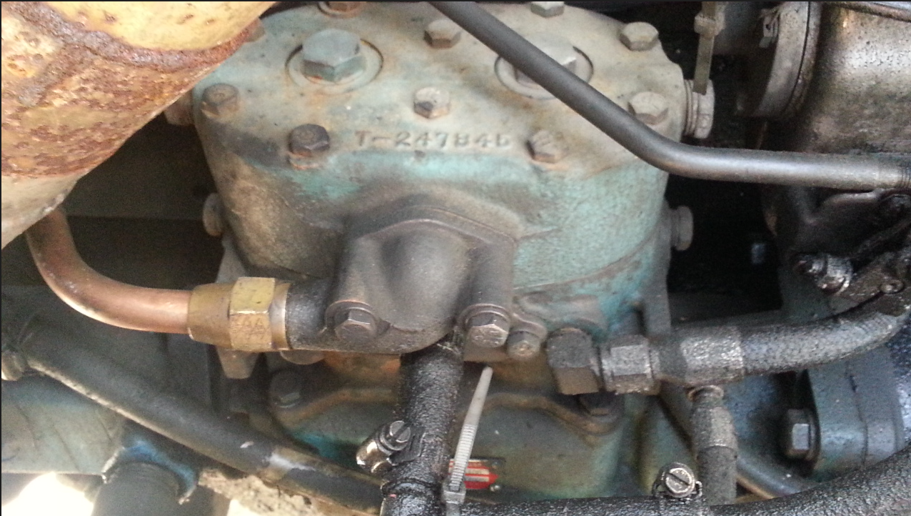

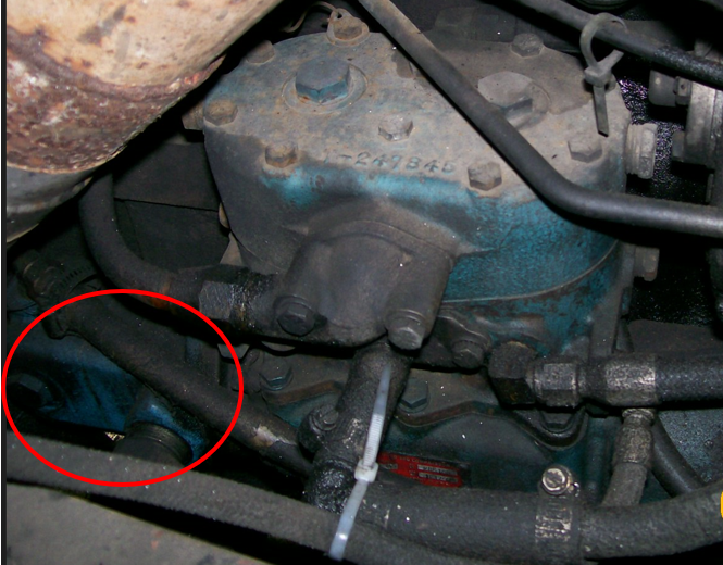

And here is a picture of a Bendix compressor on an ENDT-673C.  The power steering pump is circled in red.
Edited by doubleclutchinweasel

I may be wrong (again) ; the compressor capable of mounting PS pump has a slot  in "crankshaft " end to which the PS coupler bolts to? one allen bolt holds coupler to crank? seems I some what remember there  is a tiny oil port in crank/ coupler combo; ?? PS pump shaft  5/8-3/4 splined.
I believe there are 2 different styles.  One has 3 bolts and the other is like Mecho is describing (one bolt and a key).  Both have a splined bore on the other end to accept the P/S pump shaft, IIRC.

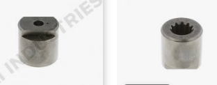

Here is one example...
And here is another style...
Part "B" in the image...
Both the part numbers in the list I posted still pull up on Google from various sources.  So, I believe the numbers are still good.
