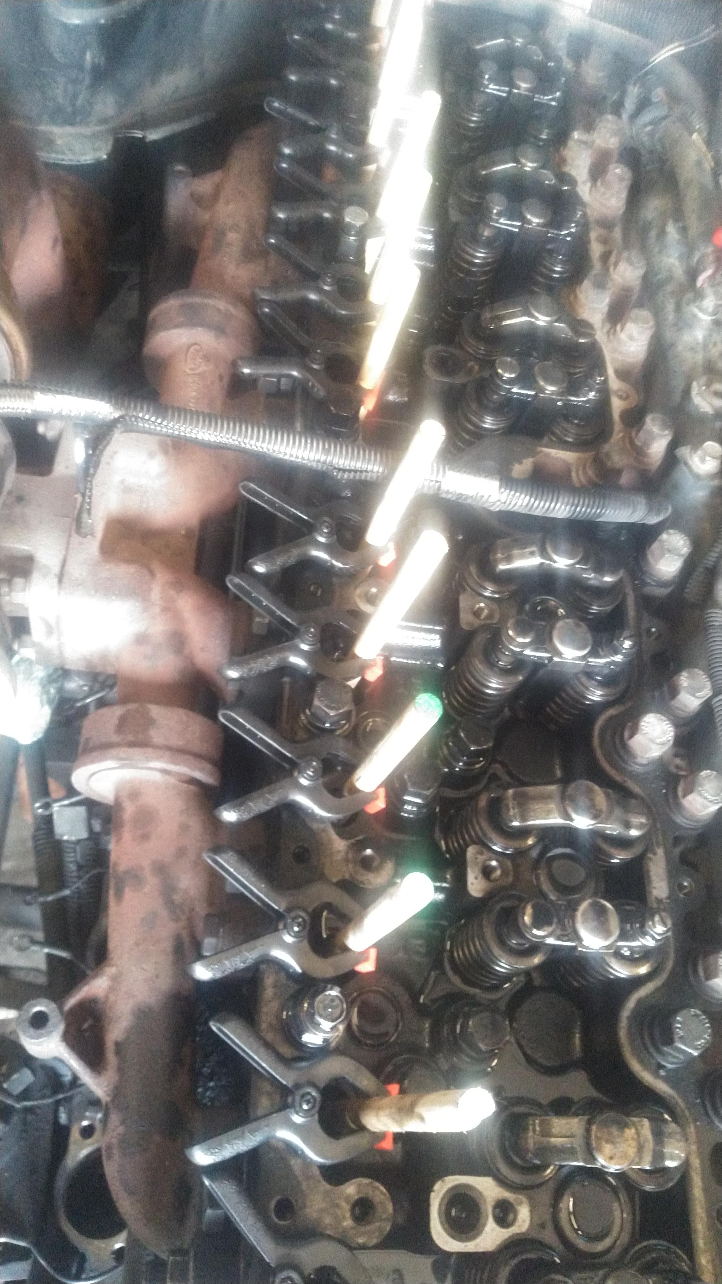

My father was driving my 78 superliner yesterday with an endt 676, 10 minutes after he left the pit loaded, he said the exhaust sound changed and there was slightly less power, he though he had an exhaust leak, but when he pulled in our yard I could hear the difference in sound, almost sounds like one cylinder dynatard was on, parked it at our shop overnight, started it this morning and same sound cold, pulled the valve covers to check and every thing looks right, everything is tight, no cracked springs, started it and everything is moving(not a wiped cam). Leaning towards cracked valve or bad injector, my question is what is the best way to check the injectors before is start pulling the motor apart, thanks (last over head was ran about 8 months ago, truck runs about 3-4 days a week)

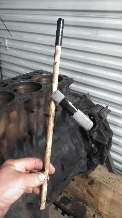

I dont know if you have lifter sticks,  I made a set...  I got 3/8'' wooden dowels, then went to harborfrieght and bought several bottles of rare earth magnets, they have 3/8'' ones there. and i bout 12 of there small METAL  squeeze clamps and a tube of 2 part epoxy..  I cut the dowels to 18''  then lightly sand one side of the magnet for the glue to stick too, and  glue the magnet to one end, then put some electrical tape over the magnet leaving 2'' inches on each side of the dowel, then wrapped tape around the end of the dowel to secure the first strip of tape..  the only maintenance I have is to replace the tape between jobs..  If you dont use tape, the magnet may come off the dowel and stay on the lifter..  Not good..  in the second picture you will see plastic clips, they sucked, so I bought metal ones.. but you can see the results..  jojo

A zip tie around each lifter should create just enough friction to hold each lifter in place if I recall correctly. Been a few years since we've swapped cams in our endt676, but we've done it a few times, pays to have a few spare engines to pull cams and lifters from...
