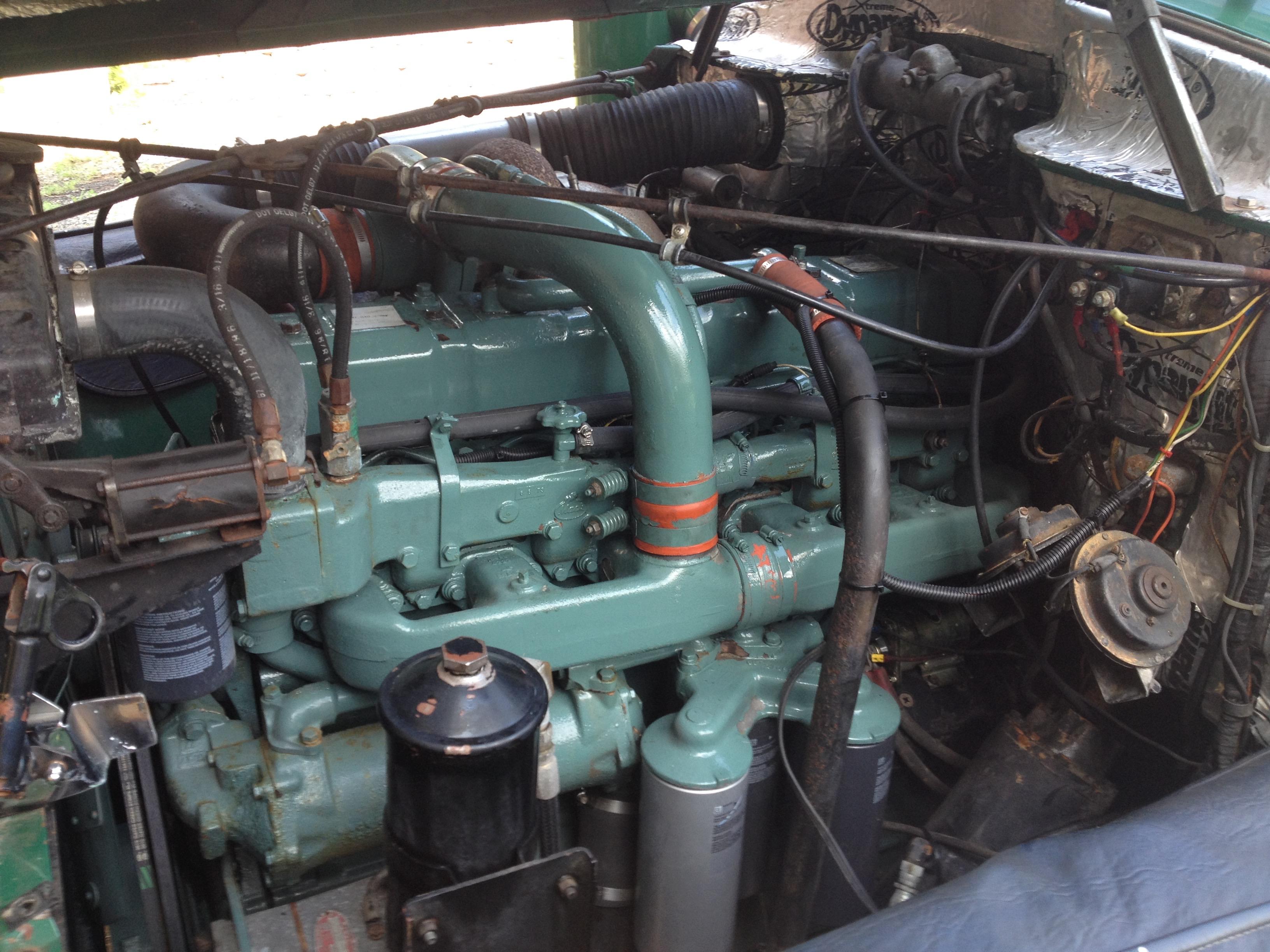

My b-42 must have had the diesel conversion at some point in it's life a couple of years ago I stuck a 1980 260 hp 673 under the hood with a double over triplex the radiator does a fine job no overheating, and the truck really cruses out on the highway.
I would suggest the large radiator if you are dealing with much weight especially in hill country. The large radiator has a snorkel neck in top tank to fill the radiator. My old Draggin Wagon had the small radiator - no problems bobtail even in mountains. Hook camper to it, grossing around 25-26,000, really had to watch temp
I put a 237 in mine also.  Simple swap from the 673.  Just changed waterpump and balancer.  I still run a triplex.  I have the big radiator and does fine with my 30k lbs.
Mine is the gas 331 I know the water pump neck is longer on the 237 but why dose the balancer have to be changed.  clearance issues?
My balancer was missing on 237, but I think it is too long and will hit crossmember.  The R model has much more room behind the radiator and the pulleys stick out farther.  Thus the waterpump needs changed also.
