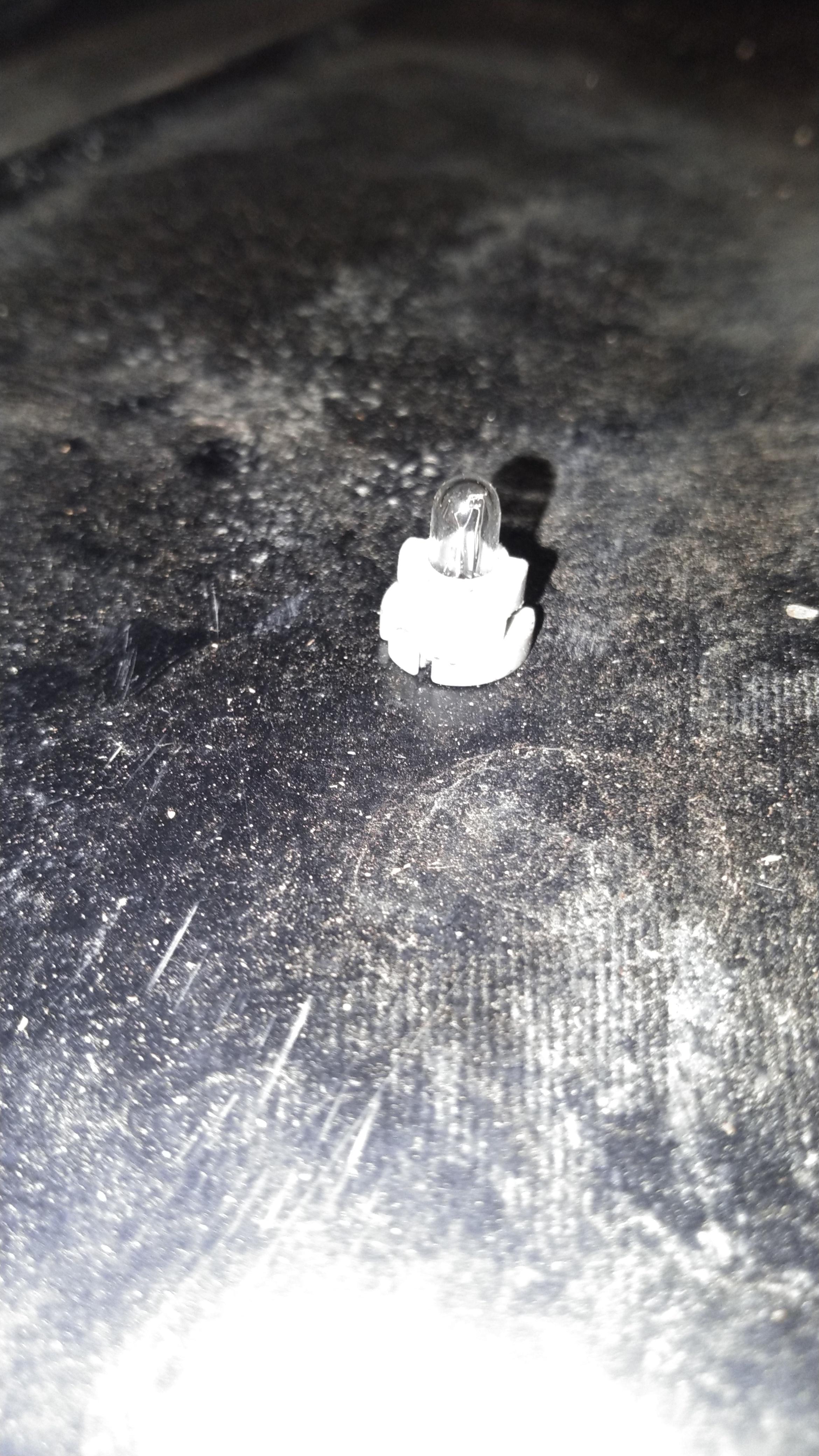

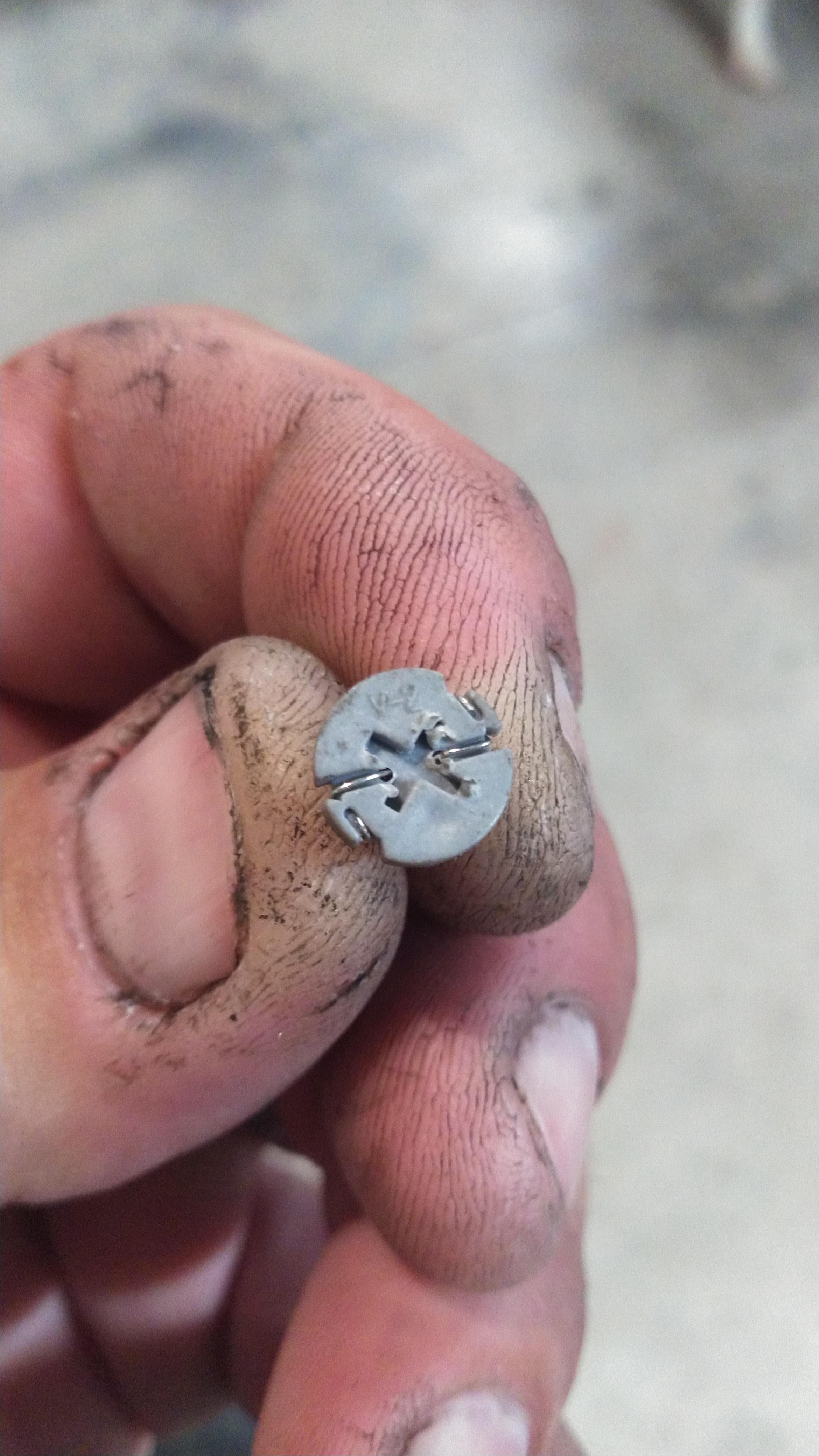

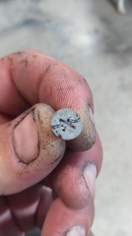

On 7/6/2021 at 7:31 PM, Joey Mack said:
Ok, I forgot that I had some bulbs.. Forget #68,, i think those were for the strip that has the turn signals and low air and such, like in an MR or LE...  I believe the bulb pics I sent are correct. Just look to see if these bulbs are in the circuit board... Jojo
There is a working mans hands.
glenn akers
Thanks Glenn,, Hell I already had my shower.  guess I need better soap,😄  Do you remember the bulb type? jojo
