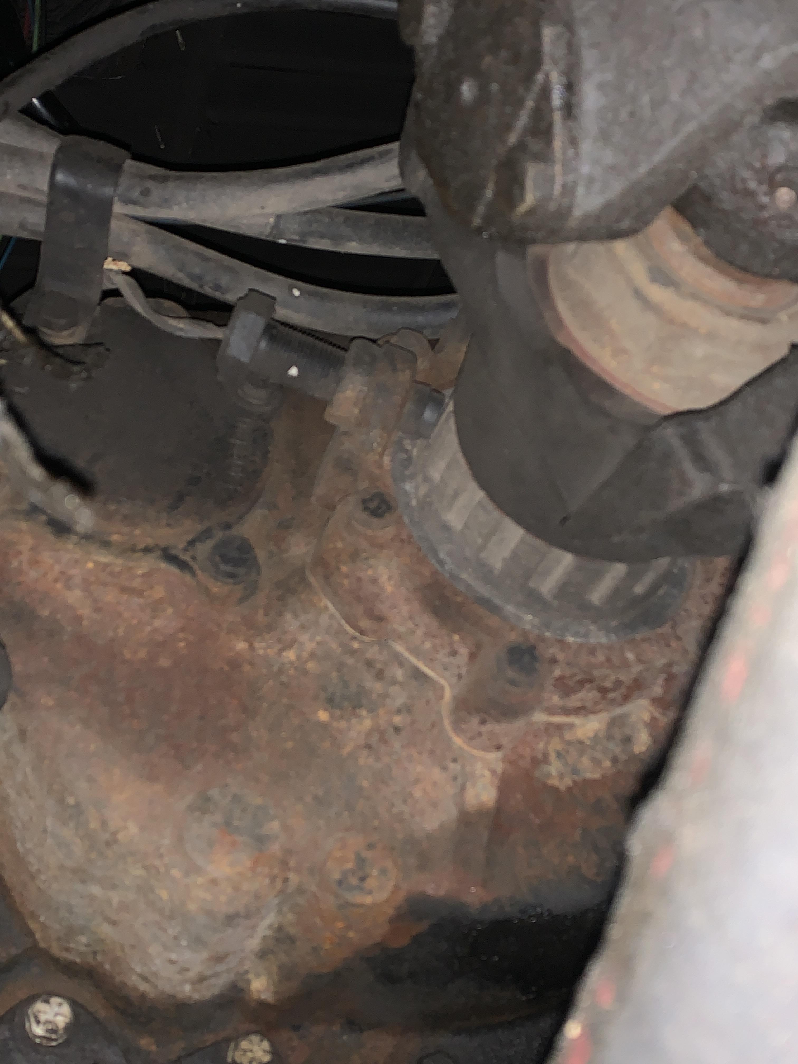

The sensor's plug might be close to the reverse switch's plug.  Might be from touching wires there, hard to tell without being able to see it. Did you look at it ?  wiggle the plug ?  unplug it and plug it back in ?
I was looking at it before the rain storm started, I wiggled it to make sure it was plugged in, when it dries out tomorrow I want to try unplug/plug and see if that does anything
55 minutes ago, Joey Mack said:
If its not damaged.. back it off.... then ...by hand.... screw it in til it touches,,,, then back it out 1 full turn. 360 degrees... jojo
I am assuming you mean to loosen the jam nut at the bottom, and screw the sensor itself down until it touches, back it out 1 full turn and then tighten the jam nut back down?
I’ll be able to screw the sensor with my hands or will I need a wrench?
Edited by Dmurph2016
That's what he's talking about. Check on top of the transmission and look for something disturbed from the reverse switch issue. The sensor's plug is likely up there. It's not impossible the speedo sensor is bad as well. On occasion, those plastic ones don't live through being touched ( like as in resetting it's depth )

Update, I unplugged the sensor and plugged it back in and it was working, took the truck for a drive and no issues. I ordered a new sensor from the dealer and will install when it gets here. I’m not sure if it was a coincidence or just the sensor being on its way out (no idea how old it is) so I’m glad it was something simple this time!
If it works, leave it alone ( lol )
