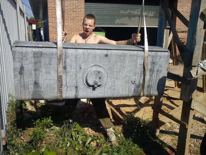

We did that kind of shaking. Hanged a tank on a pair of cargo straps, poured 10 liter of diesel in it and addad half a bin of gravel. Than shooked back-forth by hands. I had two young guys hired at the time and they did gym with the tank for 3-5 minutes a time changing each other. After 3 or 4 attemts they went to do something different and came back in an hour or so. Took them a couple of days for one tank (we made two) to get off rough rust but way not as after sandblasting.
