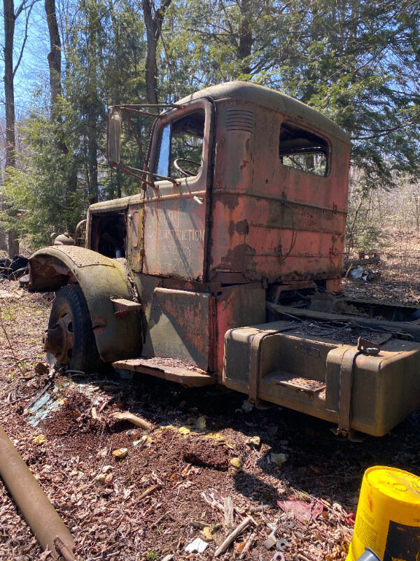

1941 Military NM-3 6-ton 6x6 1-104 made
According to Wikipedia,
"The NM-3 was the last model to have an enclosed cab. It was similar to the NM-1 and NM-2 except for: front pintle for positioning artillery pieces, arched bumper (front pintle under the arche), smaller brush guard, side lights on mudguards, towing hooks on bumper deleted, radiator shell with Mack nameplate. "
From further research, it's a 1941 NM-3 of which only 104 were produced.  Most apparently went to the UK so this may be the only one in North America. Pretty cool.
Some had front duallys as well.
Edited by PheadrusGs
Trust me, I want to but it's a 15 hour drive from me.  My concern is also that the engine side engine covers are missing, glass is gone, gauges are smashed, etc.  Would the gauges and side covers by hard to find?  I assume the glass is just flat and can be made.
Side covers miggt be tough, but I bet there are places that can build those. The gauges can be rebuilt too. It just takes money.
The big issue is the cost to low boy it to my place(1500km/950miles one way).  Likely $3000-$3500.
Just talked with the owner.  It was never sent overseas for the war.  It was used at the bases here in Canada sparingly until it broke the crank.  It along with about 12 more, were sold as surplus to a company that the current owner then bought it from.  He put a dump box on it and used it for hauling gravel for 25 years and said it would haul anything.  About 25 years ago, the engine just stopped one day and antifreeze came out the exhaust.  He figures it dropped a valve
He even used it for the weekend tractor pulls and it out pulled everything.  Also said it actually wasn't too bad on fuel either with the 707 gas.  He had a guy come by last week that said he wanted to cut the doors off to hang in his shop and scrap the rest.  UGH!!  I wish I could find a way to make it feasible to get it to my place.  But at 10 tons, anything but a lowboy isn't possible which makes it an expensive propostion.  I'm waiting to find out if my offer was accepted for 3 B series and maybe an A series so maybe I may have to pass on the NM-3.  I just hope it doesn't go for scrap.

I would pass on the other trucks before I passed on that one. That one seems pretty rare.
The gauges are mostly standart military gauges. Were used on Willis Jeep, Dodge WC etc. Check out Kaizerwillis.com (or so), that guy has the most of the gauges you need. Excepting the tacho which was not used in Willis but was in GMC, White halftruck and some other WW2 vehicles. Glasses are all flat glass, no trouble. Windscreen frames could be an issue but they're a L-model part. Original engine model is EY but in fact it's a common Thermodyne 707 gasser with modified oil pan to accomodate the front drive axle. Could also be easily swapped to END diesel off a B-model or so.
Hi Down in Atlanta. Thats an L model, one o the most collectible of the older Macks. Definitely worth getting. Parts are relatively easy to find. I have two a 1945 ad=nd  1949. If you are patient on ebay the stuff pops up. Notice the space in the front bumper for the military hand starter crank.
They're original. That's original military Mack NM. The matter of the question at the time is it's an early steel cab series model or a later open cab one with a commercial L-model cab installed.
17 hours ago, BOB DINGSDALE said:
also has timken rear ends and spring and torque arm set up. don;t think  they are origanal.
Engine                Mack EY707, 170 horsepower @ 2,100 rpm
Transmission    Mack TR36 five-speed
Transfer Case   Timken-Wisconsin T-77-3 two-speed
Axles                  Timken-Wisconsin 7.33 ratio
