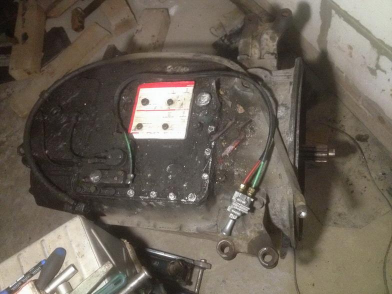

In the picture is T2090 Mack transmission I removed from my Earstern R688 of 1988. Note that the mounting brackets have offset to the front. If you put them left to right the engine will go forward so not your case. But worth to investigate weren't such brackets used in Western or just early R-models of a straight style?

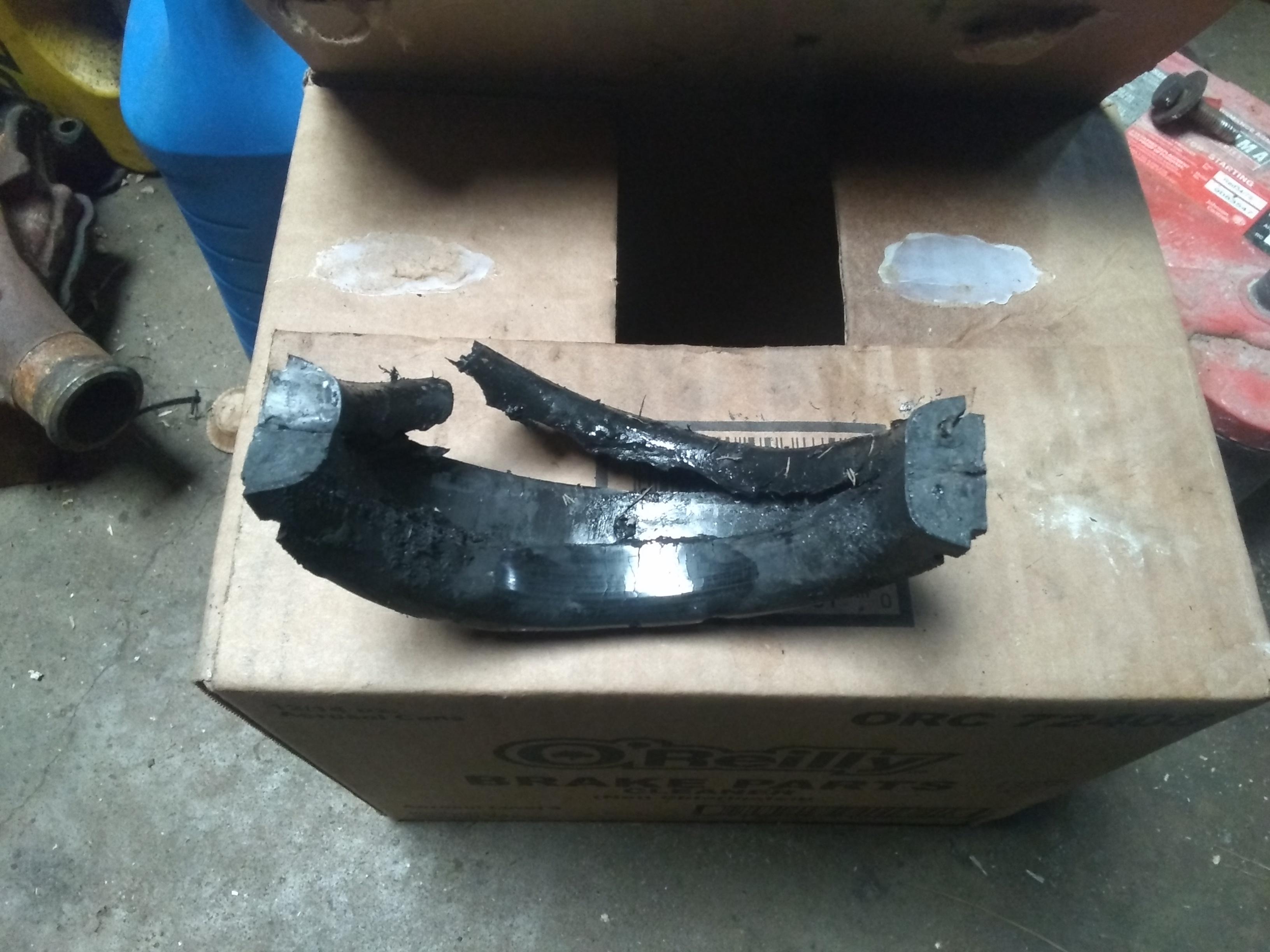

if I recall correctly, the front cross-member that #14 engine mount   bolts to is a flat  three-piece cross member.  by slim chance was that taken off the two frame end pieces and put back on back wards; meaning on front of end pieces instead of behind. that would be  5/8=3/4 difference. was same model trans put back in?  after almost 50 yrs of pushing wrenches ( and a lot of cans of brake clean later; LOL)  the memory is taxed often.  mack mounts had slight off-set. backward mounting would make installation of the bolts challenging.  being 685 had to be maxi , roadranger would have had different mounts  . are both rubbers being chewed up like in the picture??? with new rubbers ,hood open so you can watch , what happens if you mash fuel pedal quick shot?  engine,trans moving like something broke you can't  see ?  I doubt it. if there was the stick should be moving around every shift.

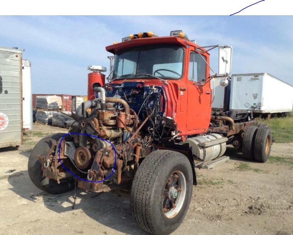

Only the bottom half of the front isolator is getting chewed up. It is the one carrying all the weight.

I don't think there is anything wrong with the front mount. When you take the bolts out of the rear mounts and push the engine forward til it goes through that mount, everything looks great. The problem comes in when you have to slide the engine/trans back so that the rear mounts line up.

NOW I SEE ;  forget the front.  we are all in the same book, just wrong page,  to the back we go!!  there has to be a lot of movement some where. even sitting on half the front mount, shouldn't rip rubber  like picture in 3 months.
The rear isolators were done at the some time as the front.
studying the picture of the 2090 trans earlier post which has mounts installed correctly, could it be possible being an RL  the mounts would go on backwards? I've never seen  mounts turned around; but back in the day mack westerns weren't  common on the east coast.  when  everything is pushed forward and looking good, how far off are the four bolt holes? same distance  +  -  to proper line up if turned around?  stated earlier trans work was done. do you know the same combo was put back? there aren't that many different set ups for bellhousing / mount combos if mack   components  are used .  RR trans would have  different mounts  ,

Looks like if I flipped the mounts around, it would push the engine too far forward. The driveshaft from the trans to the carrier bearing would not be long enough. Looks like a flip would move the engine forward a couple of inches, maybe more. I don't need that much.

He meant IF Western R had those rear mounts ORIGINALLY put backwards and now installed as on the T2090 pic...
