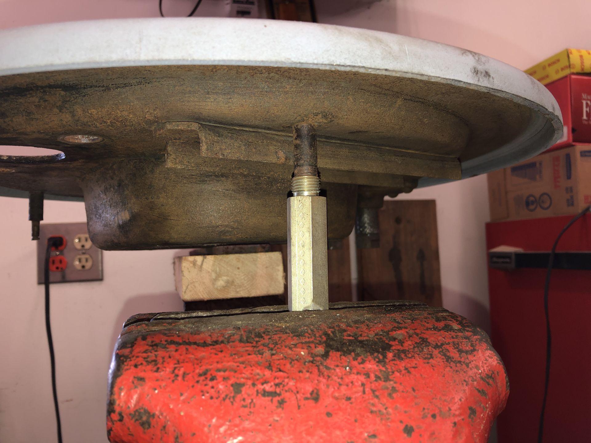

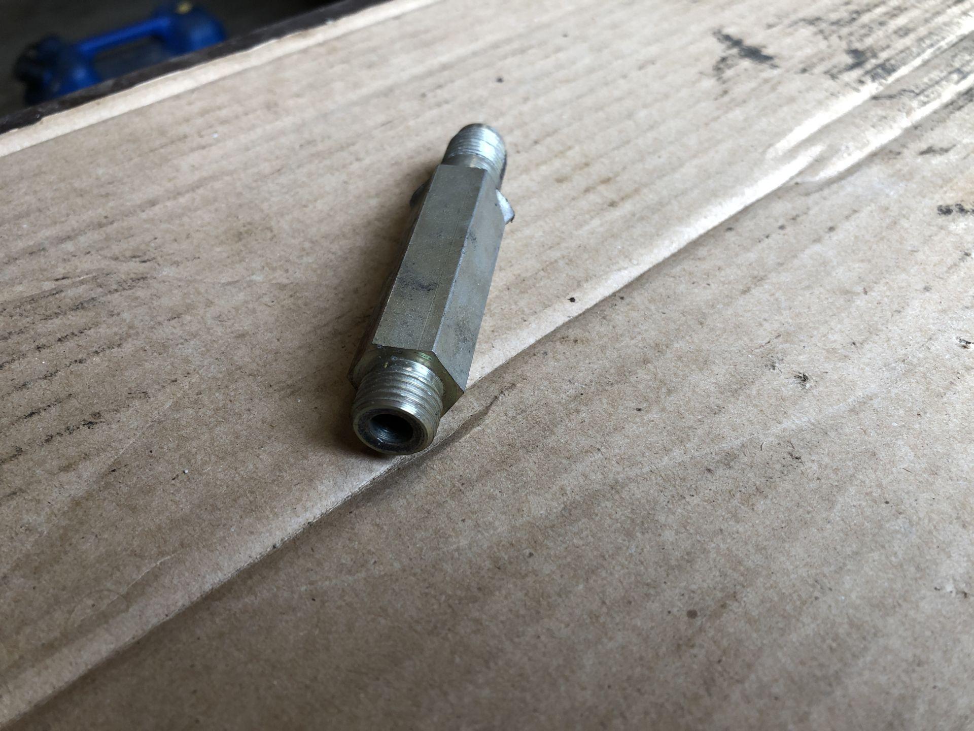

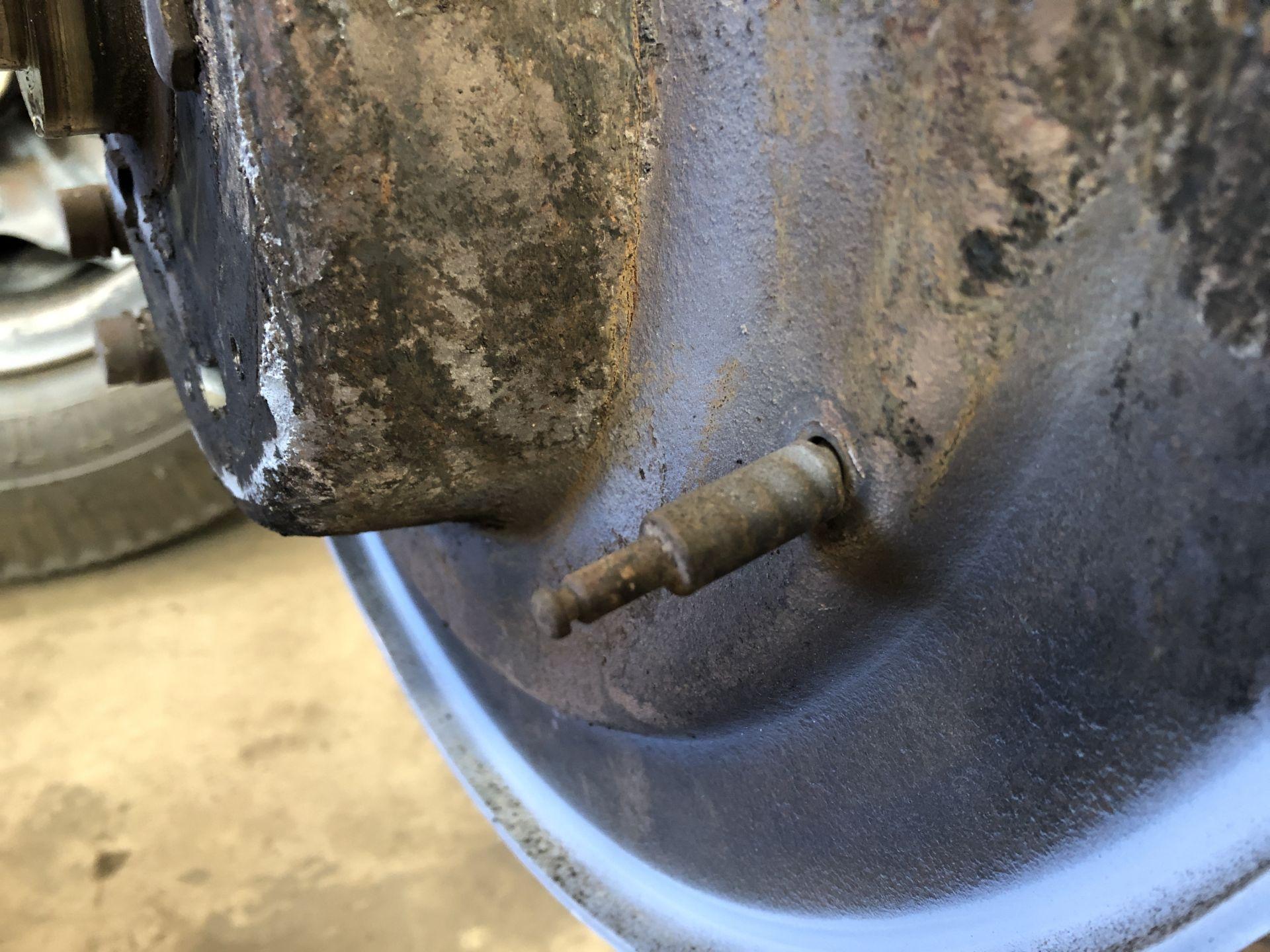

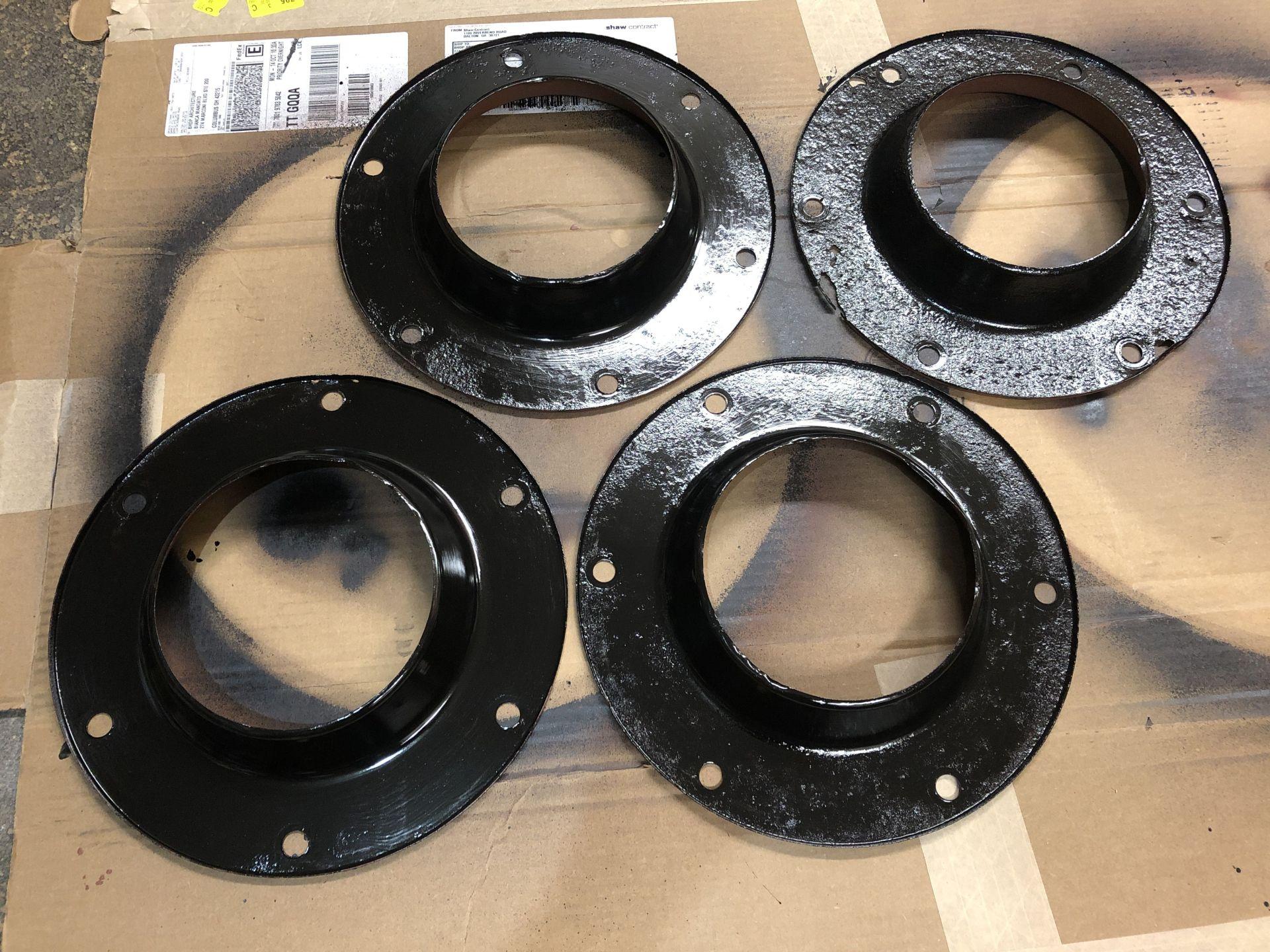

I'm trying to put my front axle together; as you can see the shoe anchor pins are loose in their holes (and one fell out). I tried to curl the hollow point rivet ends to tighten them up, but they are really hard. Does anybody know where I can get replacements or a good way to replace these?
My rivet setter fits in an air hammer; I flailed on that thing but it still wouldn't tighten it up. One problem is the other end is so skinny, it started to deform so I quit. I guess Mack had a special jig to hold it while they bucked the rivet.

Did to try a truck brake shop for replacements or if they have a tool for installing them?
 If not I would try a little heat, try to re-rivet it and quench it with light weight oil. Can you catch the pin in a vise at all? Another alternative is to drill and tap the back to bolt it into the backing plate.   You could also try braising or a few mig tacks to lock the pin to the backing plate. I don't recall seeing them as separate parts you can get

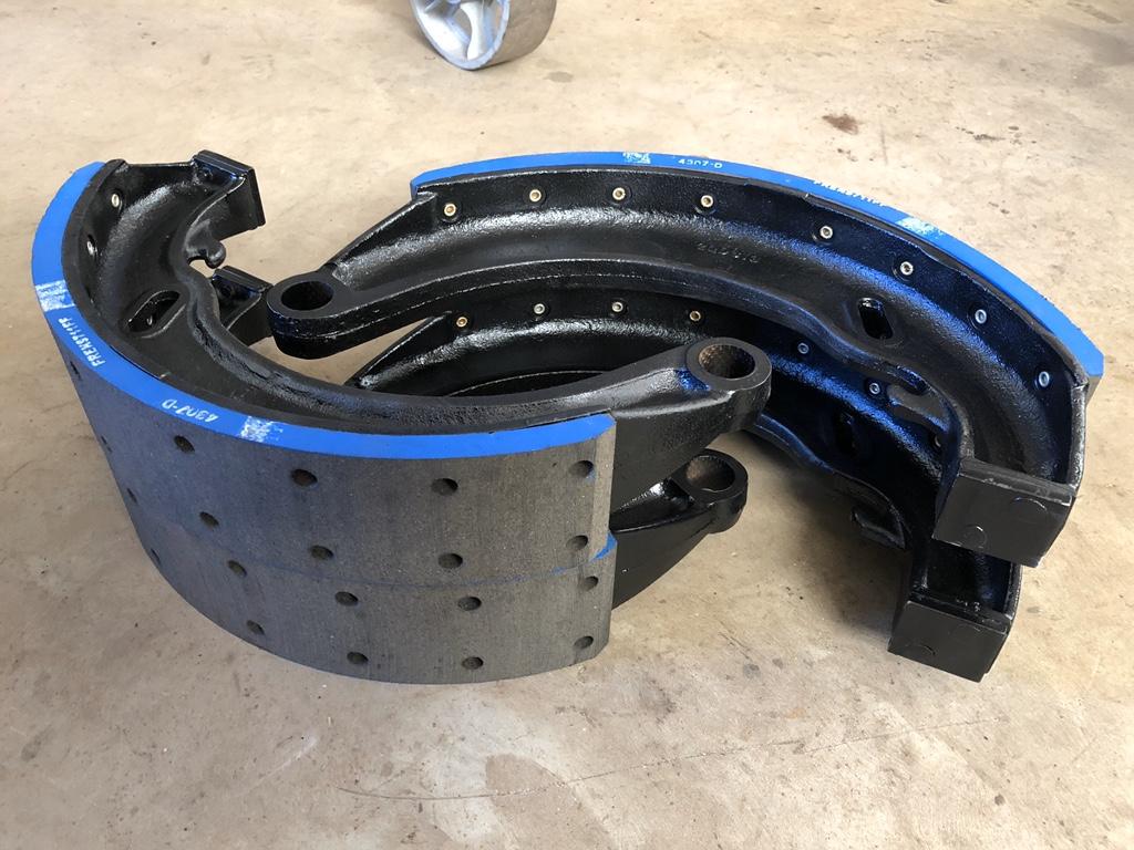

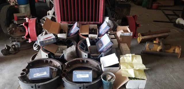

That really is not bad at all being all inclusive. I know having the rears on the B-673 relined and all wheel end hardware, (F&R) was right at $650.00. Finding that older stuff is difficult and they had to grind the friction material to the proper contour which is a long forgotten process.
