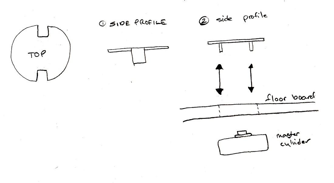

Sorry, no pictures.  I don't even own that truck anymore.
Here is a drawing of what it looked like.  Made a metal circle larger than the access hole.  Bent a couple of tabs down the same diameter of the access hole.  The tabs and the weight of the floor mat kept it from moving around.
Being that yours is a fire rig with probably no floor mat, I would use a piece of metal held in with a couple of screws or Dzus fasteners that could be obtained through a local hot rod shop or Summit Racing.  See link.
A couple of minutes messing with the screws or Dzus fasteners is better than going under the truck to check the cylinder.
