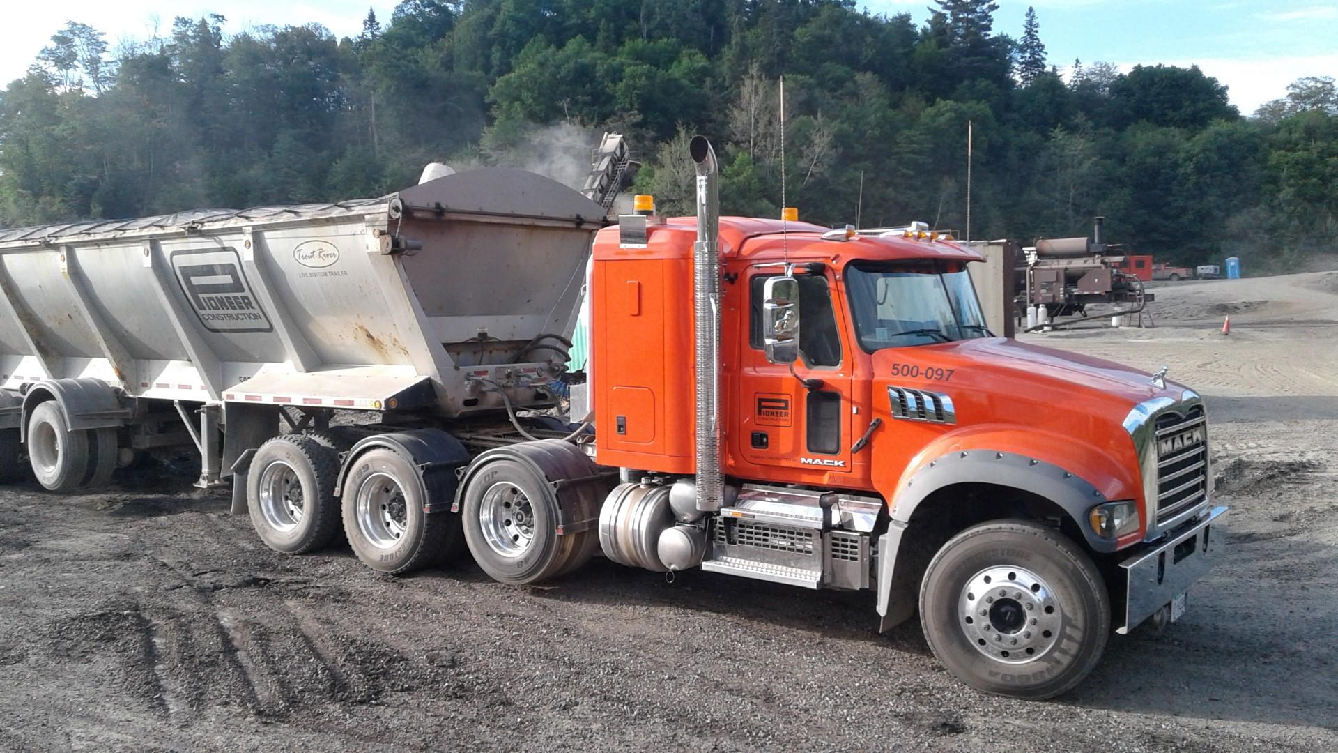

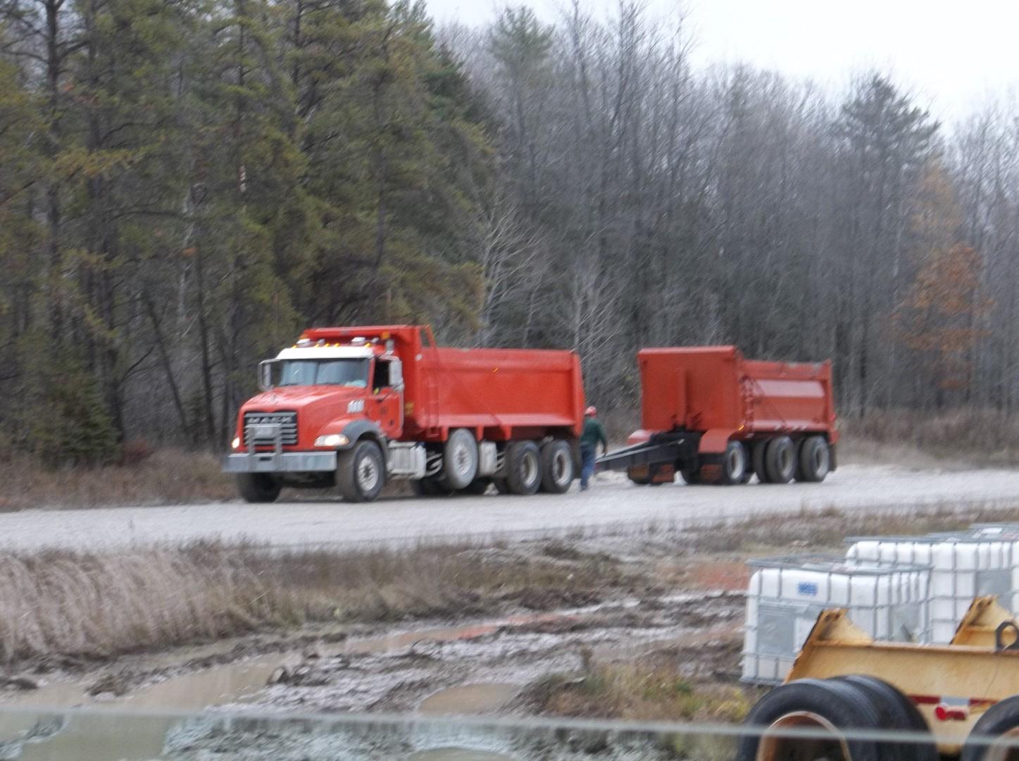

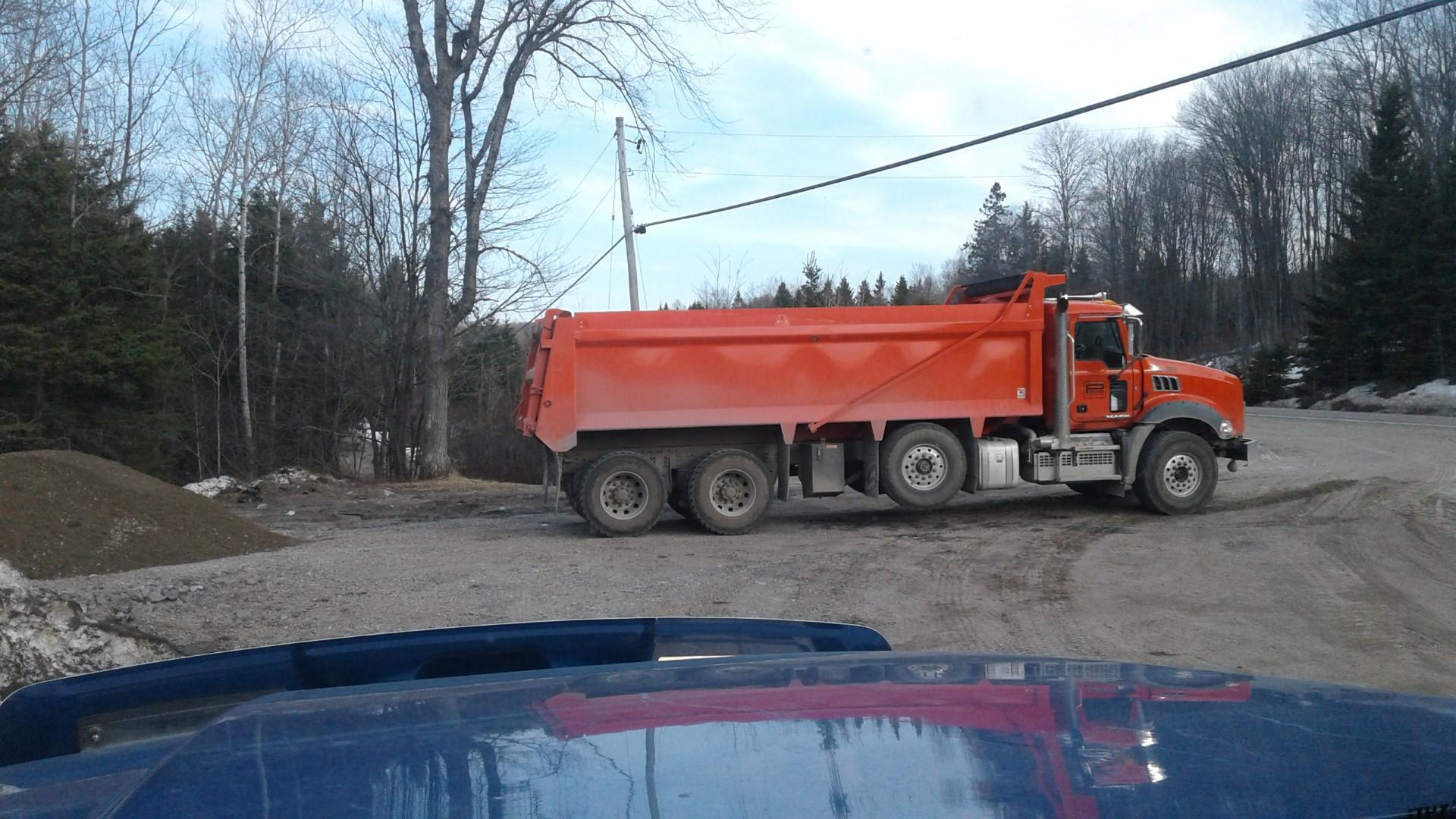

Here's what they got. Nice looking units.
Those are beautiful trucks... that triaxle is nice and long too...
