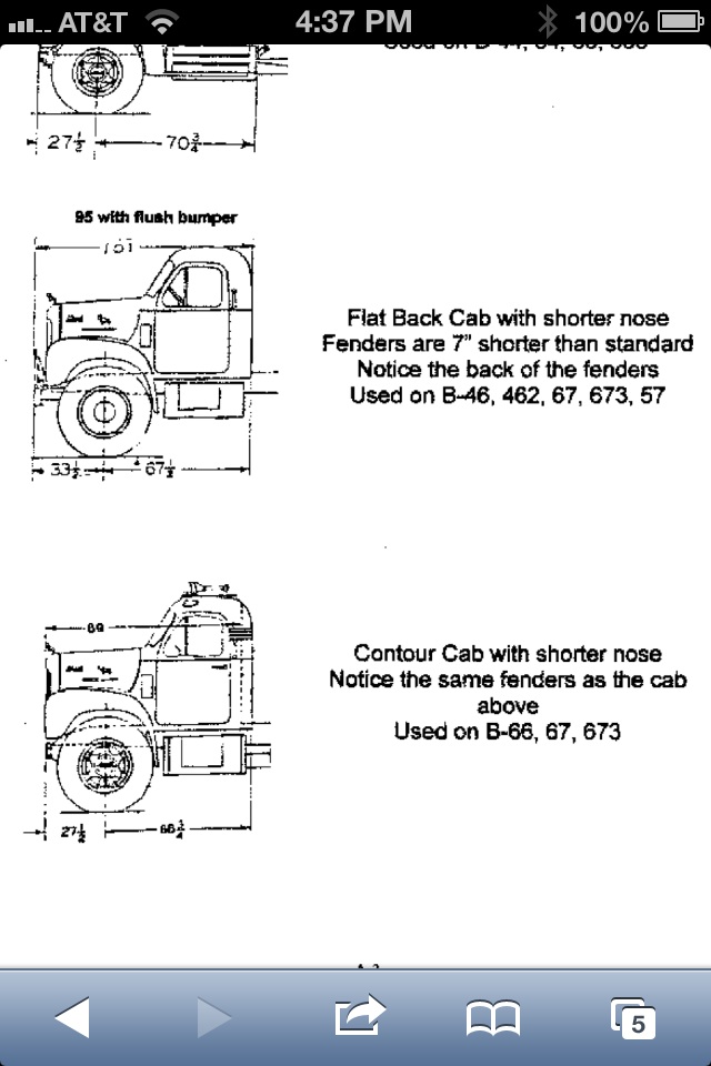

The MACK Museum sent me lots of interesting info on B71's and on "my" 71.   Here is the measurements of the B71 from a sale brochure ( I hope it's readable ).     I did some measuring on my B,  Total hood length, ( next to center chrome strip ) is 53 inches , rear edge of the hood to front of radiator is 60 inches.

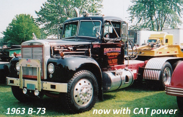

  All of the 70 and 80 series had long hoods.  I'm not positive but I believe the CUMMINS was available in others?   A few years ago I saw one with a 1673 CAT in it,   I think it was a B73 but not sure ???     I think  the B71 was CUMMINS powered only.    I am thinking the B71 also was the only B with a set-back axle??

The B-73 you saw had a transplanted CAT engine.  Originally it was a Cummins.  Not aware of any US regular production B's getting a CAT.
Jim
I was thinking that technically calling the "71" a set back axle was not correct.   If a B71 & aB61 both having the same wheel base were side by side with axles centered with each other.  Everything would be in the same place, ( cab, fuel tanks , fenders, steer axle ) other than the radiator would stick out farther,      Correct???  Or is there still a difference?
Correct.
The dimension from the centerline of the front axle to the back of the cab on your B-71ST is 74 1/2" with a 146 1/2" WB (for example).  A B-61ST with the same WB would also be 74 1/2" CL axle to the back of the cab.
Your B-71 is 38" axle to front bumper.  A B-61 is 27.5" axle to front bumper if utilizing a flush mounted bumper or 33.5" with the extended front bumper.
Everything would line up except the radiator and bumper.
