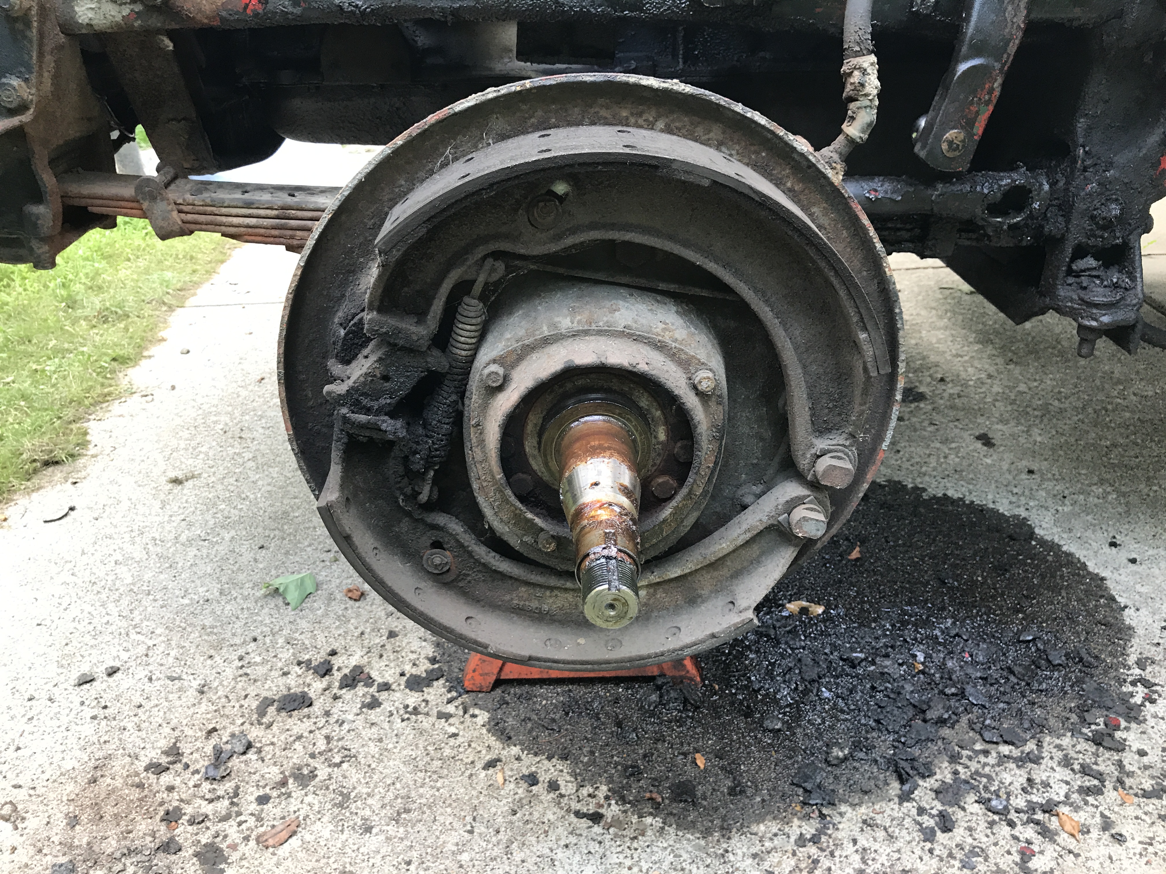

I went to Watt's on this and they straightened me out on what all I needed.  Got a short stroke 30/30 chamber and was lucky enough to get the original clevis yokes off the old Type 30 chambers.  Another question.  Pictured below are my front brakes before I got them relined and new springs.  What tool do you use to put the springs on?  I have seen a couple s-cam tools, but they don't seem like they'd work with these types of shoes.  I do not want to spend money on things that won't work!  Thanks for all the input!

When I bought  the  BCR,it already  had 2 30/30 chambers  on it with a toggle  valve. I changed  the  toggle  valve to a PP1 parking  brake  valve . The chambers have been trouble-free so far and clearence has not been  an issue. I have been  warned that the spring  pressure  of the parking  brake  chambers may be too much  for the old spiders. So far,so good. Definitely  not a good  match  for aluminium  spiders,though. Being a B -81, I would  highly  doubt, you would  not encounter  that problem.  Used Midland-Berg and  Bendix  air line  schematics sheets to route the system. Not a difficult  job and we'll worth it in the "peace of mind" department.  Springs  go on easier with the shoes backed off  all the way and I  have  used every thing from a tapered lineup punch/crows foot to a home made tool made of  a  piece of  5/16" round  stock win groove  cut in near the end of  it , to hook up the return  springs. Good luck on your  project. Al
