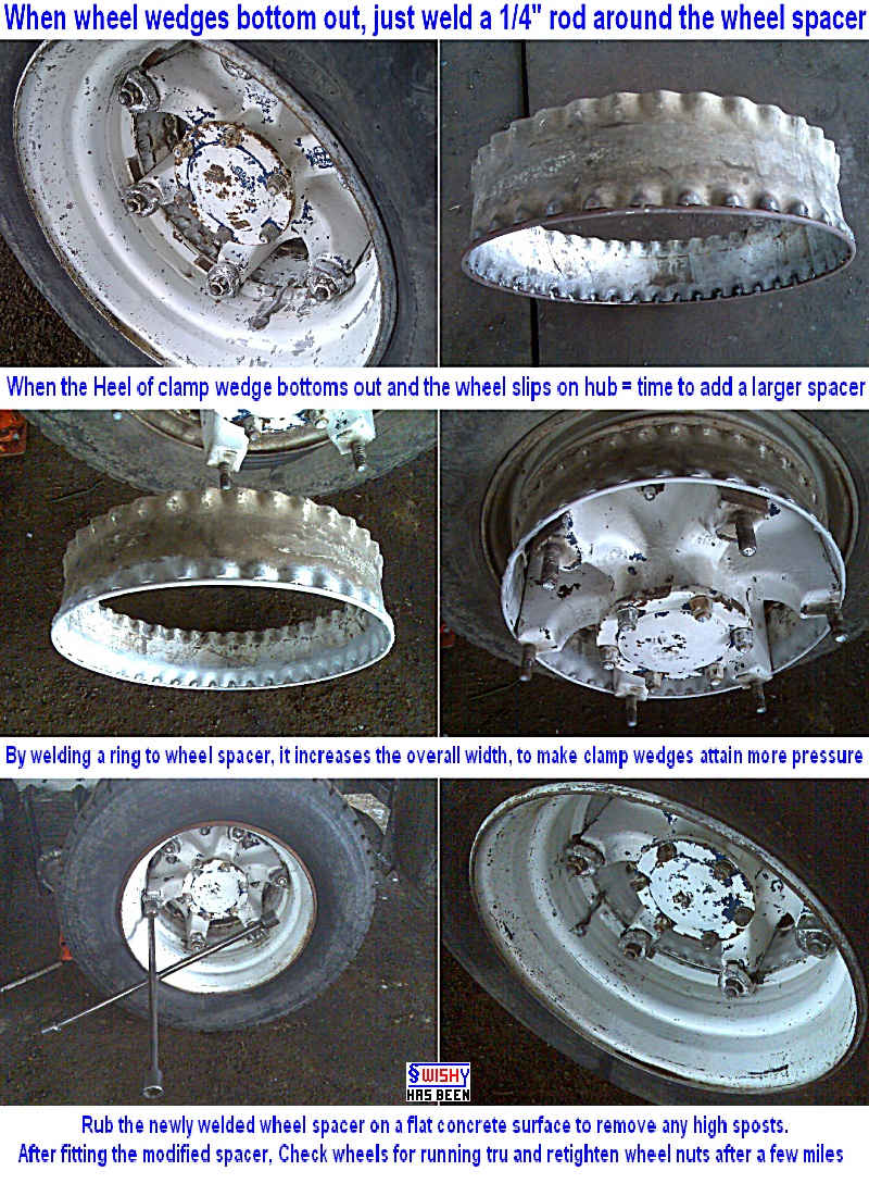

     One of the rims on the rear of my wrecker spins on the rim. Due to my less that perfect driving skills, I popped the clutch and the rear outer rim spun past the little bumps that are supposed to stop that and broke off the valve stem. I got the valve replaced and tightened everything back up. A few months later the same thing happened. This time it happened starting up normally. Could there be something wrong with the rim and/ or clamps? I tightened them by hand with a breaker bar.

On your spinner, do the wedges tighten all the way down to where they touch the hub? If so, you've got worn parts. There should be daylight between the hub and the wedge when the nuts are tight.
The spacer between the rims also gets worn, over tightened, and smushed skinnier.     If that happens the wedge will bottom out and and not properly clamp the wheels tight.      My personal guess is start by checking the spacer.   Maybe measure both sides see if the  one side is narrower.
Umm... I'm no expert on split wheels, clamps, and spoke hubs, but since there are no moving parts to wear, welding a 1/4" rod to the spacer doesn't seem like the way fix something that should not be happening. If something weakens from fatigue after 50,000 miles it probably should be replaced/repaired. Maybe that's the case with the spacer(s) getting... crushed??? But it seems like if something fits correctly after being fully seated, (and isn't a wear item) the wheels or hubs or clamps or... something ??? is weakened and stretching (studs, clamps), getting crushed (weakened spacer) or flexing ???

RE: clamps, and spoke hubs, but since there are no moving parts to wear
Sorry to disagree
but all them bits wear a tuch ovr time.... eye'm talking older trucks th@ have many wheel changes
we have many wheels and sum have had a 1/4 to 3/8 rod welded on wheel spacer
Butt there again ............. eye bin playn with truck wheels (spider/spoke, Wobbly wheels) for more than 60 years
so guess all new parts could solve the problem
cya
