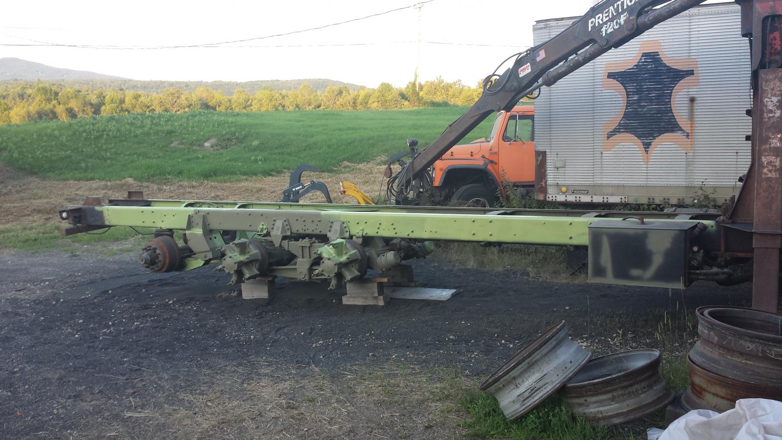

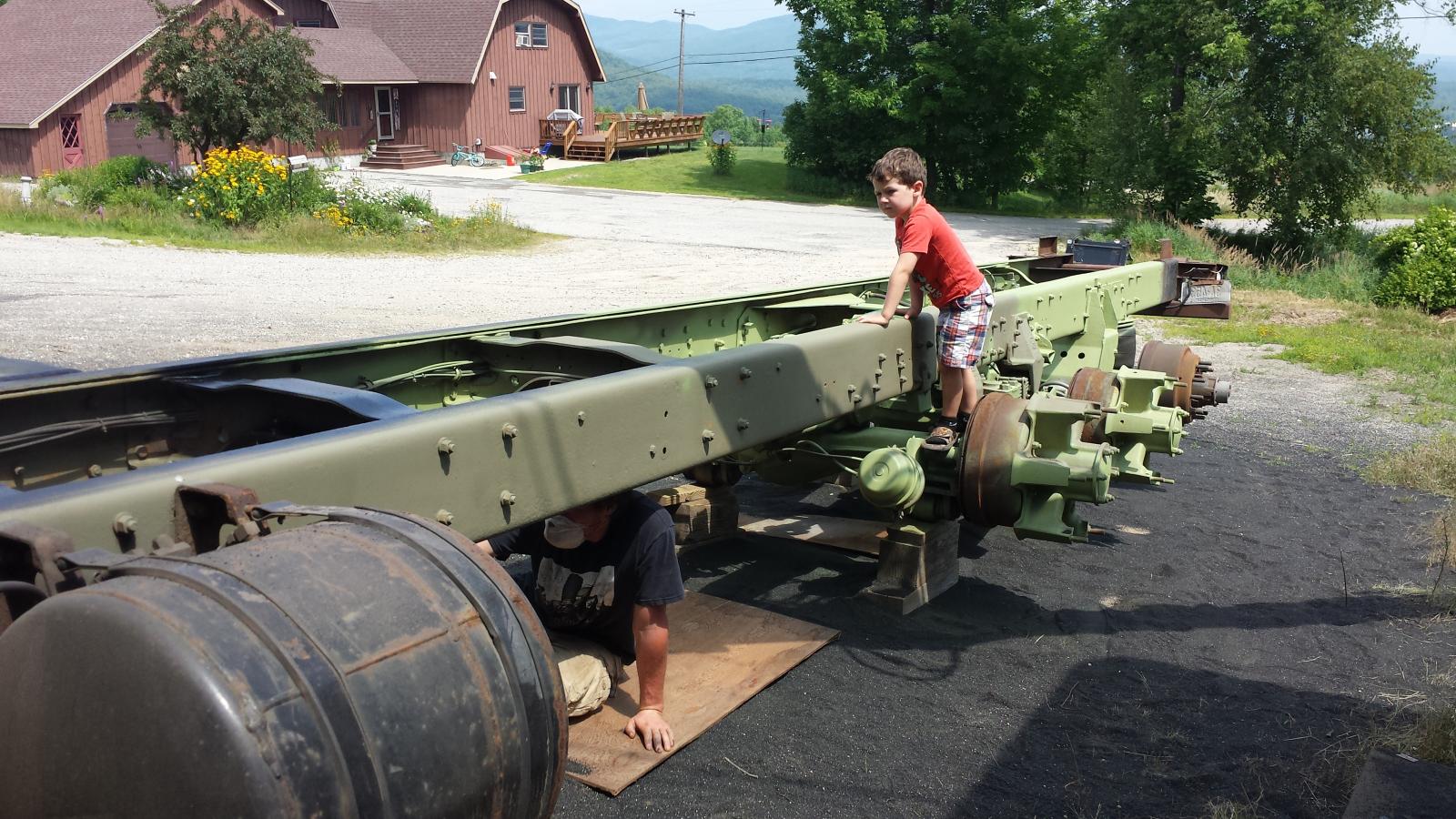

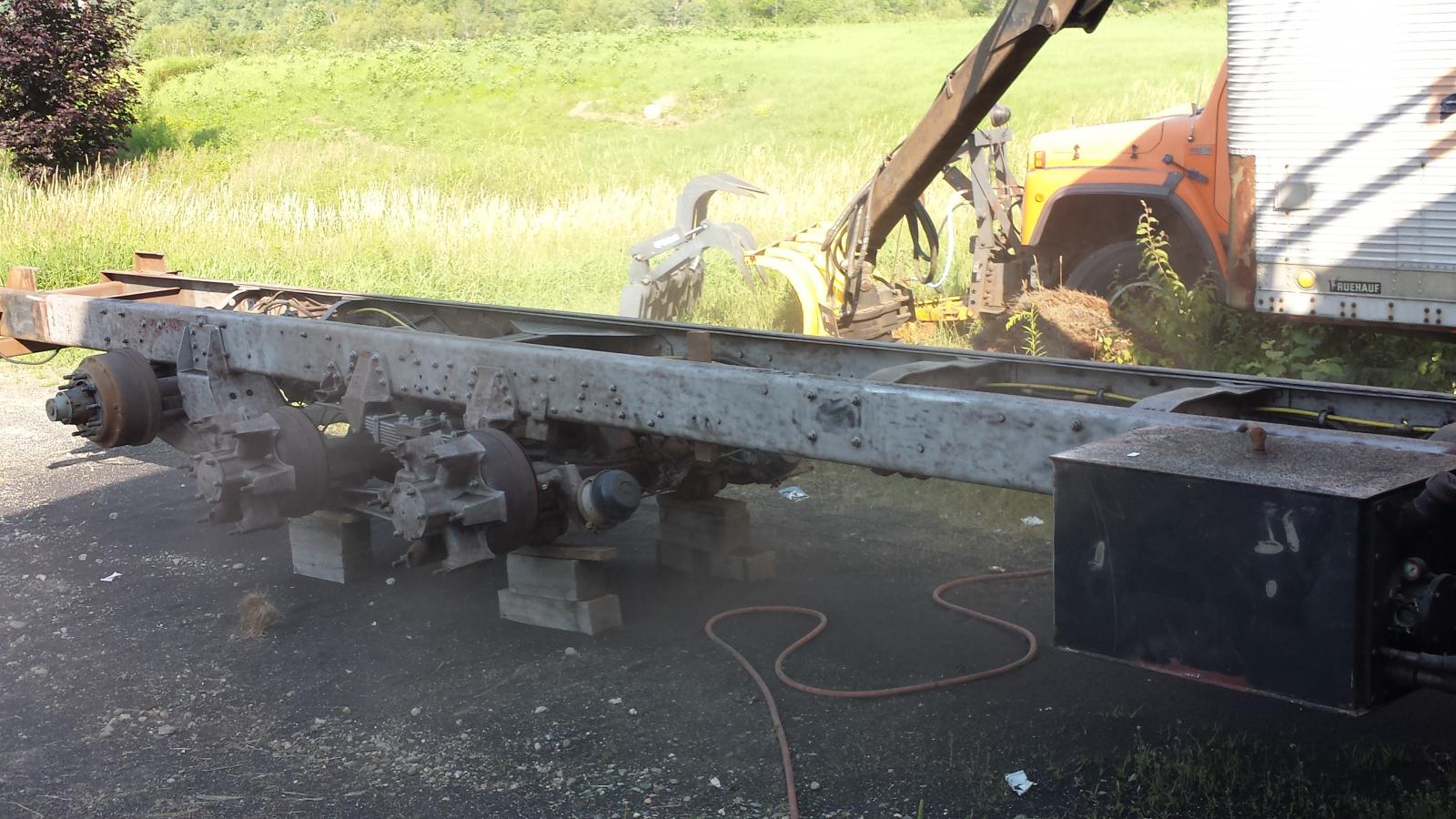

Back to sandblasting frame rails
Black Beauty use to be 3 bucks a bag, then 7 bucks, then 13 now I think its around 20 by us last big job I did, I had someone else do the blasting...

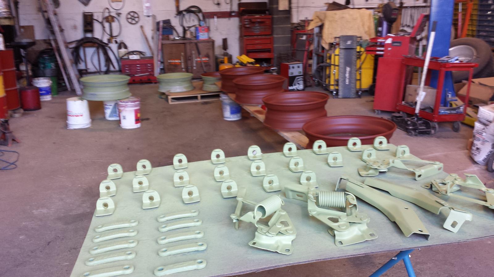

Just picked up 63 bags to finish this and do a lowbed, 7.99 a bag then got 15% off.
We used 1mm kiln dried sand on mine to blast away all the rust, was cheaper to get and worked pretty well, $300 for 3000lbs. Yours looks nice and neat, your frame looks pretty clean after you blasted it, nice work.

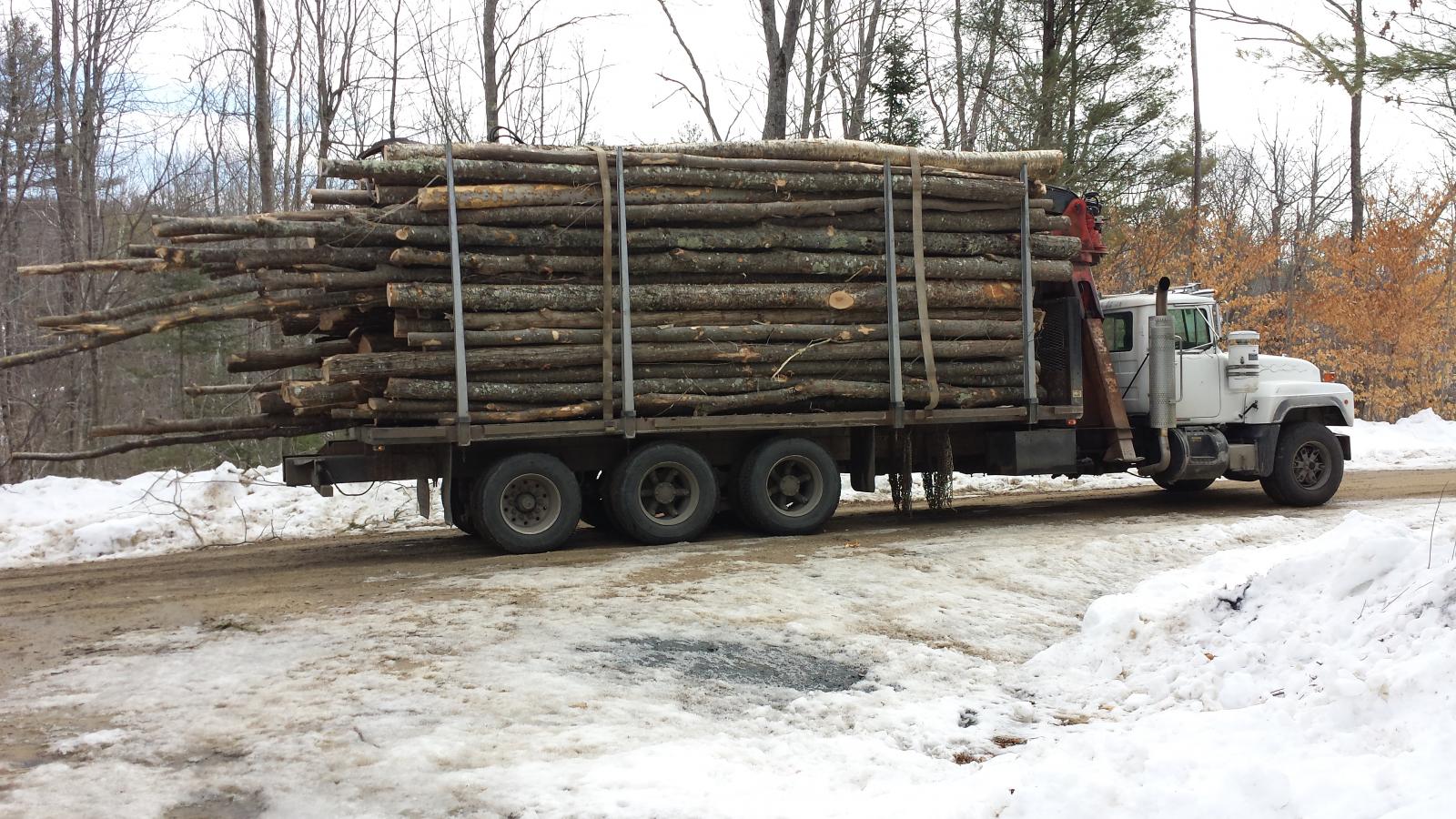

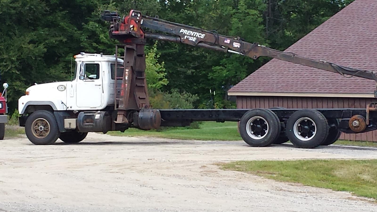

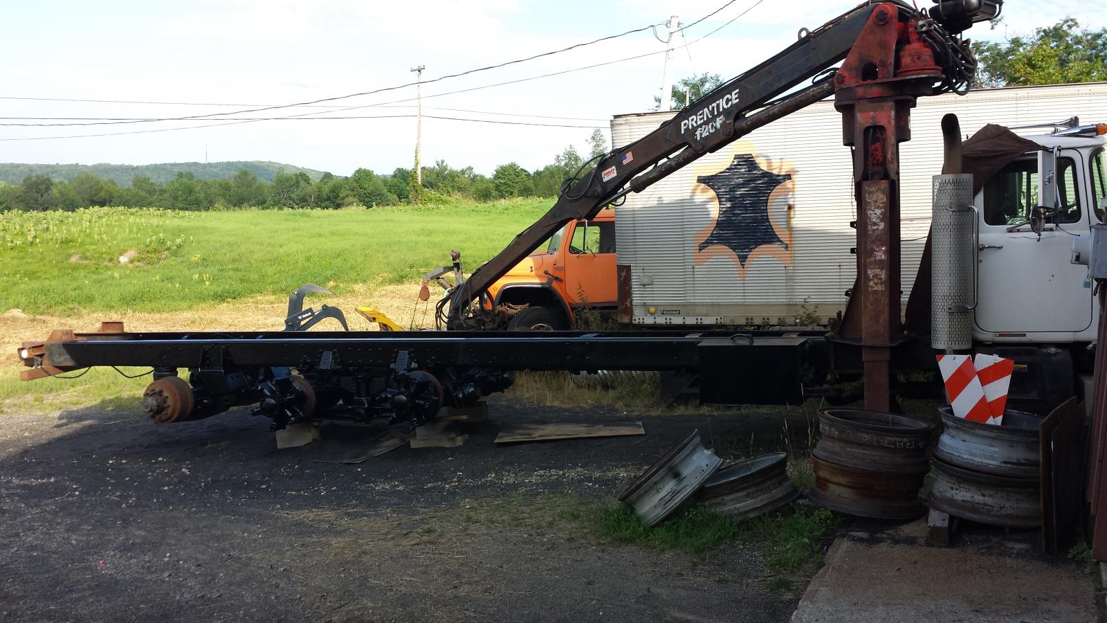

Looks good. I always wondered why someone would spec a truck with mack rears and hendrickson suspension when they could have camelback? Any insight?
Second Mack I have set up this way,cheaper to maintain,but most importantly they are much more stable when loaded. Waited quite a while to find this long wheelbase Mack set up this way. 282" wheelbase,Hendrickson spring,400 Mack with a 8LL transmission.post-15158-0-41733600-1406424290_thumb.j
