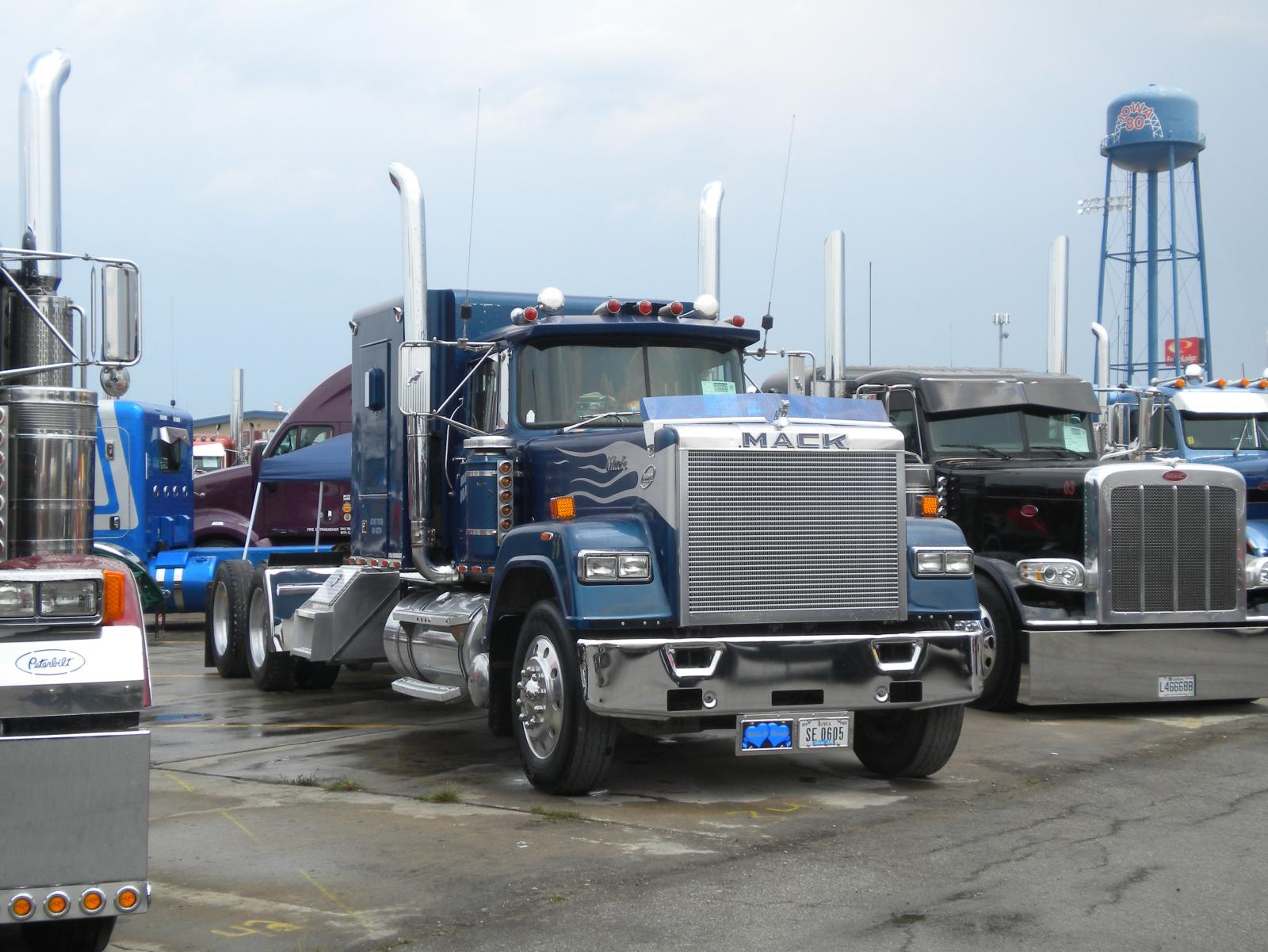

post-61-0-93136800-1342411736_thumb.jpg3rd place 1986 & older working truck conventional bobtail.Evidently the judges liked ol' Super Mutt's new look.What do you guys think?
Mike i think it looks great without the wing,i checked out your new grille, whoever did the paint did a good job matching the paint. Ron
