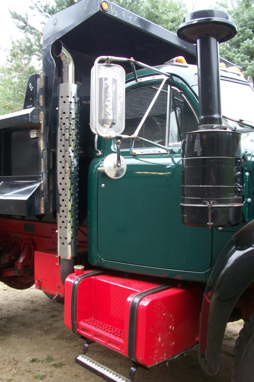

Like this-and I too would like to find a chrome one-at least the bonnet-at a reasonable price. Kind of hurts to pay 200 bucks for something made in china.

Get a piece of 4" exaust tube with an expanded end a cut to lenght. Ron

Good thought for the stack-I think the base is flared-I'll check out-In the back of my mind I think the tube is 4.5" I took the measurements a while back and e-mailed to a chrome shop in Syracuse-guy came back at...." $485 to start"!

I seen one made from aluminum that was a series of bands at the bottom. The base tube was 4.5" but the hole in the air cleaner was larger. The last two inches of the tube were built up from aluminum "collars" which were pieces of aluminum tube with an internal diameter fitting the external diameter of each collar. Then the assembly was welded together nicely and this is what showed. It looked like it was home made but nicely done. A tree collision destroyed it so it was thrown away.
Might be an option for what you want to do if you can't have the tube "swaged" larger on the end.

I got mine from Matt Pfahl, was on Ebay when I saw it. Came with chrome stack and new top. I liked my big top better, as the one that came with it was the small rounded version. I'm thinking it was $150? Something like that. I wanted the tall version and it's not a std exhaust size.
No braces on mine and it's not a problem for the last 5-6 yrs.
Without the riser, if the passenger wing window was open too far it would bang into the lid when you opened the door fully. The lid had a good dent in it from years of that happening.

your bonnet is the correct one the newer ones are like mine. Both of mine that i wanted to used were rotted and to far gone to mess with.
220, F'Train--Both of yours look good. I would say mine is the correct bonnet-no rot, its solid but this old dog was a dump truck since day one and my guess is the bonnet caught its share of trees off road as it has a few dents in it. The flare at the bottom is 4.5" and the stub in the air cleaner is about a 4.25+/- Not the easiest thing to matchup.
