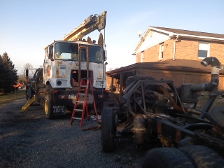

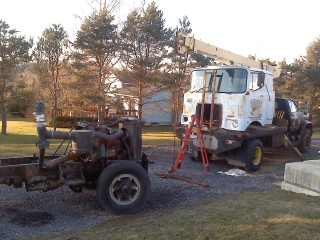

Things have changed for me recently and I have too many trucks in the yard so I decided to donate an F model cab to a friend's Brockway project. I don't see me getting to this project anytime soon, so I am glad to let it go to someone who needs it more than me.
The good news for you guys is that I now have a good running 237/ 5- speed for sale as I will be parting out this chassis. I will post in the for sale forum with details.
I was going to build this truck into a tandem road tractor but my RW now fills that need, and has been taking most of my time and money recently.

Is the chassis a tandem? What ratio? which steer axle?
Thanks
The F785 chassis is a single axle 128" wheelbase. Rear axle 4.00 ratio with a big hole in the carrier after it siezed from lack of oil.
Front axle is FA 534 with oil hubs and 20" spokes. I also have for sale an FA535 with grease hubs and 20" spokes.
Gregg
