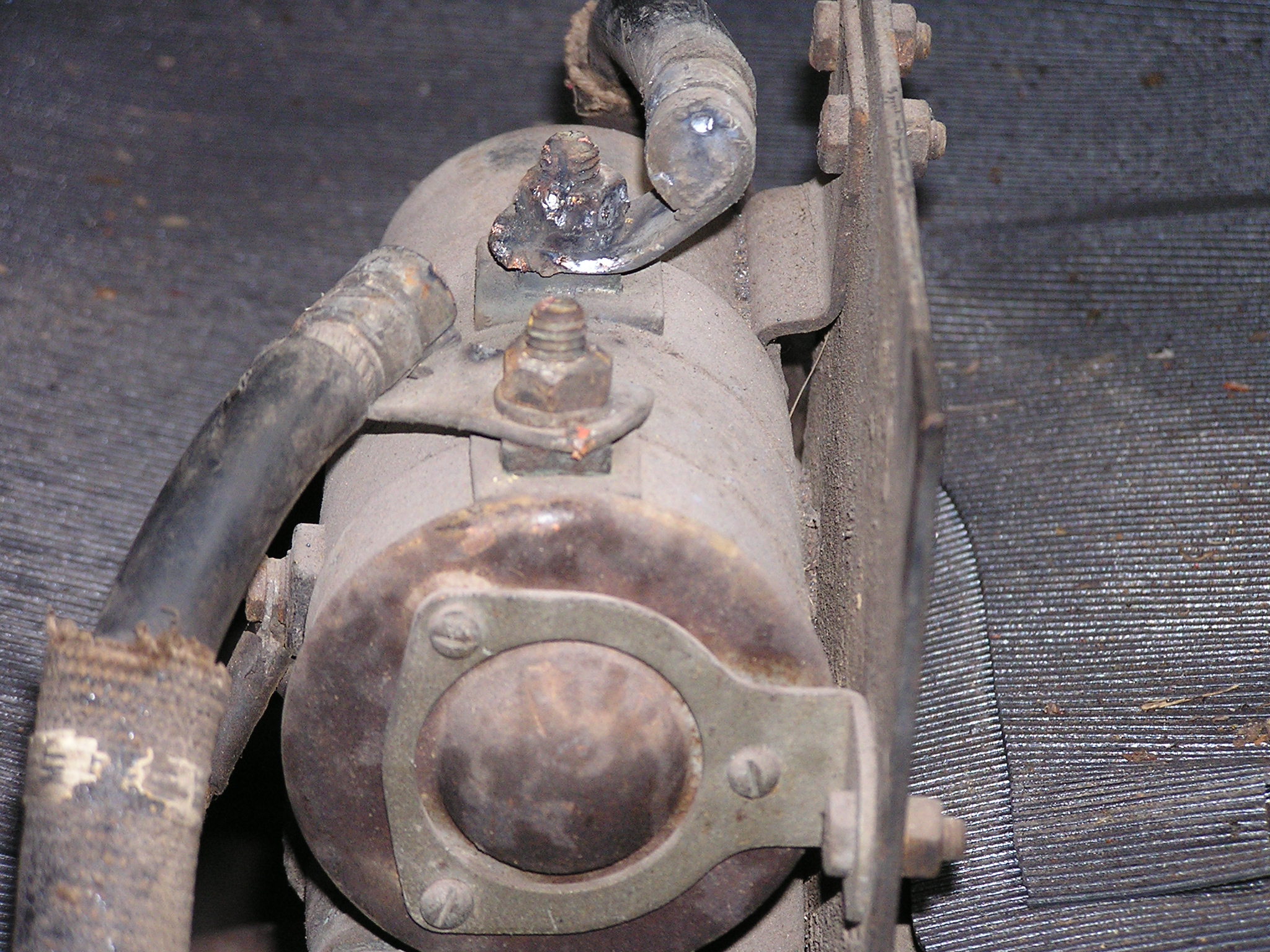

I'm assuming the switch is easy to spot. Its not hidden? I'm looking right now and don't see anything.
Just as 220 cummins said. It is inside of a rectangle box, which have hood latches, one in front and one in back of the box. If you cannot find it then trace your battery cables toward under the cab. Some switch covers are missing on trucks thru the years. Hope this picture helps.

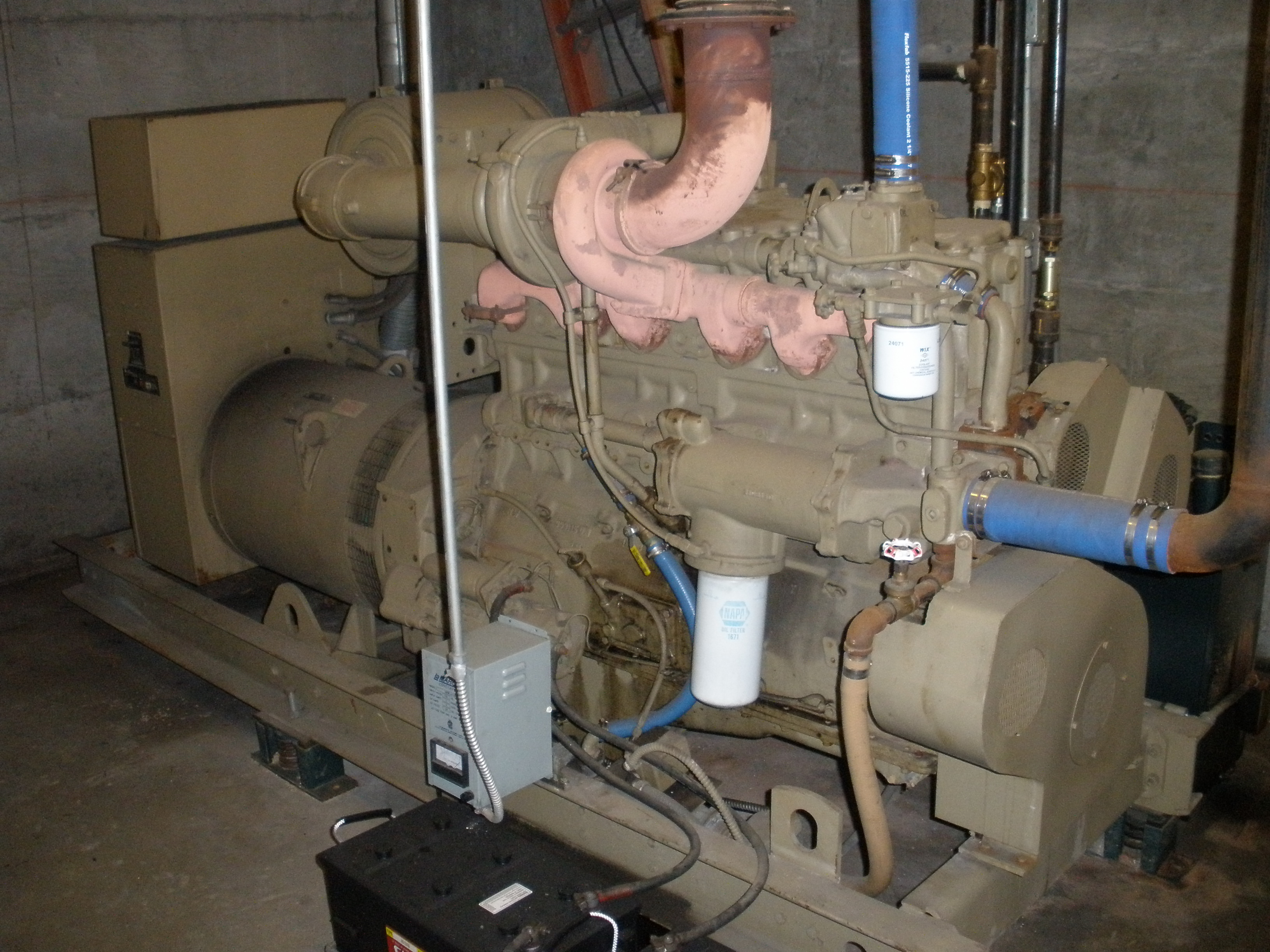

Yes Rob, our Chiller runs off the big power of 480 volts. It sure can get your attention when it comes on. I downloaded pictures of the chiller and air handlers at the building for ya 2 years ago, but never until now had a reason to show you. Oh yea and also the Cummins 50KW Generator with Turbo....Made In Brazil.

Here is that picture of the Cummins generator at work.

M-11 series Cummins. A pretty good and stable platform to operate with. Must be an older set as since the acquisition by Cummins of D.W. Onan company, all gensets have been painted Onan green.

This unit was installed in the basement in 1985, so it may be a 1984 Cummins. The building was constructed in January 1985 and moved office furniture in by March 1985. I was running it each wednesday for several years but since the economy has gone sour ya know the answer. It has an hour meter but I have forgotten what it is. I do know, it has very little hours on it. I had the underground tank filled last year and they sent out one of their genious workers and he over ran the tank and it caused an overflow inside of the building and fuel was running down the hall. Man did I have a mess to clean up. Ya have to stand and watch every move someone makes today. I probably will be gone before it needs filling again. :wacko:

Have an oil distributor come by and dump an algacide into the fuel if stored that long. Algae grows in diesel fuel that is not consumed and plugs filters.
I'm thinking Cummins acquired Onan in 1987 or so.
