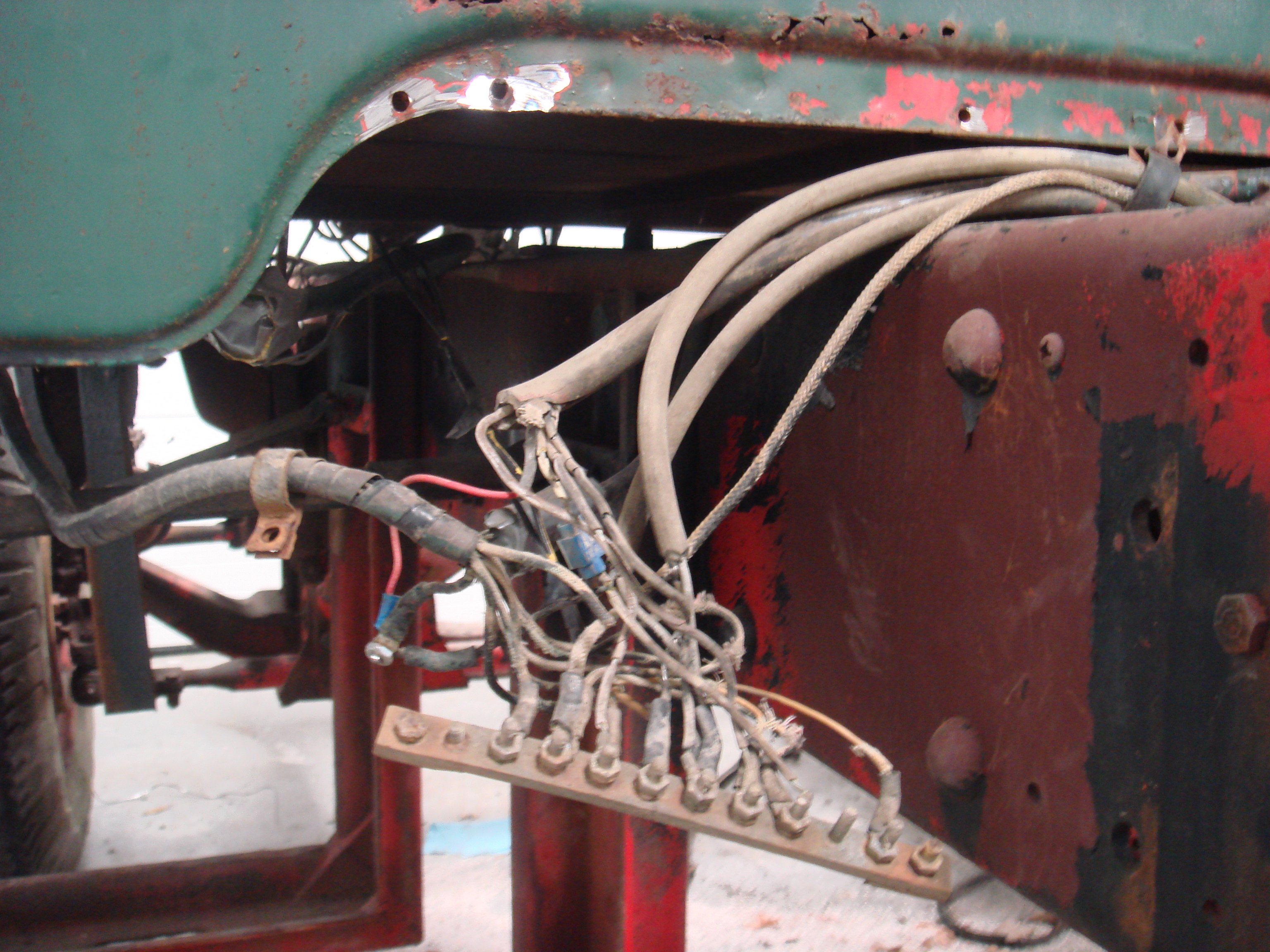

Can someone post a picture of thiers? Looks like mine is MIA...I do appreciate the time it must have taken to pull those wires through a green garden hose! :pat:
I will purchase an equivelent juntion block and rewire correctly...

my 1961 was bolted under cab on the bottom lip.
I can see your brake light switch! Havent found mine yet! :lol:
My original stop light switch is on the inside of the left rail, around the cab mount cross member. I took it apart, cleaned and lubed it....still works many years later. The one you see in the photo wasn't from the factory. John
