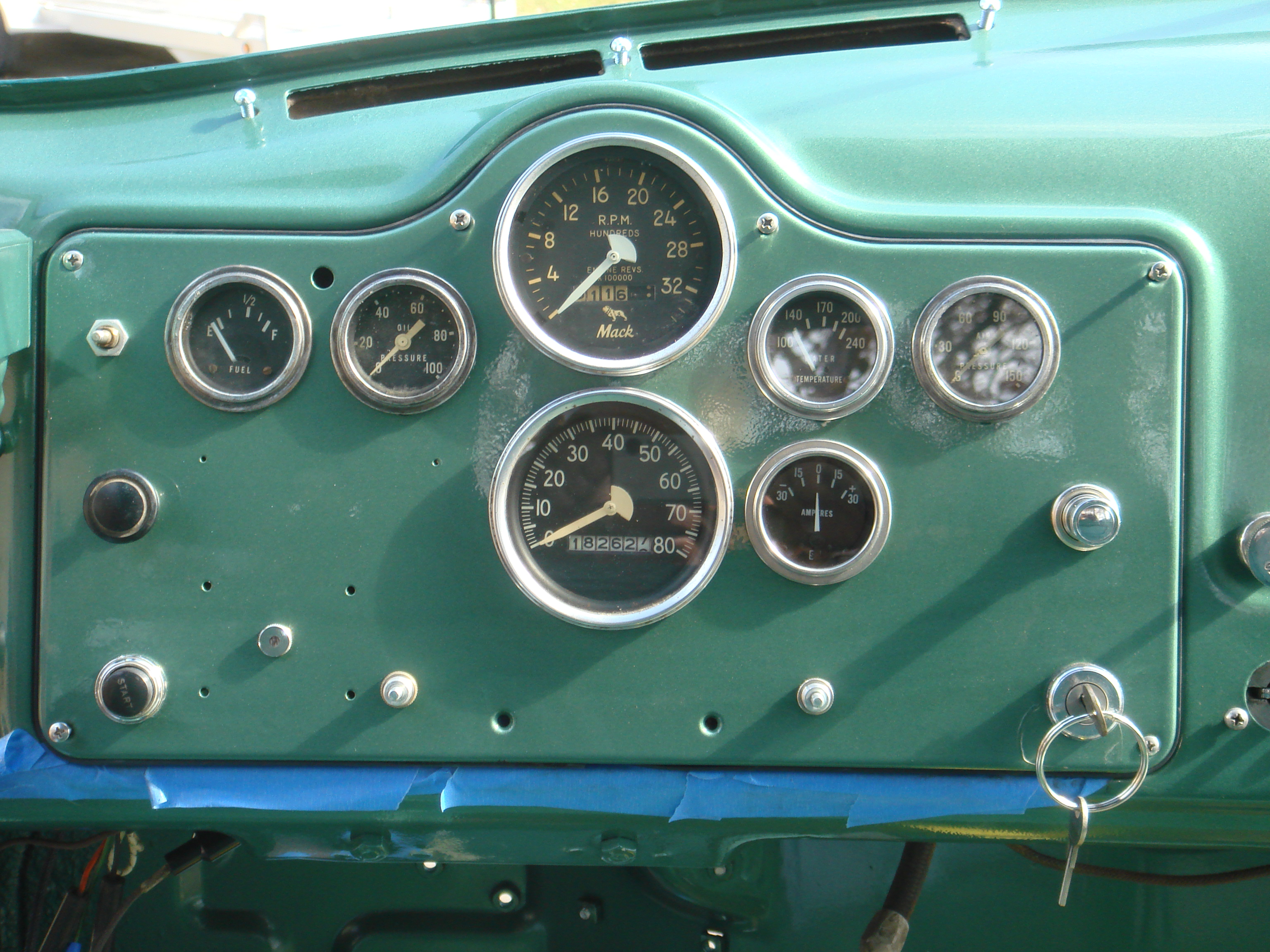

i wanted to keep my dash as original as i could so i cleaned all the rust off mine with steel wool and a dremel tool and then taped them up and cleared them to keep them from rusting again. i was happy with the outcome. it depends what look you want out of your dash. i liked the old gauges wihtout the "sw" label on them.

I just got my gauges back in. i wanted to keep my old gauges. i like the original look. mine looked like yours when i started. the amp gauge is new. rest are original.
(and yes i know the hi beam indicator is in the wrong hole.)
unless you are going to rechrome, you can shine up a gauge and see what you think of it.

the bezel on my amp gauge looked like yours. i bought a new amp gauge from watts that matches the step bezel of the originals.
