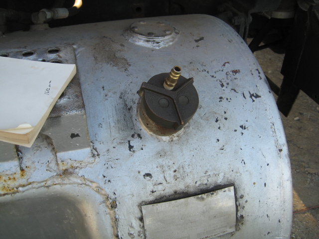

Here is what I've come up with so I can do the job all by myself. Regulate the pressure down to about 50 psi at the gauge, and have never had problems. The engines usually start right up if they have a fuel supply. After the truck is running, I then install the regular fuel cap.

Ya see, that cap don't go on unless fuel proceeds it. Good way to remember to. I've actually made three of those caps for the different styles on the V8 trucks; You know, "Just in case".
