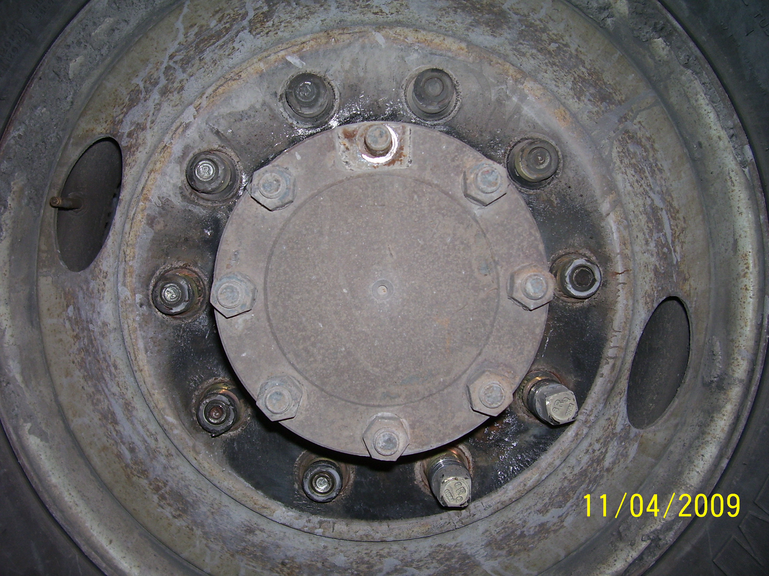

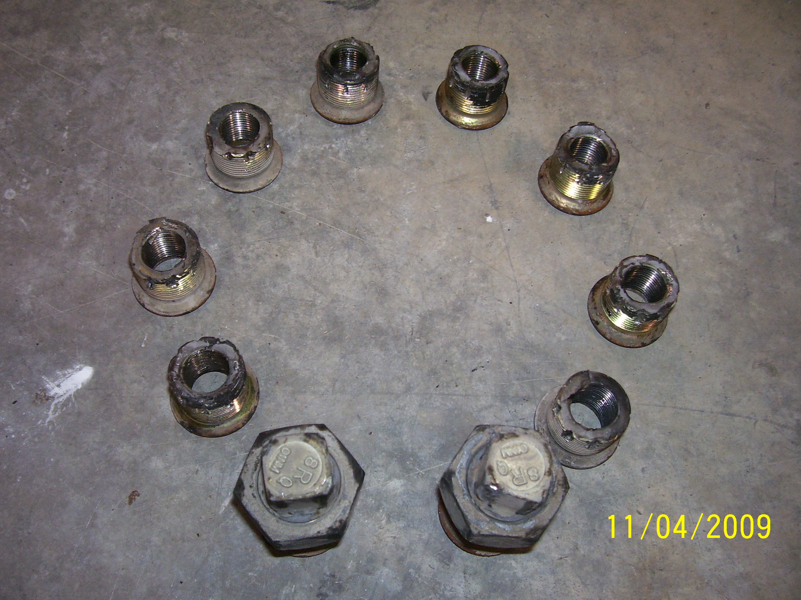

I've used a broken stud to try to see how deep into the barrel nuts the stud goes, and I don't think there's enough room for longer studs...they'd bottom out before the inner wheel was held securely.
The truck was bought with the wrong barrel nuts on it...which I'm assuming wrecked the flange on the rims, so that even when I figured out they were the wrong barrel nuts and put the correct ones on, the inner wheels still weren't held securely enough. As the rim flanges got worse, the vibration caused the barrel nuts to break with greater frequency...and started wearing the inside edge of the inner tire quickly, too.
When I had the tire shop actually LOOK at the rims for me, the condition of the rim was very closely correlated to the wear pattern of the tire....the worse the rim, the worse the tire.
4 new (reconditioned) inner wheels, and so far no further problems. Barrel nuts are all intact, and the tire wear problem has subsided. I'm HOPING the problem is "fixed". :wacko:
