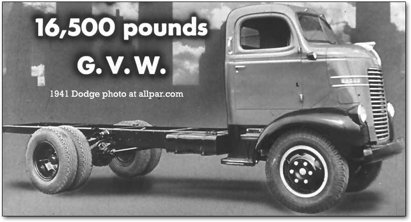

  7. Olivetroad: Dodge has a vacumm pump for operating brakes, heater vents and such. Packer

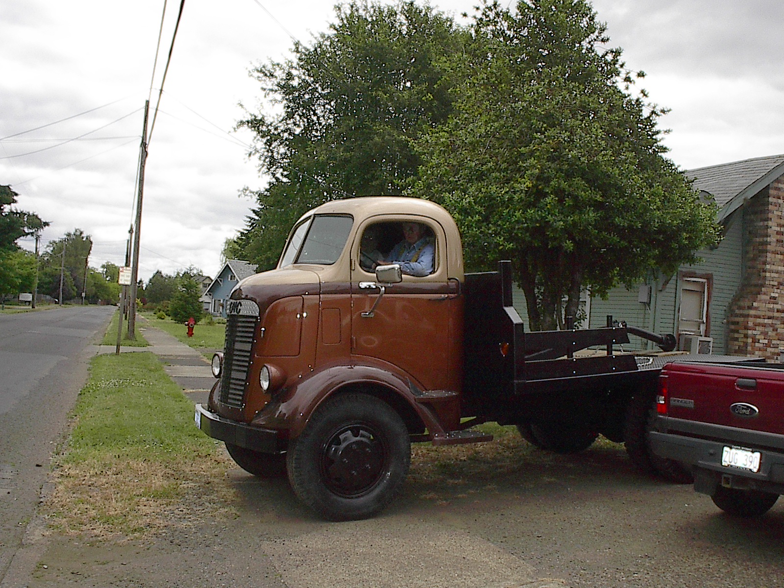

  24. Found this on the net. Might be I've found another one!! Packer
