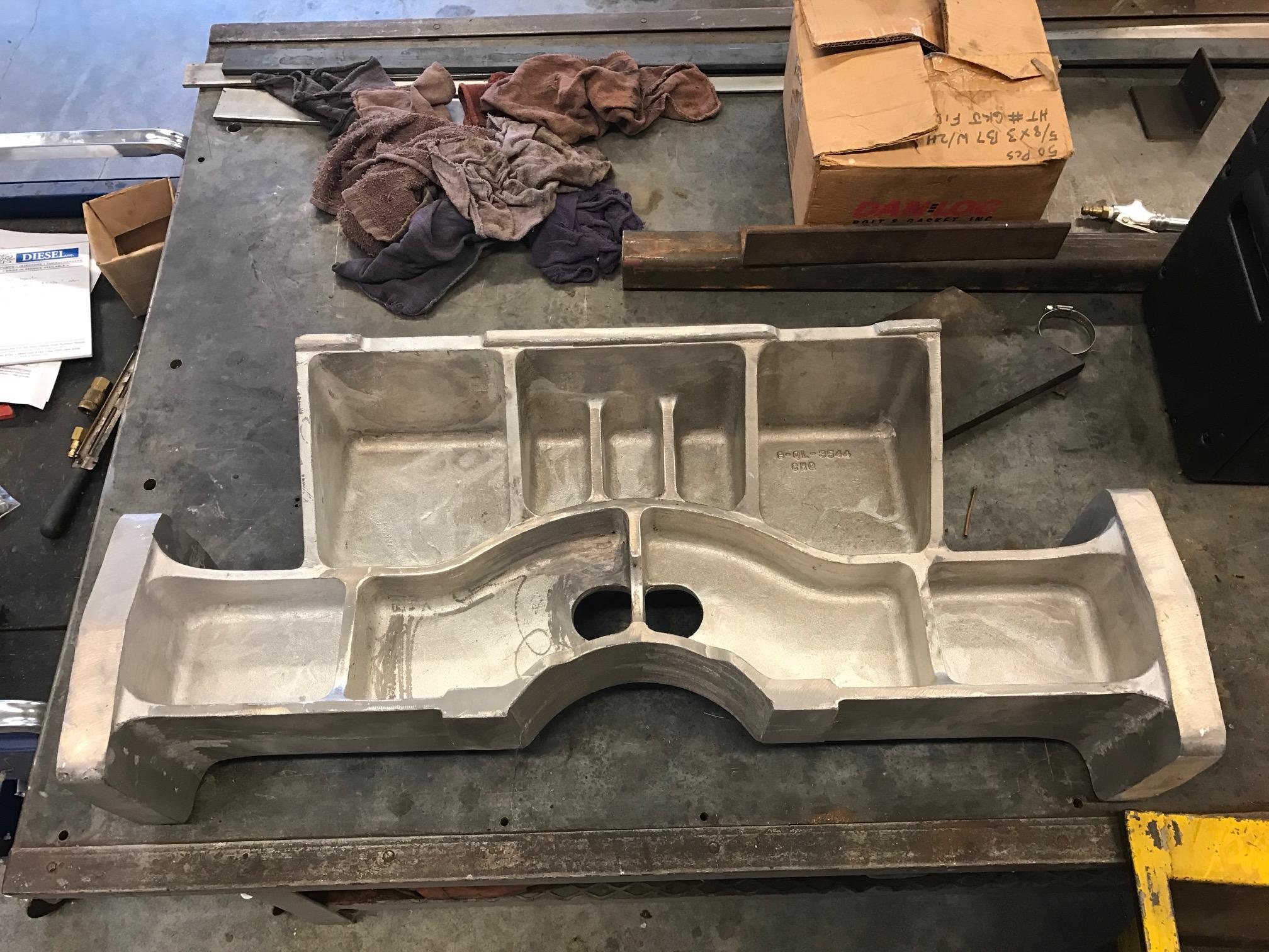

LTL Trunnion cracked
mackaholic replied to Macman's topic in Antique and Classic Mack Trucks General Discussion
Its a pretty detailed process. I managed to borrow a very good original cab crossmember from a friend who agreed to take one of the replicas in exchange. The original then went to a pattern maker familiar with aluminum casting. Aluminum shrinks about 5% when it cools after pouring so the original had to be built up in most areas so the final dimensions would be close to original. After that was finished, a follow block was built that the crossmember fit into. It defines where the parting line is(roughly the mid point of the crossmember side to side and vertically when it's in the truck). These two pieces allow the sand mold to be created. The original and the follow block then go to the foundry where the sand mold is made. The follow block and the crossmember are place in a metal frame and casting sand is packed tightly inside the frame around the parts. The metal frame gets flipped over and the follow block gets removed. Another frame goes on top of the first and it gets packed with sand. If everything goes well, the two halves are taken apart and the original crossmember is removed. When the two halves are reassembled the void is where the new piece is formed when the molten aluminum is poured in. If your familiar with sand casting this might make sense. If not it probably doesn't. (KInd of a sad side note, when I was in high school, I was taught this process. I doubt it's taught anywhere anymore) The picture above is of the newly cast crossmember after it's been cleaned up. The final width still needs to be machined and the mounting holes drilled in the correct places. This is what I got back from the foundry. I'll get a picture of the original and the follow block posted when I get home. Maybe that will help explain it better. I still have the original crossmember and the follow block. I could be taken to a foundry and another cast fairly easily. If your original isn't too badly broken it might be easier to weld it up. If you're interested in casting one, message me your number and we can talk in person. Good Luck, Brad -
I am guessing both the trunnion mounts and crossmember are aluminum? I took my trunnion mounts to an old school welding shop and had them welded up. They were not impressed with the quality(or lack of) in Mack's castings. I'm hoping they will hold up for truck show type use but I wouldn't want to use them for hauling any weight. As for the cab crossmember, If it's not too badly broken it can also be welded. About 5 years ago I had a couple of new aluminum crossmembers cast. All spoken for now but if you needed one I can check into what it would cost in todays dollars. Was about $1100/copy the last time. I didn't have an aluminum crossmember for my LTL so repair wasn't an option. -
