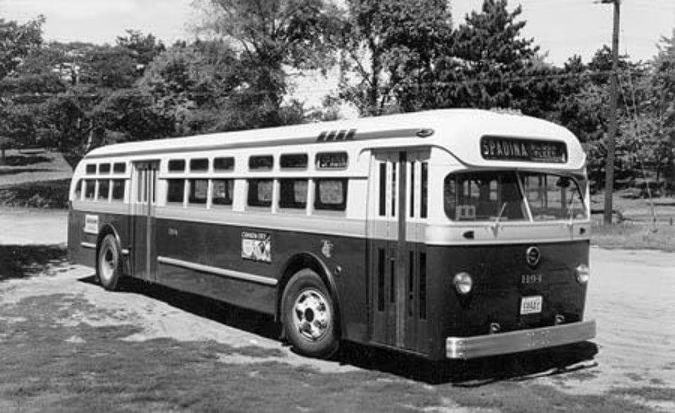

	Mack Buses were quite common here in Canada especially in Toronto. The Toronto Transit Commission (Wrenching at the TTC is my full time job) was a big user of Mack over the years. The last Macks in the fleet lasted until the late 60's. Just so Happens that Alfred Pelletier former Head of Mack was a Mechanic at the TTC for years before he started working for Mack Trucks.
