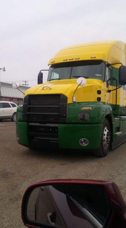

Be careful with what you see on the hood and headlight design. I see some paneling on the fenders that could be add on to screw us up from the final product. obviously the grill is blacked out and lacking a name to hide it as much as possible. I remember the late 80's test CH that ran for Atomic transport up here in Canada looked slightly different then the final product but really close.
I was told 6 months ago by a Mack bigwig that crossed over to the Volvo office that the cab would remain the same size as requested by alot of big customers. that and I'm sure Volvo would save some money doing so. he also mentioned the interior ceiling would be now open like a volvo with a new bunk. guess he wasn't far off. the hood looks like it may have some add on pieces above the fenders to throw us off a bit. we will have to wait and see the final product.
Looks more like CH fenders now.
Holes are there. they are trying to hide who's truck it is. cab gives it away.
So......same cab shell, new bunk, new hood, new fairings........wish it was going to be priced right and break down as much as a Mack from the 80'S OR 90'S.....one could only wish.
