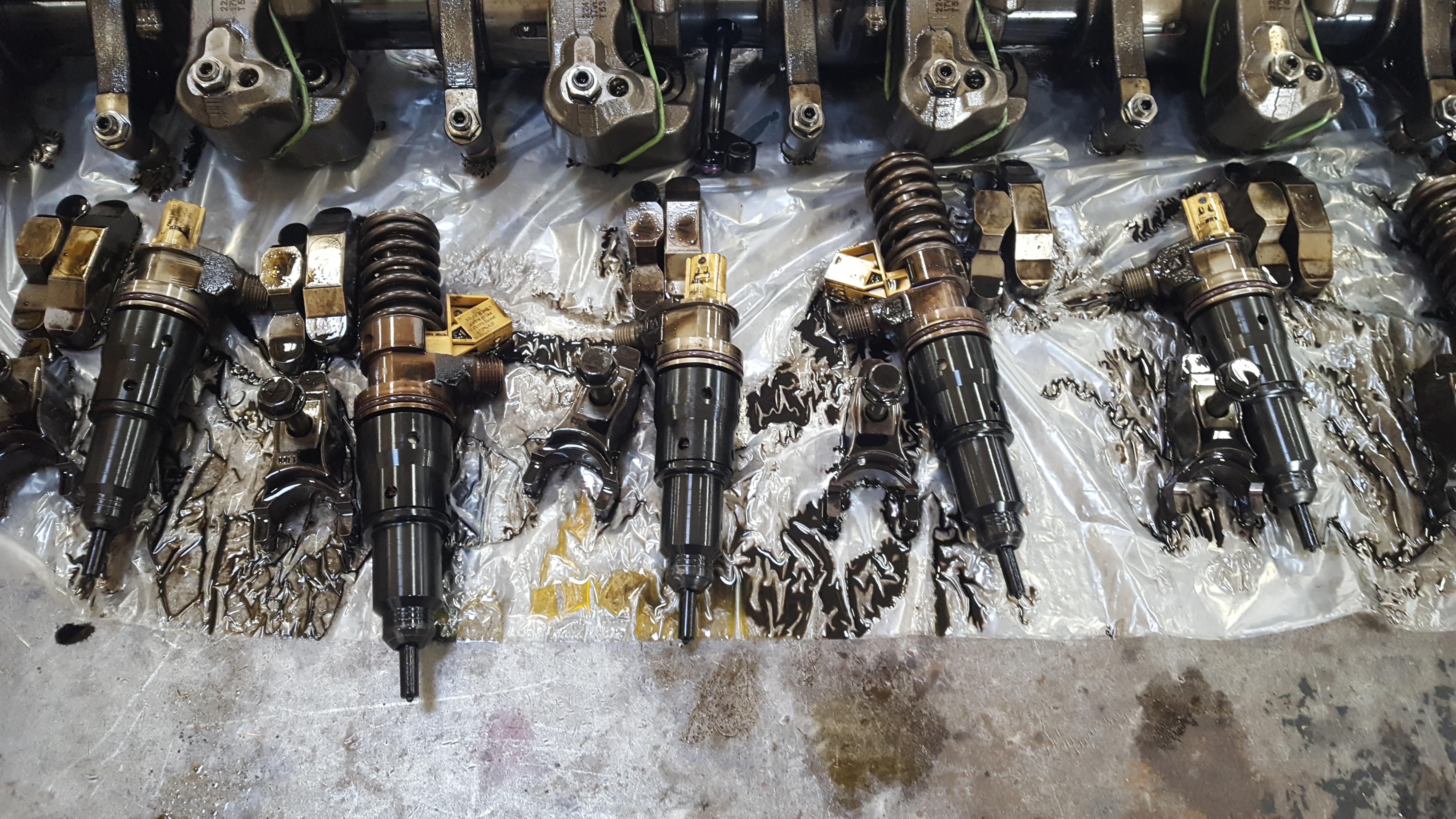

	That's an easy one....in comparison to the Bosch fuel system used by Cummins, this Delphi "wanna be" common rail I think will be a bit of a let down. It's more difficult to work on, more difficult to diagnose, full of issues that came with the last engine design and still more expensive to repair in both labor and parts then the Bosch/Cummins common rail. The fact that the plunger injectors are pulling double duty now not only injecting into the cylinder as usual, 3 of them are also responsible for building up rail fuel pressure when not firing into a cylinder shows they are doing double the work...(for those that are scratching their head on this comment Macks YouTube channel has a video that may help on the fuel system) instead of a pump that in some cases has a high and low pressure pump on an external to valve cover pump or a high pressure pump with an electric lift pump feed from the tank. I was hoping this engine was a bridge engine (a band aid fuel system on an old engine before a better design is released) I'm told by Volvo engineer people it's not... Cummins however took a step backwards with the release of the X15's new exhaust after treatment set up. Like the medium duty engines Cummins builds, it's going to be fuel dosing in cylinder only and doing away with the 7th injector after the turbo. It's bad for the cylinders and has wiped out many a ISL and ISB over the years where high idle time is part of the engines duty cycle. I wish these engines would get more simple with every release. Sadly, They are not.
	  Scr replacement on 2018 granitebbigrig replied to Ezee's topic in Modern Mack Truck General Discussion We have replaces a few SCR assemblies on that code as well. E case made the calls on those. Also had one that was an output nox sensor that would be about 75 ppm drift from the other sensor on cool down. Should be 40ppm or less Only seeing this issue on the 2018s so far.
	I'm wondering if like Detroit on the 60series we should start installing a thick o ring between the injector tip body and the injector cup to slow down the combustion gas infiltration to the fuel system.
	Also, keep an eye out for low power/chugging, low fuel pressure or codes for fuel restriction. We have had 2 with a fuel "flapper" check valve in the intake of the primary fuel water seperator filter in the housing that goes for a crap. Apparently if you put a Donaldson primary water separator filter on that was made for the none common rail engines it may cause this valve to be damaged. The common rail engines have no Donaldson primary fuel filter crossover available. The Flapper valve is serviceable separately from the fuel filter housing assembly. We have also had a couple of the new AHI moduals that are part of the fuel filter housing go for a crap already
	Which one?.....lol. We have had several all under 1 year old. A few team driven so between 60,000 And 250,000kms. Nothing has changed. Same issues.
	It's a crappy Delphi , more difficult to diagnose, warmed over Volvo crap wanna-be common rail set up.... Volvo started rolling them out in early 2018 models. Mack was 8 months behind i believe. We see more Volvos then Macks here. Started seeing some issue on a few 6 months in.Got to love the new mile long injector trim/cal codes when replacing them. Don t worry, we are already seeing issues with them in both the injector and injector cup failure departments. Nothing but making things more complicated has been improved with this setup.
