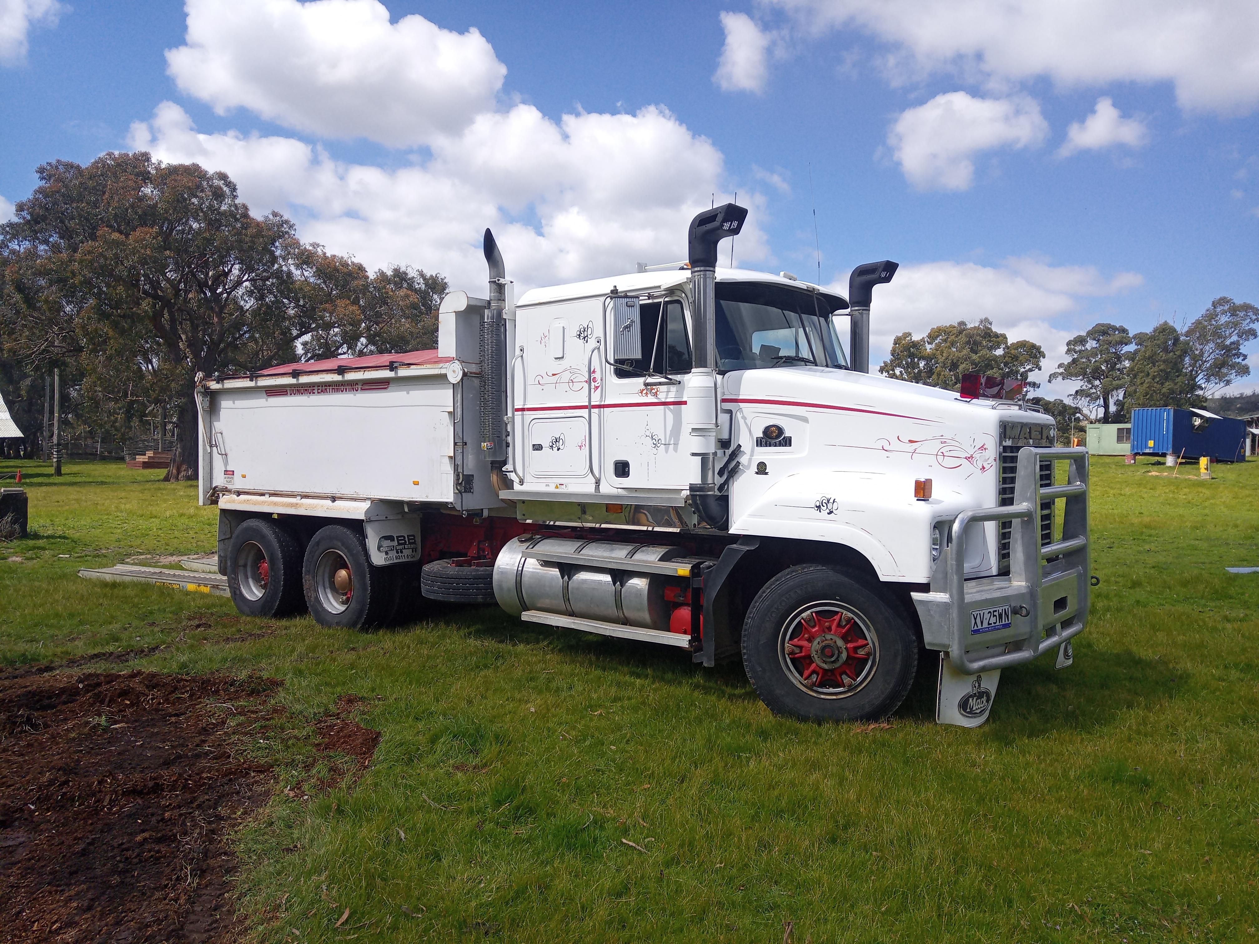

  16. Paul, I hope you knocked on the door and politely asked if you could take a pic of their truck🤣🤣 Broadbent's out of Beaufort Vic have also grown to an impressive, mostly KW fleet, but do run the odd Mack.
