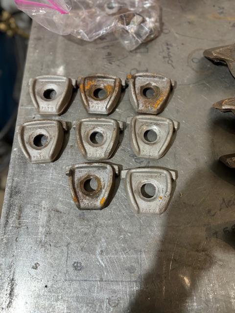

The lack of convex dome really kills the look of these wheels. We had a shop quote correct reproduction but with a tubeless style bead. $2,900 each, that was in 2019. The billets were $2,500 a piece, machining labor was cheap because the owner thought it was a cool project.
