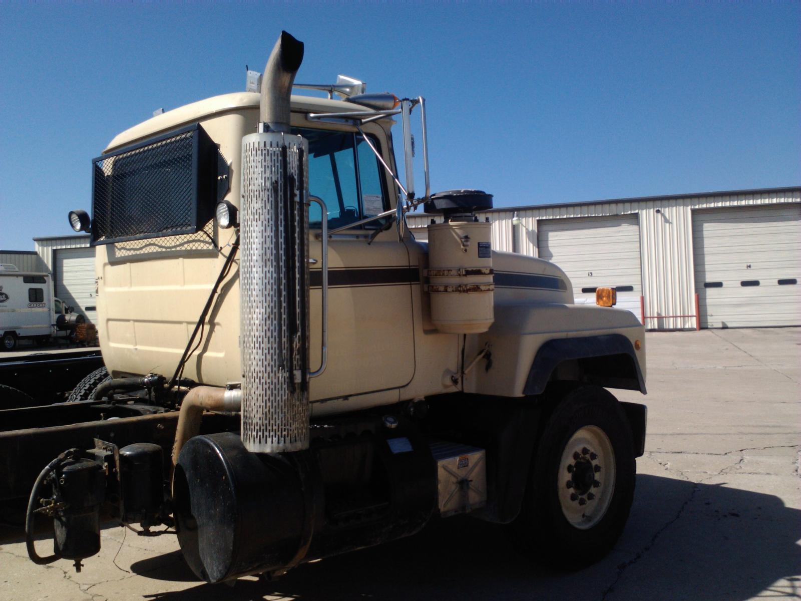

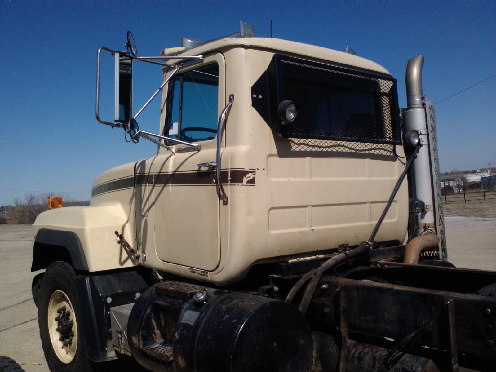

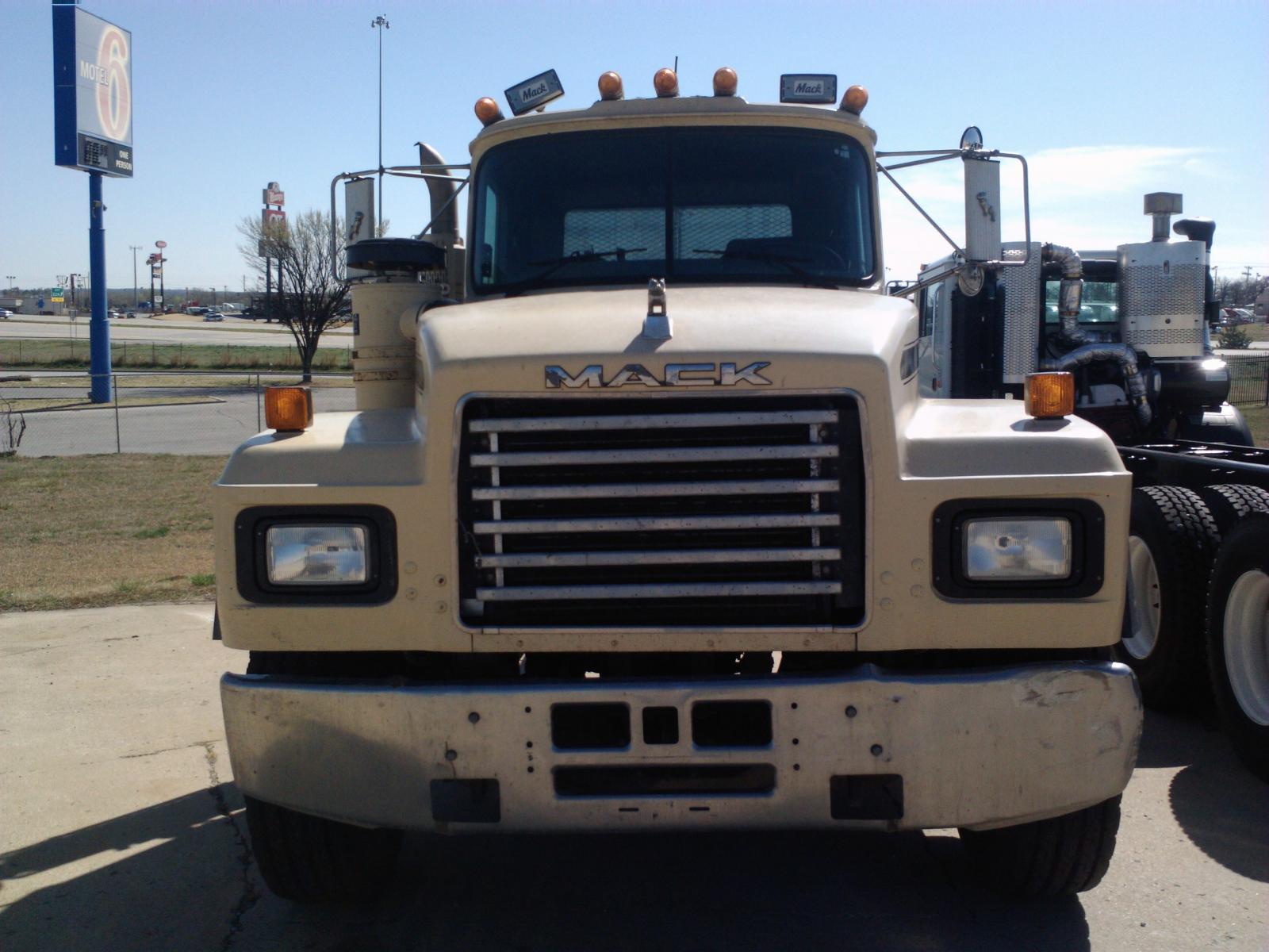

  5. 1996 Mack RD690S-20713----300HP, T-2070 transmission, 18Kfronts/44Krears on camelback springs. AC,PS, radio, (10) 315/80R22.5 tires with budd wheels. 255" wheelbase with double frame. $12,000.00

  9. 1996 MACK RD690S FOR SALE. 255"wb, 300HP, T-2070, 18FRTS, 44REARS ON CAMELBACK, DOUBLE FRAME, 10-315/80R22.5 TIRES WITH BUDD WHEELS. WAS USED IN THE ROLL OFF APPLICATION. F.O.B. TULSA, OKLA. 12,000.00
