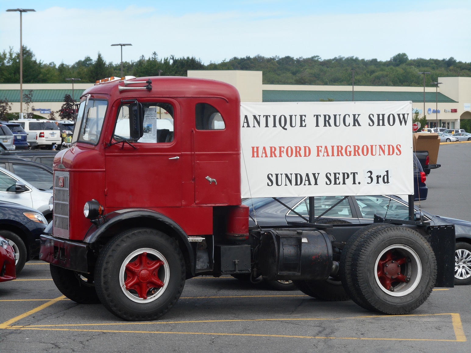

The Endless Mountains Antique Truck Show and Flea Market scheduled for Sept. 5th, 2020 has been cancelled . This would have been our 30th annual show at the Harford Fairgrounds in Harford PA. We appreciate all of the support you have given us in the past. The Northeastern PA Chapter , ATCA hopes that you can join us on labor Day Sunday 2021. Steve
