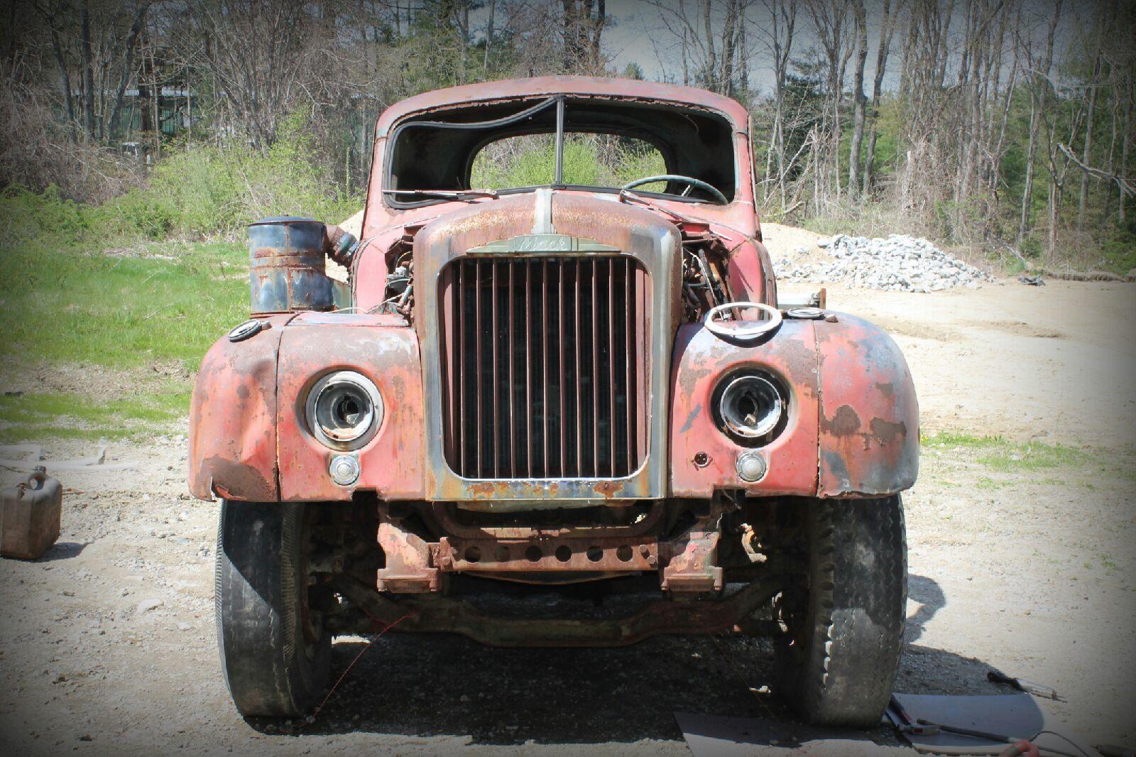

Time to fix up the R600
66dc75 replied to 66dc75's topic in Antique and Classic Mack Trucks General Discussion
Dynamatting well under way. Ordered 2 new airseats and made up new floor brackets for them. Got some pleated black vinyl material coming for back of cab, door panels and firewall. Going to get a new floormat too, might as well at this point.. Amazing how this stuff can snowball, I really just wanted to get the windshield wipers working again. -
Duplicolor Detroit Alpine green engine paint, pretty much a dead on match. -
If they price them like a Freightliner they will sell a ton of them. I think it would look great with one of my sign cranes on one.
Stripped the interior, it was pretty grubby and acne scarred under the floor mat. Scraped, chipped and wire brushed it before a heavy coat of rust reformer. Next stop brush on bedliner on the floor and a full covering with dynamat. Ordered 2 new midback air seats today too. Epoxied up the cracked steering wheel and squirted some paint on it. -
Cleaned up and painted the heater box. I think it's time to paint the interior, dynamat it and get a new airseat before the heater goes back in. It looks like the plastic front got rather warm at one time. -
