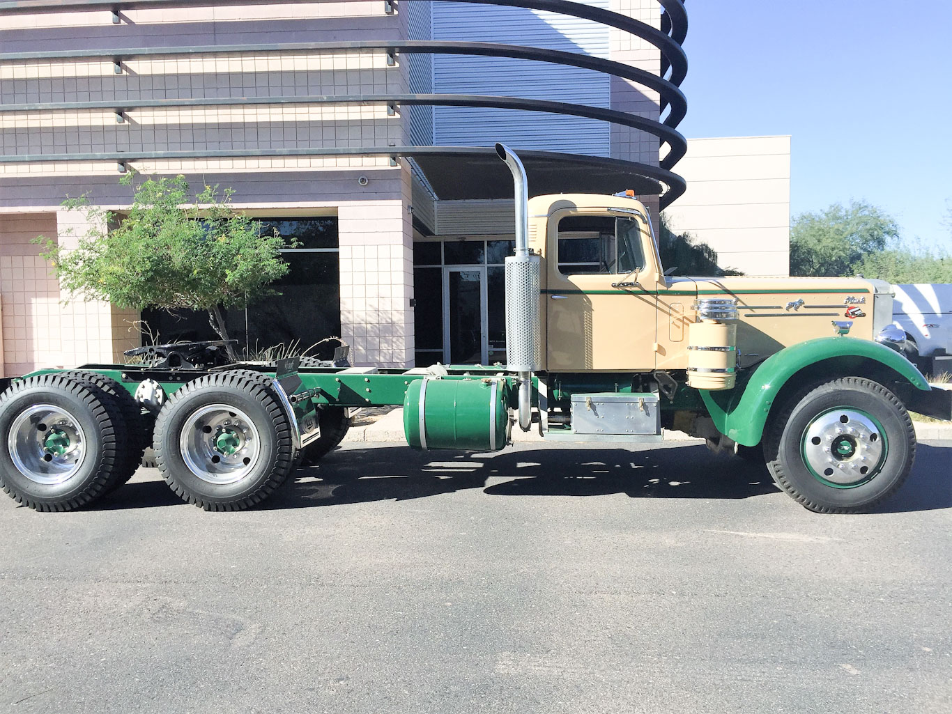

B model Model Smokin a Vett
AZB755V8 replied to AZB755V8's topic in Antique and Classic Mack Trucks General Discussion

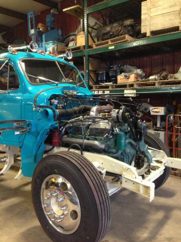

Well Yes, My boys made that Video for me, thought is was Funny but Cool. The fact is it was made from photos of my B model and the wife's now black Vett. The story is when I had the B Model put together from 5 trucks and brought home in 2012 the question was How $$$ much is in that Thing? I was honist and told her as she said get it finished or scrap it 2 years before. She said that she was getting a Vett out if this and has had one or two over the years since. Good deal for me as the Vett was cheaper. -

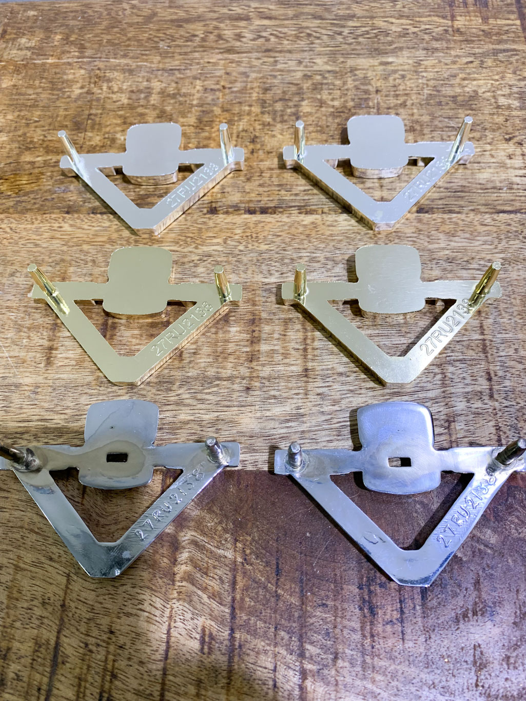

Gold Bulldog
AZB755V8 replied to Brian L Blaylock's topic in Antique and Classic Mack Trucks General Discussion

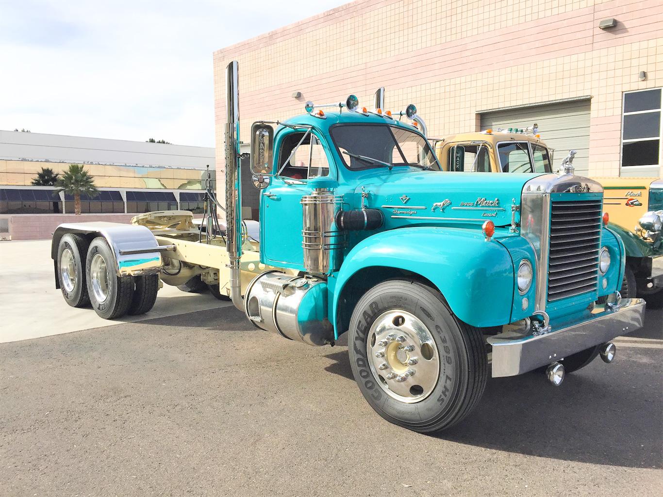

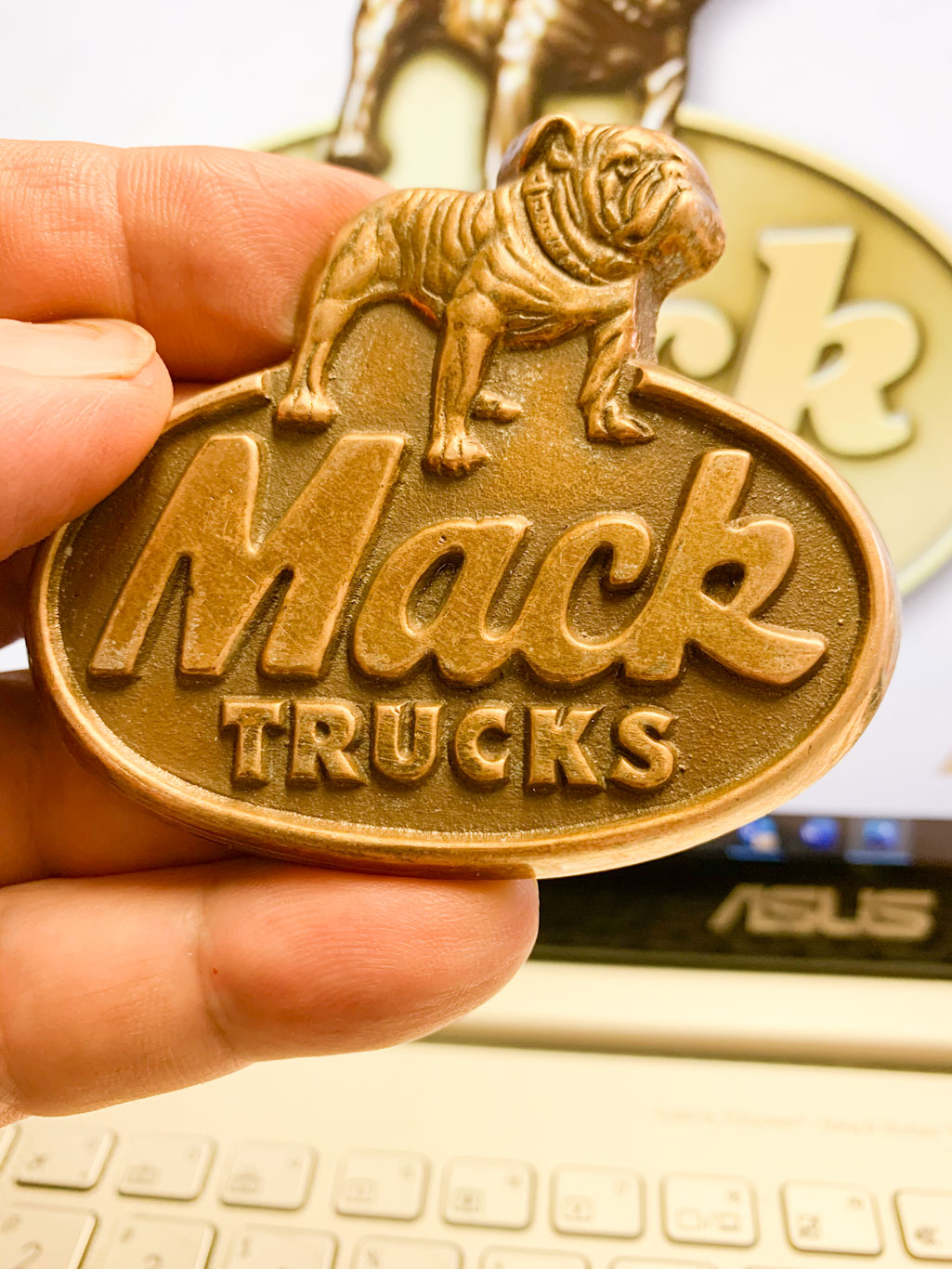

Well I just showed a shiny one, not common but were made for ashtrays and collectibles. It will be on the Superliner when it is restored. A few photos of it and engine, 1200hp, Ya its turned up a bit or two, Rolls coal with the best of them, staight 6" pipes, and what it does best, hauling the load. That is after turning it down a little to haul a trailer at road speed, it was a Pull Truck and did very well in Wisconsin. Full Rockwell Lockers, 18sp, big clutch, steel flywheel, etc. Was going to the Reno show a few years ago with the trailer.- 31 replies

Gold Bulldog
Gold Bulldog

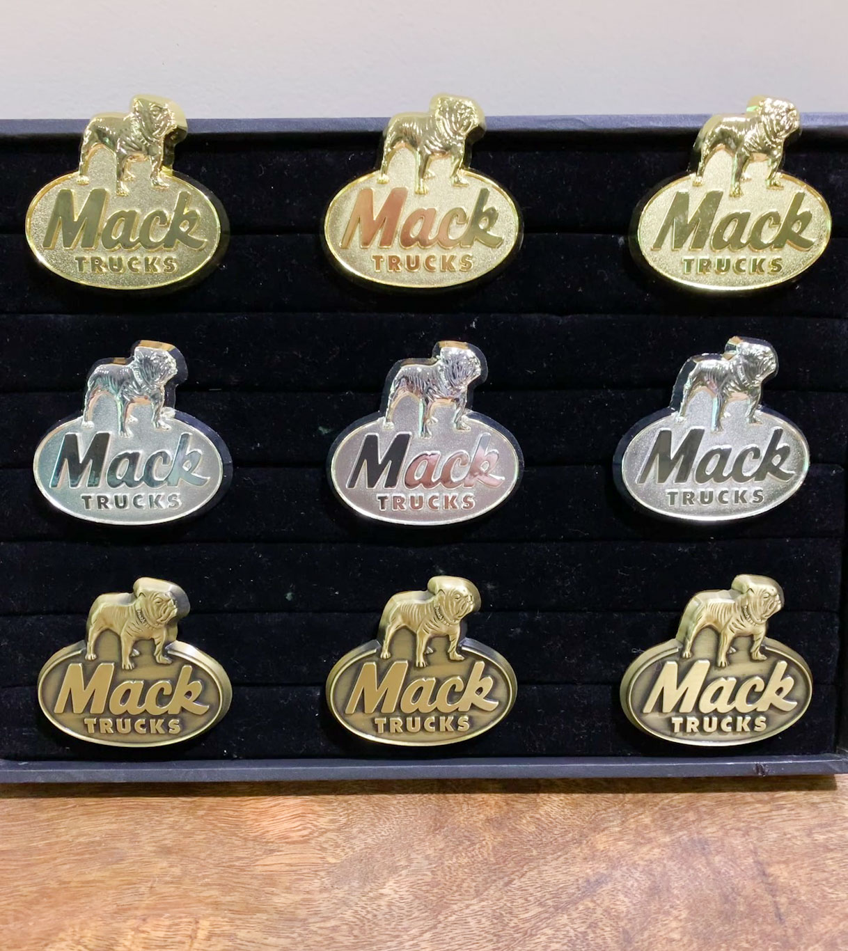

The bulldog was done both ways, Gold Plated and Painted. The best bet is a perfect one is on an ashtray. Both big and small bulldogs are on the trays. If the finish is shinny it is Gold plated. Brushed or matt finish, Painted -
