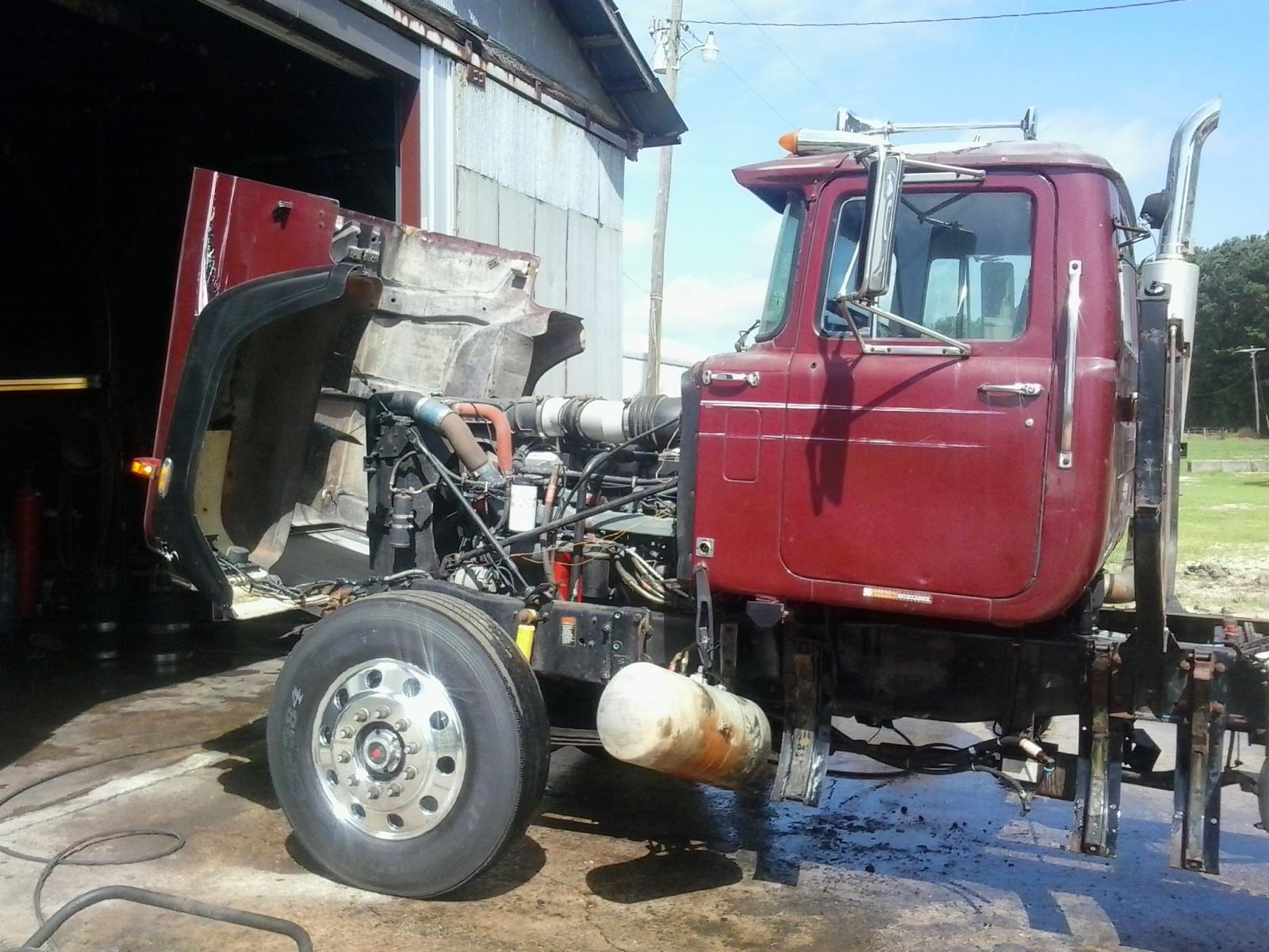

  1. As promised I'm including photos of the final cleaning after the disassembly. The next step it to reassemble everything. New parts include: banjo housings, springs, brackets, wheels, bearings, races, seals, tires, shims, fuel tanks, sending unit, hood rollers, hood bushings, hood spring, hood bracket, battery box bottoms, battery hold downs, all 3 hand valves, straight pipes with chrome elbows...... Many more things to come:) I ordered LED headlights, bumper guide poles, hub covers and aluminum deck plating today.

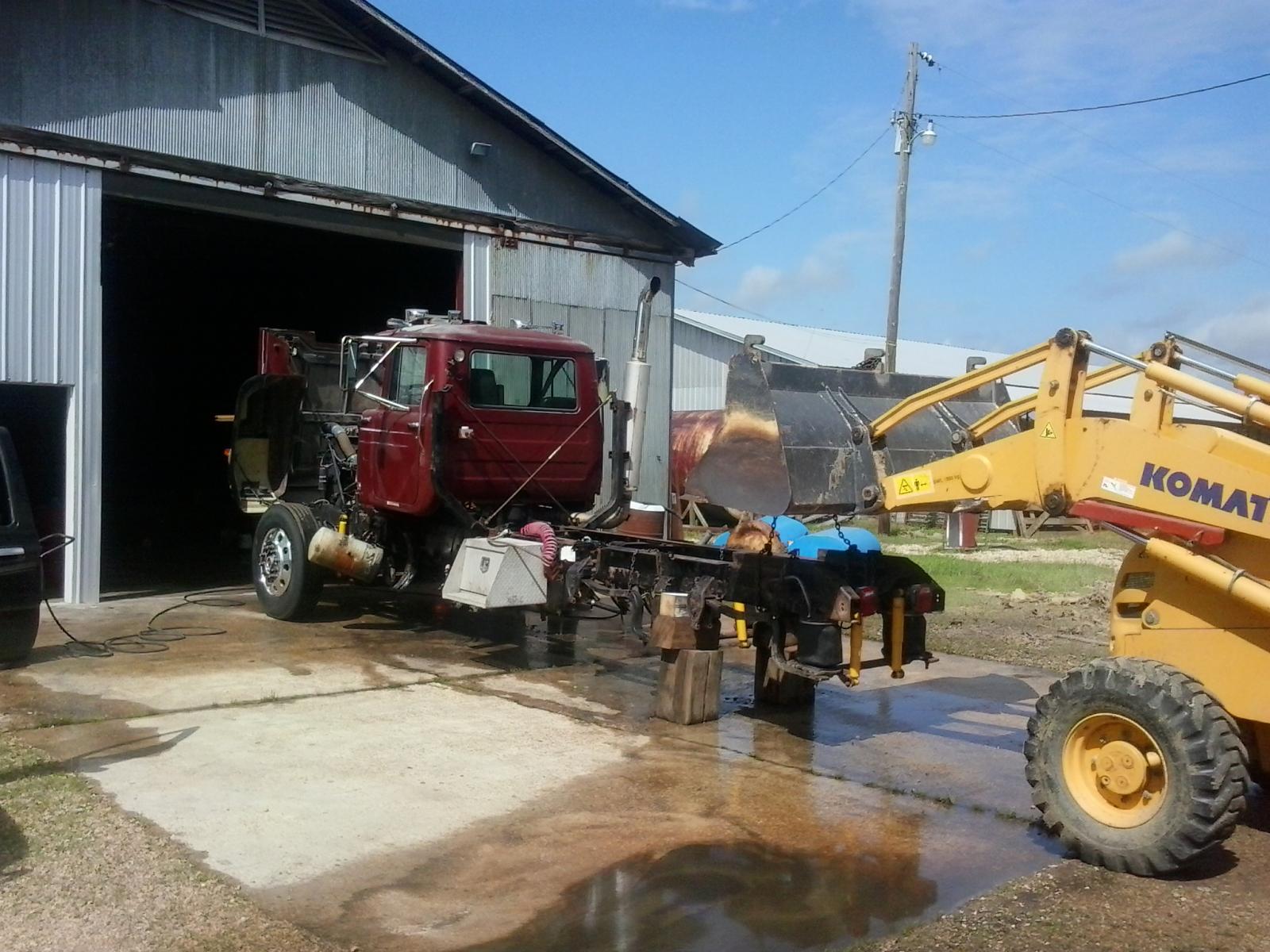

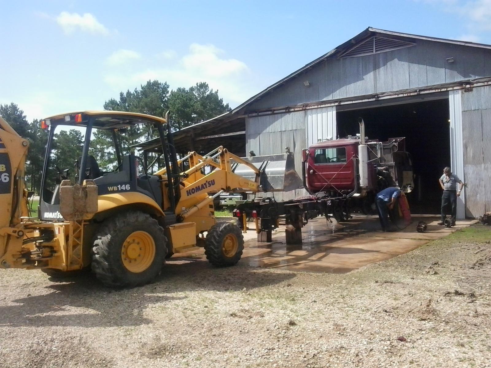

  5. Got 3 new airbags installed today and all of the rear suspension removed as well as the two fuel tanks. I have two new fuel tanks and banjo housings bought and they should be here this week. I have the front axle reassembled with new drums, shoes, bearings, race, wheel seals, tires, rims and oil bathed axle caps. I have new suspension parts like bushings and tracking rods to install. I also have new brake shoes, drums,s-cams, brake canisters and slack adjusters to install once the housings are here. The rebuilt carriers are back as well and they are 4.17's. I should make some quick progress in the near future and post some photos soon.
