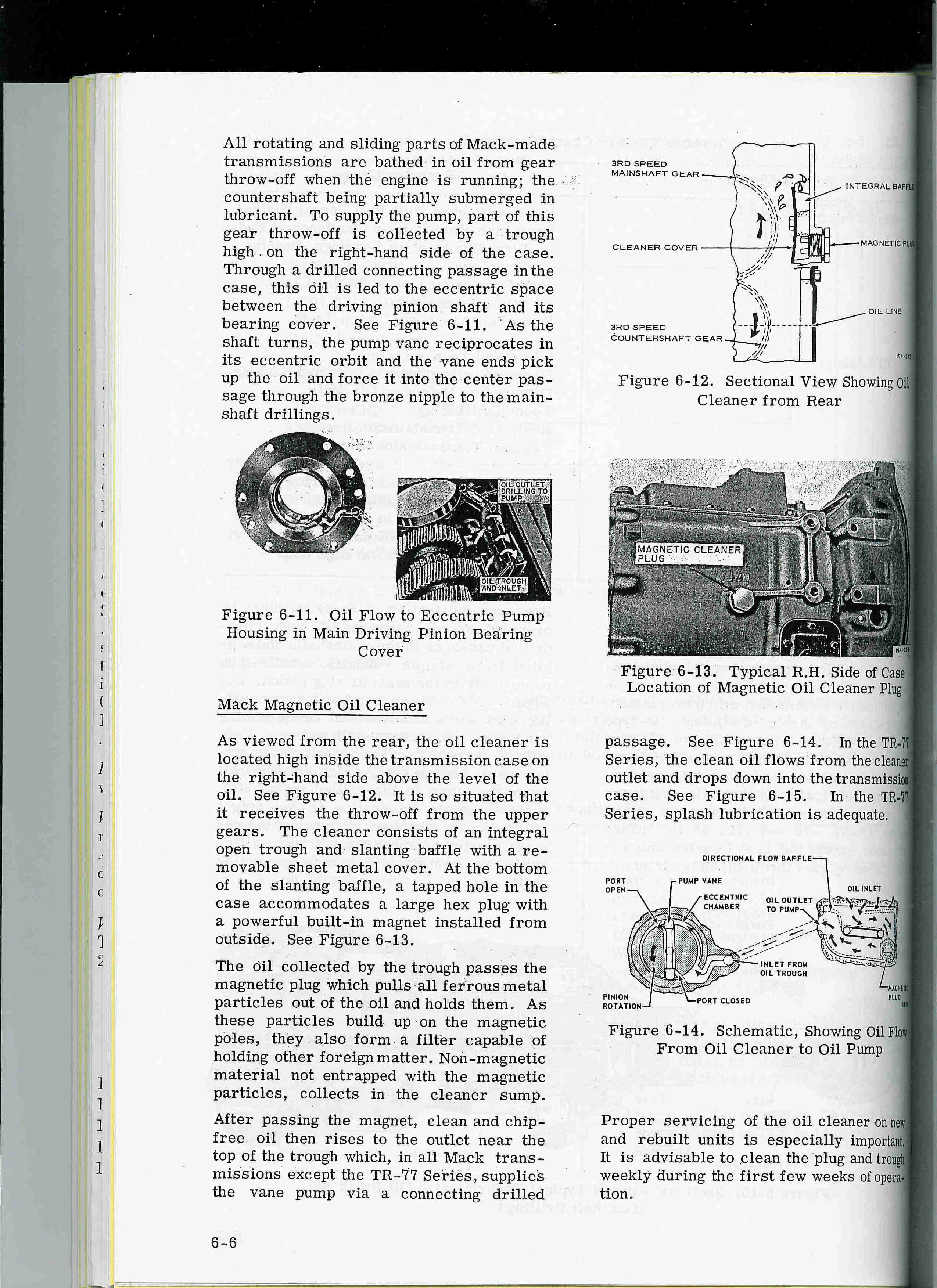

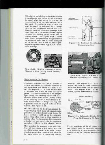

  8. Here is a cross sectional view and side view of a typical Mack transmission. There is a skimmer/baffle on the upper side of the transmission that catches particles in the gear oil that are thrown up by gear movement. There is a plug that you can remove and drain the trash from this skimmer. It is called a magnetic oil cleaner with a baffle. Remove this plug and clean out the baffle area when you change your oil. Here is a picture

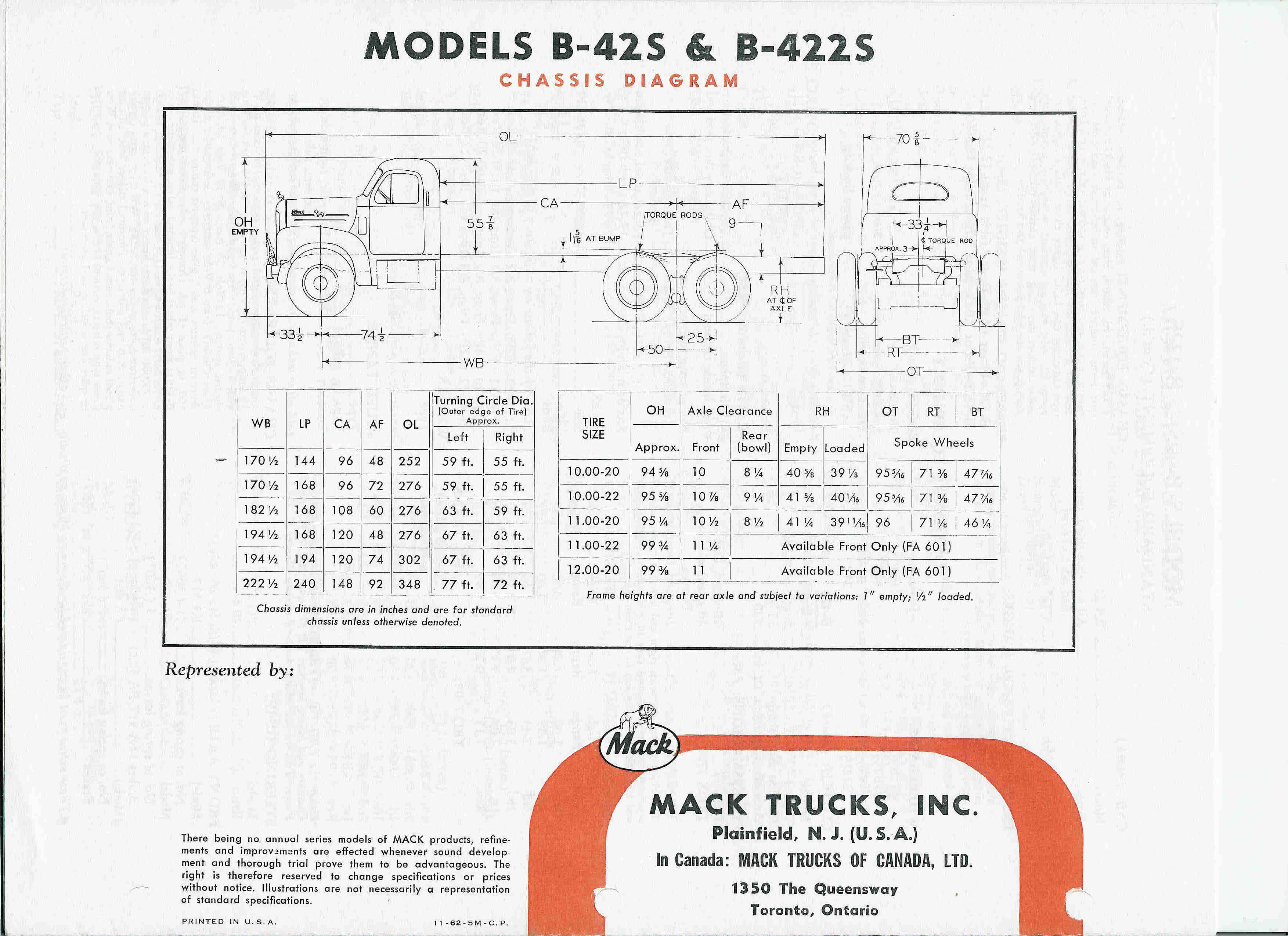

  9. I believe they are called chassis diagrams. I received one from the Mack Museum for my B-42S. Here is a copy
