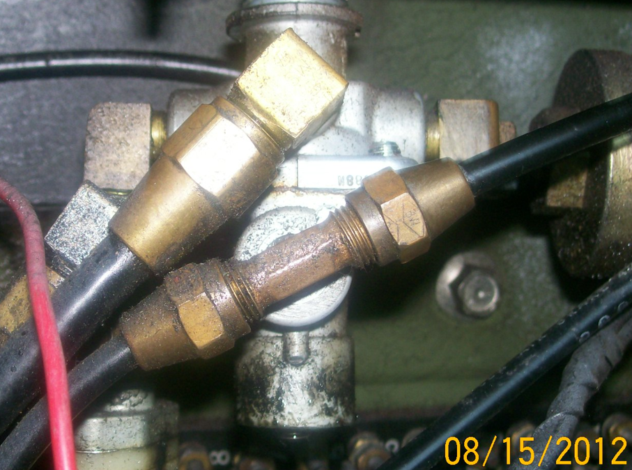

  11. Inversion valve was a predecessor to spring brakes. If the air pressure dropped, the inversion valve sent air from an emergency reservoir to the parking brake chamber of a DD3 type chamber. I don’t think that’s what it is though.
  12. They could have been different back then, couldn’t they?
  13. I wondered about an inversion valve, but I've never seen one that looked like that!
  14. No numbers? Could that be some kind of pressure reducing valve? If you will PM me an email address, I will try to send you some catalogs that might be useful to you...IF the file size isn't too large.

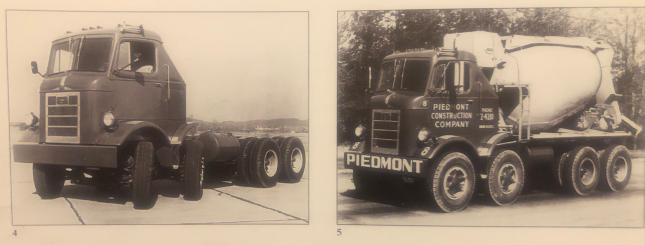

  21. Brocky sent me a picture this morning of an unusual H-model. I happened to have the same picture. It is listed as an H628 in my book. Mack shows only 2 of these made in 1955, Apparently a variant on the H62 chassis, this should have been gas-powered. I saw the picture years ago, but never bothered to check on the rarity of the beast. Indeed, one of the most rare. I think the company was in Winston-Salem, NC. I think they were called Piedmont Concrete Company before this. Gone now, I believe. Thanks to Brocky for pointing this one out!

  23. I wonder the same thing. Maybe the F was already in the works when the G was ready?
  24. That's funny. Even if there is no connection between manufacturers, it is likely that different manufacturers could arrive at similar designs. Happens all the time!
  25. I wonder how much of the grille they reused from the H (top) on the G (bottom).
