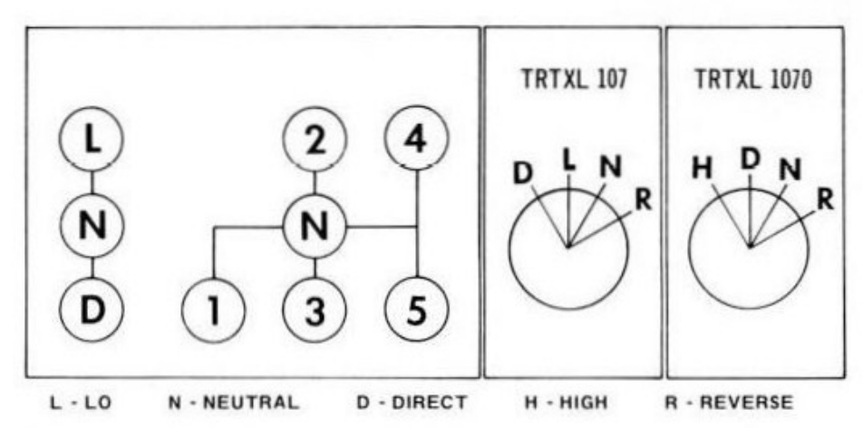

  3. The type of clutch you have (Eaton, Mack, etc.) will determine the exact adjustment procedure. Most are fairly simple. That 5-speed has a HUGE step between gears. Upshifting at 1800 will probably drop down to 1200 or so before it meshes up. Downshifting will be about the opposite...pull down to 1200 and then get up to 1800 before slipping into the next gear. You'll get the hang of it. You'll also get the hang of "floating" the gears (shifting without the clutch). Pretty easy. Just feather the throttle to release the load on the gears, slip it into neutral (no effort required), let off or increase throttle to get the RPM right, and slip it into the next gear (again, no effort on the stick). And, like everybody said, only depress the clutch fully to apply the clutch brake while sitting still (otherwise, they can be a PITA to get into gear). No need to push it all the way to the floor if using it to shift.

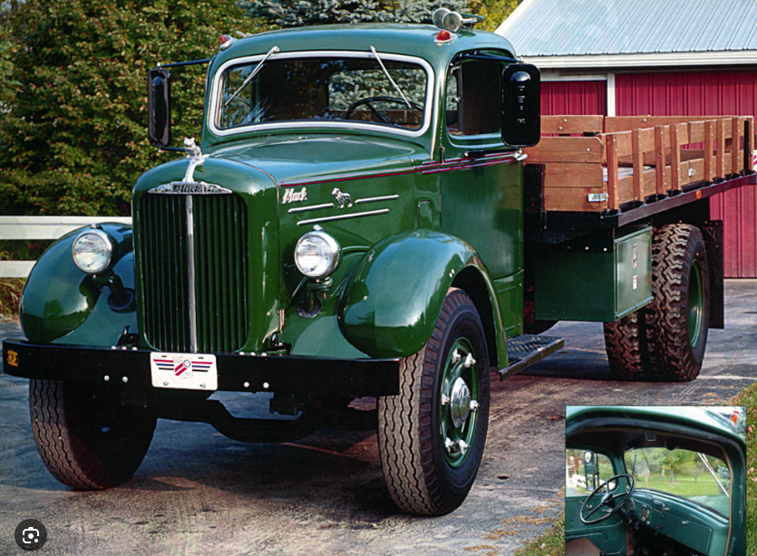

  5. 1950-1953, with a few A20s being done in 1954. Here is a picture of one of the more well-known examples.

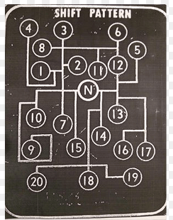

  11. Maybe you need this...
  12. So, again... Are you looking for something with NO air at all? Or were just just wondering about the shift pattern?
  13. Actually, it looks like it also had an air shift portion on it. So, are you looking for a 12-speed with ONLY 2 sticks, or a 12-speed that ALSO has 2 sticks? LOL!
  14. Well there you go! Learn something new on here every day! Thanks, 'Joe!
  15. I don't know of an honest-to-goodness 12-speed 2-stick. But then again, most of my experience is with the "old" (Duplex/Triplex/Quadruplex) stuff. I have seen certain versions of the (overdrive 18-speed) 5 X 4 box called a "14-speed" before. And the overdrive versions of the 5 X 3 units were called "13-speed". But, the only versions of the "real" 12-speed I ever saw were air shifted. You have a knack for coming up with intriguing questions, don't you! I'll be curious to see what comes of this one.

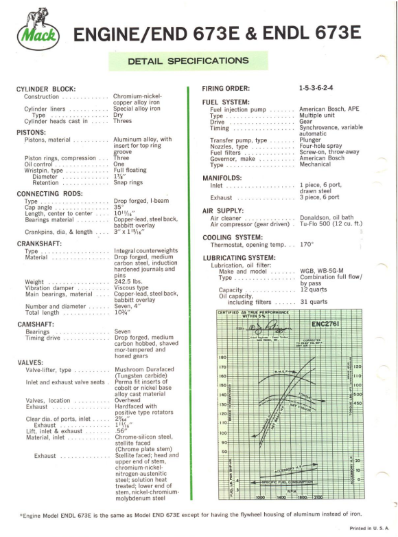

  19. Here was a flyer on the 673E, 180 HP version...
  20. The 180s were very common, from what I remember.
