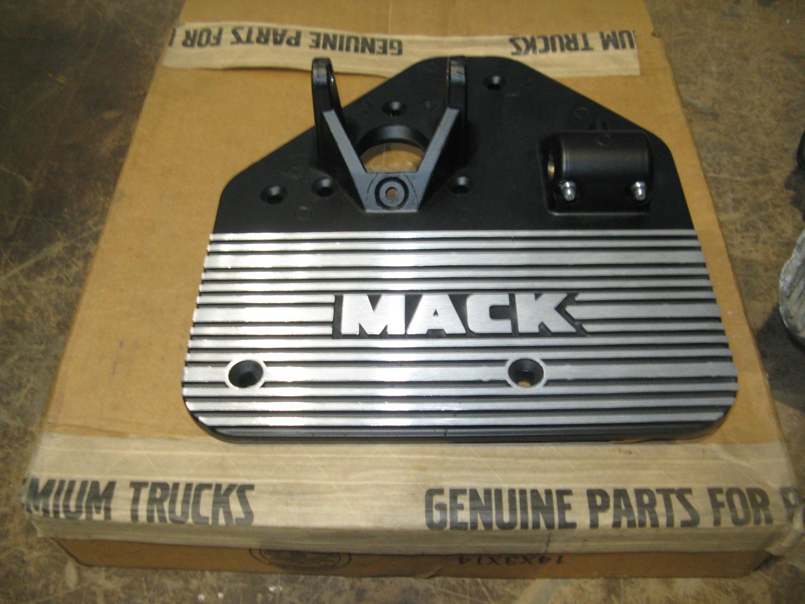

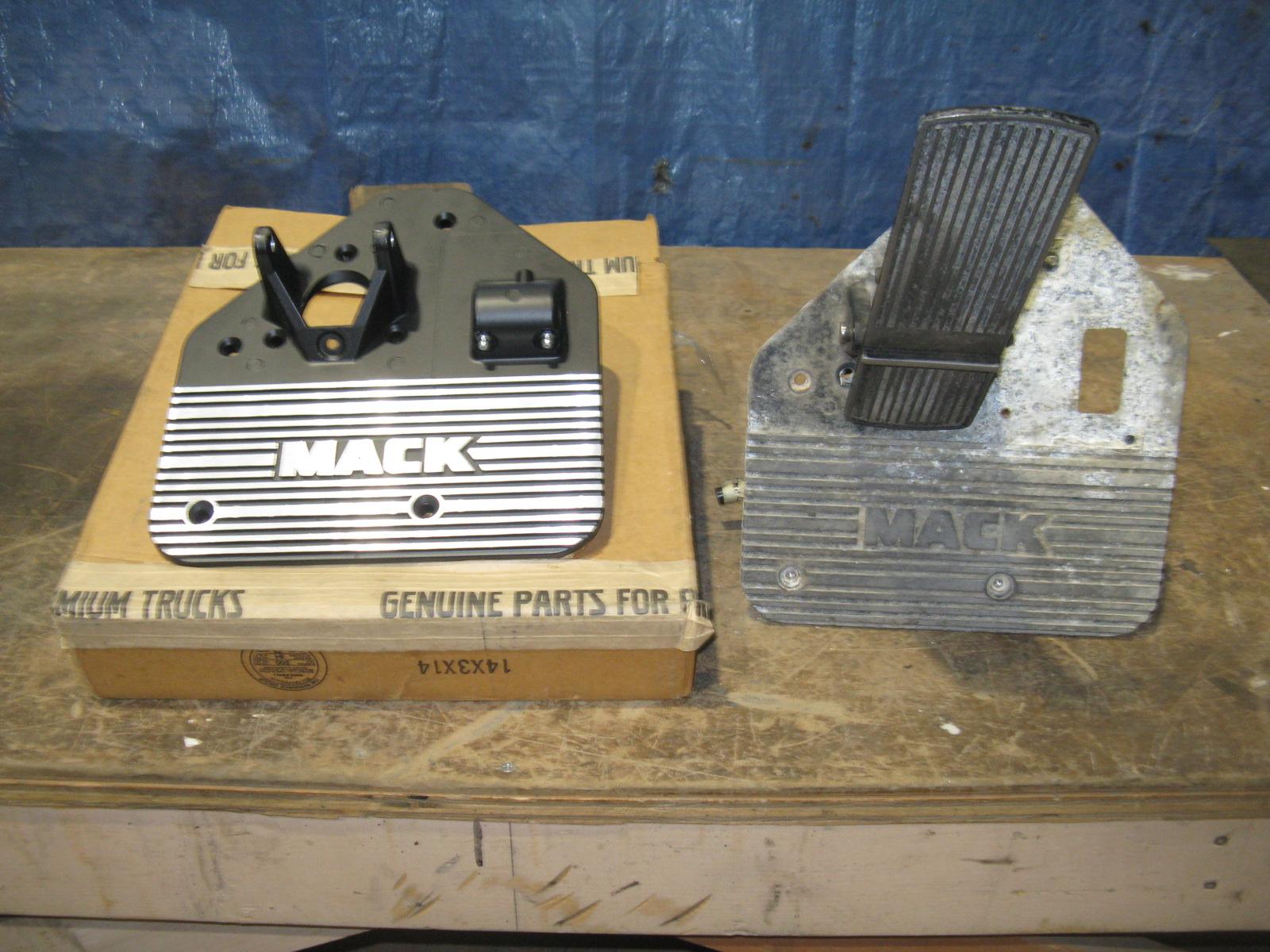

  1. I have a new-old-stock-in-box MH plate, is this the shape you are looking for??? not cheap...!!!! there are plenty of used ones around but they tend to crumble as you take them out set up for regular pedal, the factory grinds off the lugs if you have an air throttle as you can see on my old plate (which I cleaned up and put back in) I even took photos of the re-re if you need them PM me BC Mack

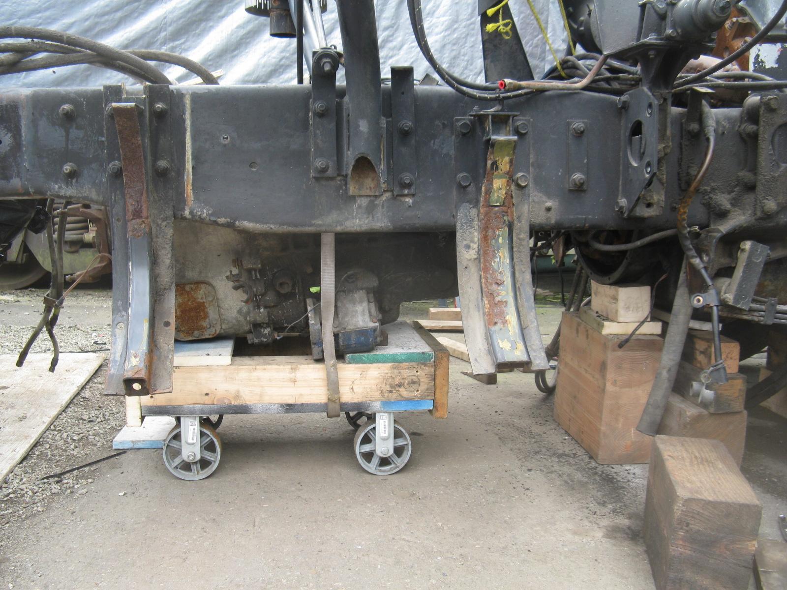

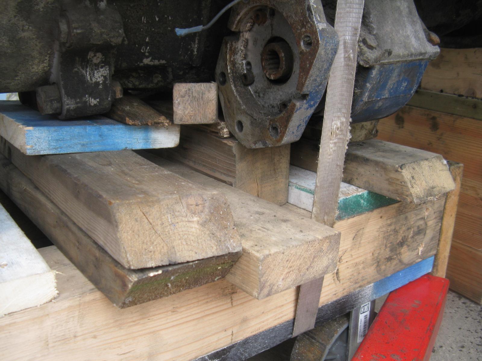

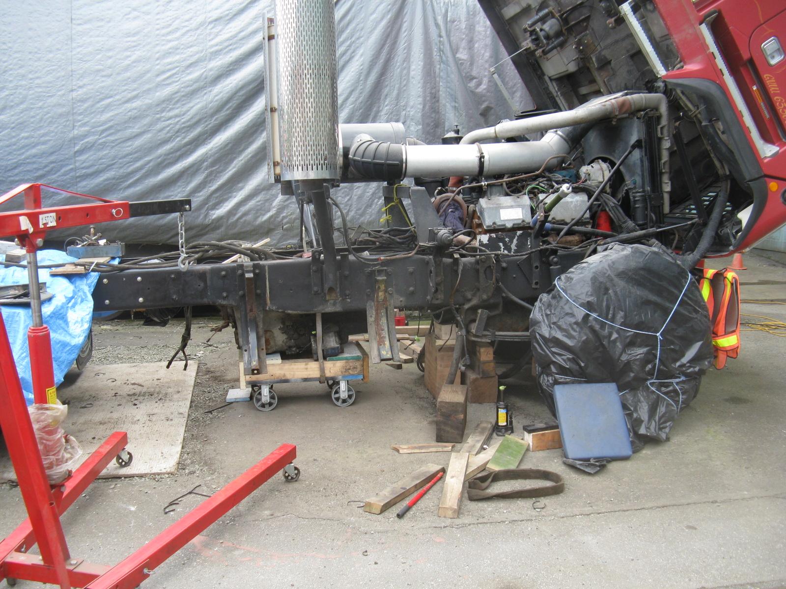

  8. Vlad my other secret is to make a 4 wheel trolley and roll the trans back on it until it bumps into a crossmember, then lift it with a small engine crane, remove the blocking, slide it back some more... easy with a cabover, even easier with a forklift... but it was better to drop it than lift it out, less stuff to move out of the way, you just have to lift the engine enough to have the rear mounts clear then block the trans on the trolley... my 2 cents, worked for me given the environment I had to work in... didn't need to fully remove the trans, just had a disk stuck to the centre plate.. I also removed my bus engine by blocking up the engine and towing the bus forward..!!! there's always another way to do stuff... BC Mack

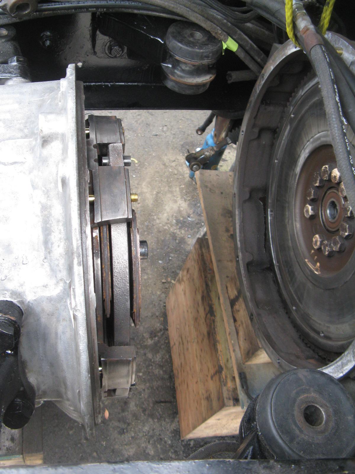

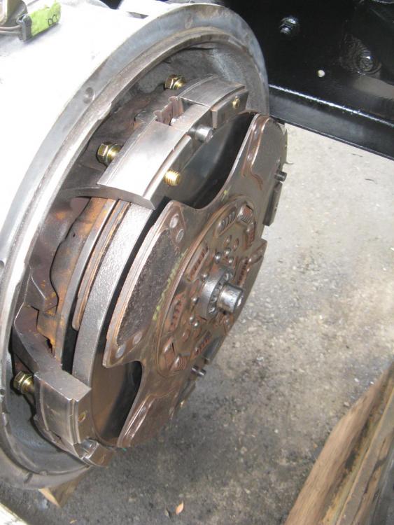

  9. Vlad pics of installing clutch with 18 speed, another trick is to make two guide studs for top as it helps with alignment BC Mack

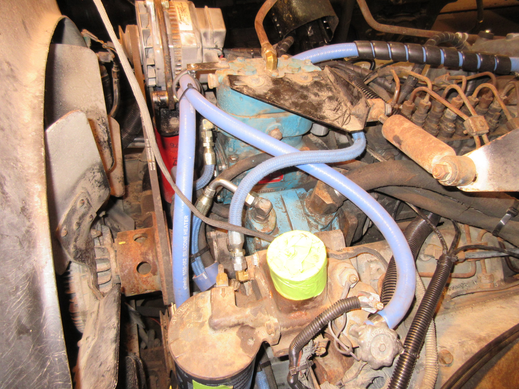

  11. that's the lower damper support.... on the V8 it is attached to a bracket on top of the compressor, yours looks like a Cummins?... I'd flip it over 180 and go looking for a couple of spare holes around the valve covers.. the damper goes sideways to the long linkage so it looks in position right now on Farmer52's photo the damper is not installed, you can see the empty elongated slot below the mount BC Mack
