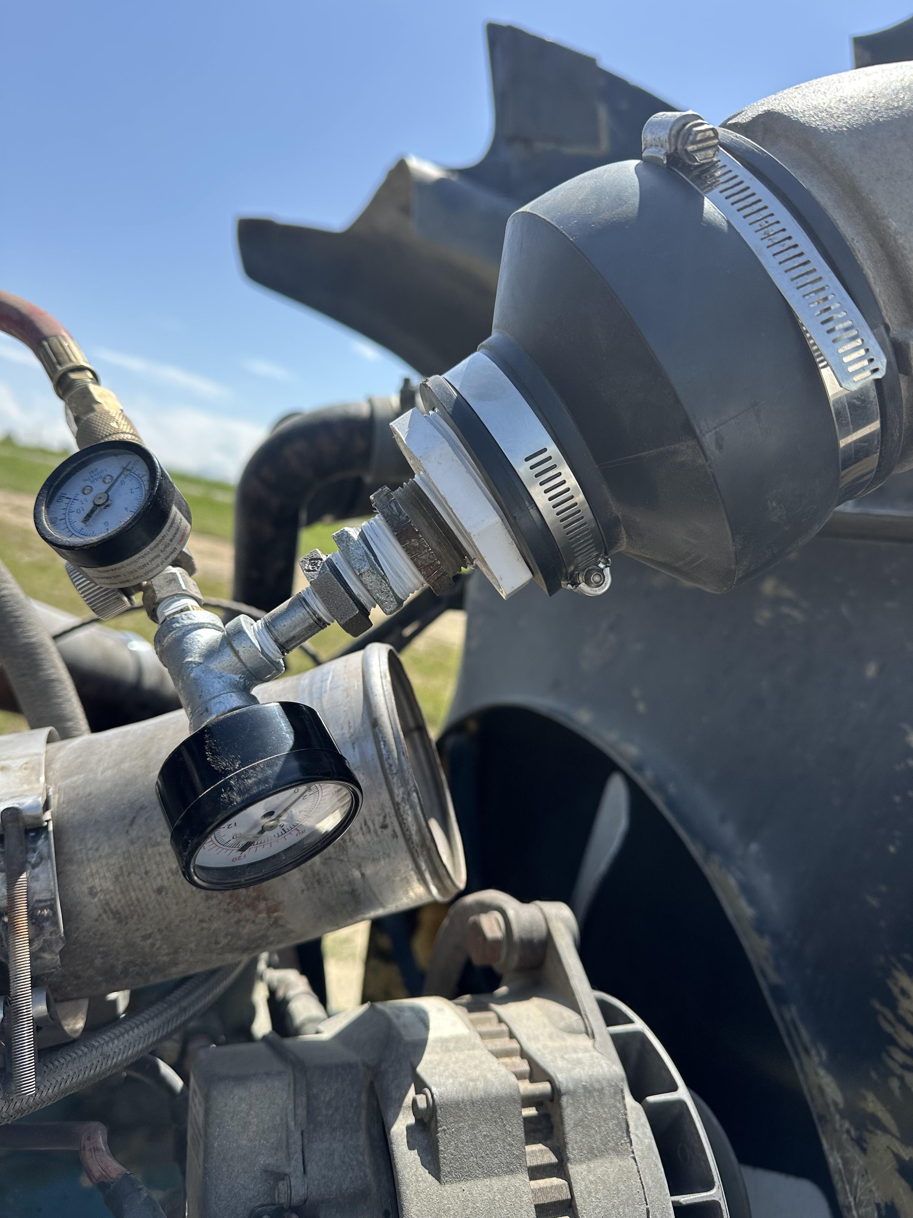

https://www.googleadservices.com/pagead/aclk?sa=L&ai=DChsSEwi33eflmZqOAxXENggFHZ74B_kYACICCAEQIBoCbWQ&co=1&gclid=Cj0KCQjw64jDBhDXARIsABkk8J5pZuKDpgTeenxDmarE-L3O9LxHZdQp20D5JsrUALy4EhfFWHue3GsaAjjfEALw_wcB&sph=&ohost=www.google.com&cid=CAESwwHg9oUHqV36uRgSbbvkbz72M298ShJHG6glAhlB2DjLhlV346HFyHELH3S57AH-duG7SDnYsKL4gj0yOs1JiPiyoIak7aemnZkFjfdpuUm3KGxRWRAfchUt_6vrk9eRZ6EQN8Q0YC3vSQpjmtorPahrV-nG8Epg864ofPlSW6fktY0NIL1hU33jHc0A7KLASjlAVkubZFnUxG9ODW-6d4wOG4VUgje7XanFgMHdajWtbBlWM0l00Ndk8L5dFEFrO55P7O0&category=acrcp_v1_41&sig=AOD64_22SWCMH_4znJO98E2Gu73cxEunzQ&ctype=5&q=&ved=2ahUKEwizqeHlmZqOAxVYq4kEHfOOG7kQwg8oAHoECAoQHw&adurl= Here is a sample of a pressure tester. I have a Pro Set, but this may be good enough for you, and be a good addition to the tool box. There are many other choices....
Some, on here have made pressure testers with PVC parts. If you do that, keep in mind that when you get near 10 psi, these home made tools can pop off with a vengeance. So build it smartly.

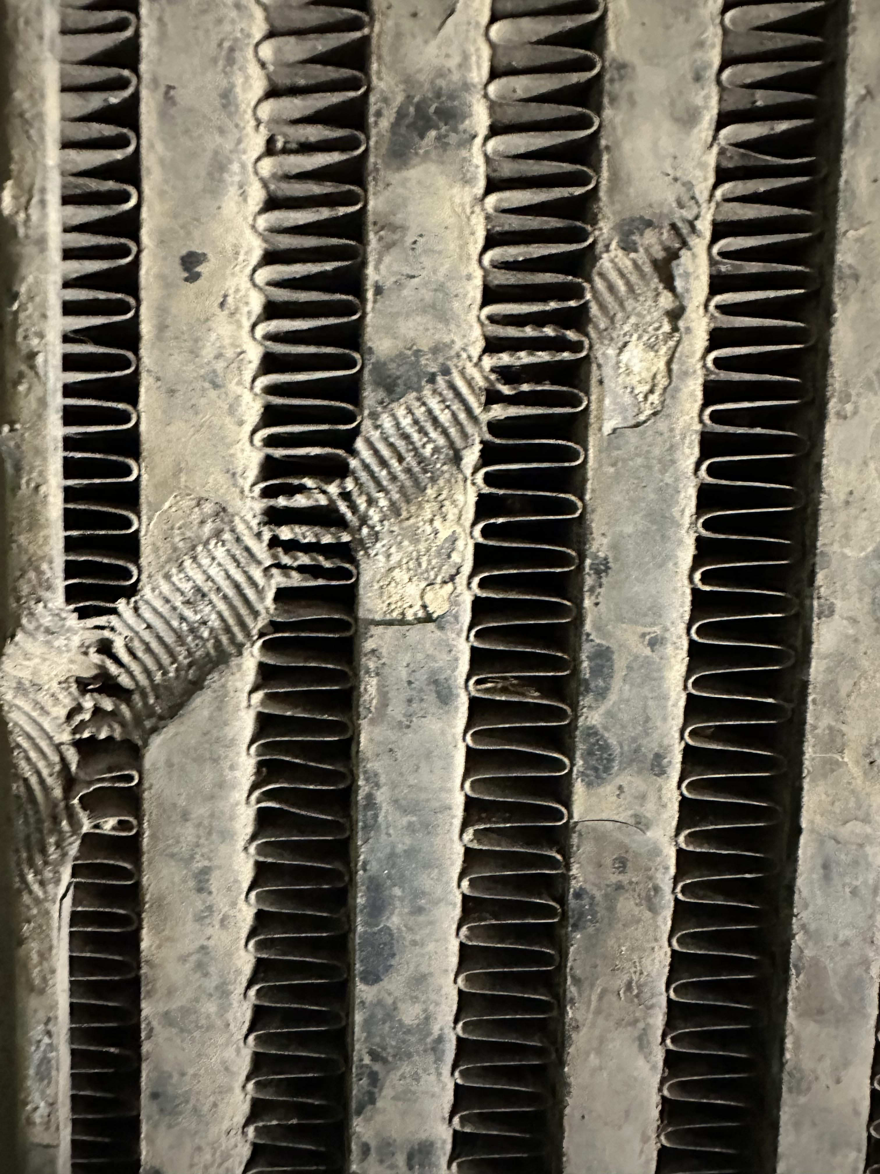

Check boost, could have a crack in the Charge Air Cooler. My '95 e7-350 was a whole different engine when we replaced our cracked CAC. Went from 22psi to peaking around 34 psi under certain conditions.

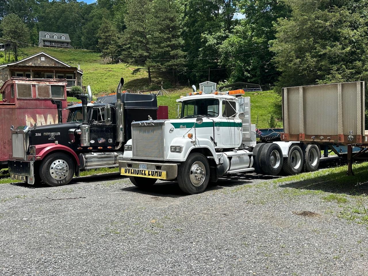

Yes that would be great, I’ll get it for you after while I don’t have it with me, Also I’ll get you the Vin from my RW 753 Superliner and the parts truck I got the 18,000 steering axle from, I’m wondering the difference in the draglunk joint that connects the steering lever . Yes i see a Couple Superliner dumps working on I40 in the gorge, also my Son uses a Whte one with a green strip on I40 also ,, Thank you, I’ll get those VINs -

Can you post/send me the VIN for that Freedom edition? I'd love to see if frame rails were available from Mack still for giggles at least lol. I was just up your way yesterday, I came back from a trip to Knoxville through the Gorge just so I could go back through the area after Helene. Wanted to do that ever since Helene destroyed everything and halted my last vacation... Saw plenty of old Macks out there, a DM800, beautiful white R model in Clinton, TN, several 90's RD's, and even a Superliner still in service pulling machinery to rebuild I40.
