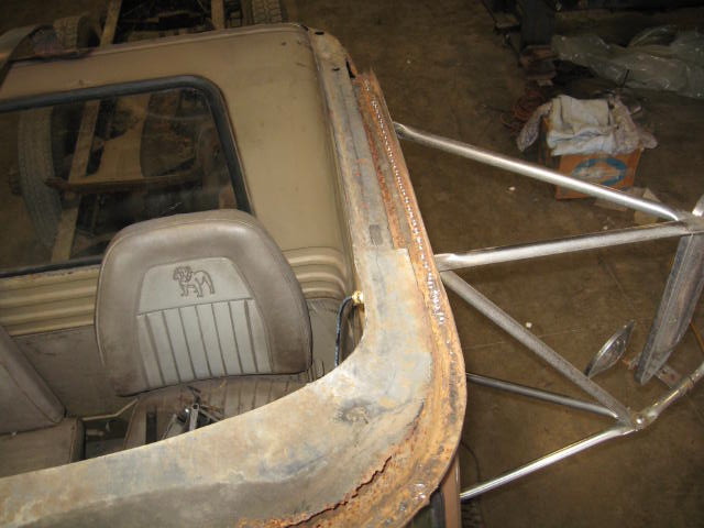

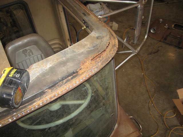

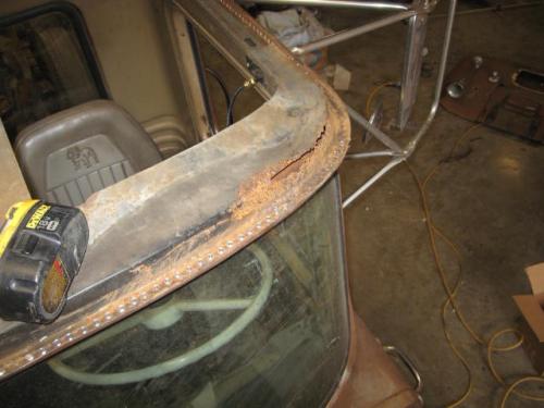

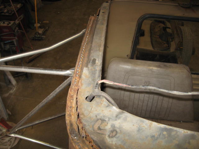

Ok Gents, here is the balance with the roof skin completely removed. As you can see there was rust in between the sandwich of metal consisting of the roof skin, and the interior structure. This is why I went the trouble to remove the balance of the skin that could be buried under the new panel. If the rust is not removed at this point, the repair will be short lived.

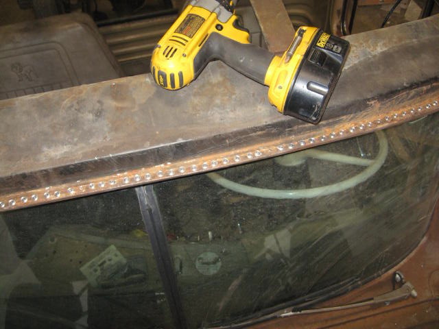

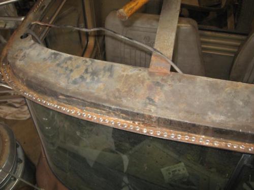

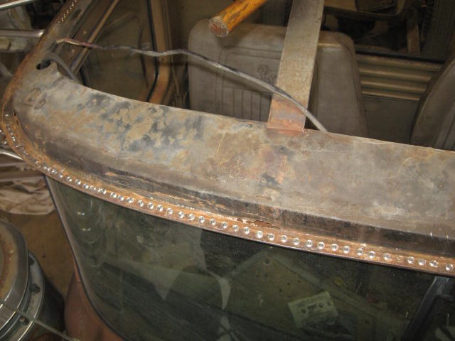

I've not ground anything yet as I wanted you to see the amount of spot welding that holds just the roof skin to the cab. These spot welds are placed about every 1/2 inch apart consistently around the perimeter. The balance of the cab structure is put together much the same way. I have spent about an hour and a half just drilling welds. I've probably expended about 45 minutes center punching each weld to ensure the cutter doesn't walk. What is amazing about these rotary cutters is that I did not go through the bottom of the sandwich once in all that drilling.
When I put this back together, I will dump the gutter full of self leveling seam sealer inside, and outside. It will be effectively water tight in these areas. Theoretically, it should never rust again. They don't do this at assembly due to cost. I will have over $100.00 in sealer alone.

Damn Rob you don't waste anytime. When I say I'm gonna do something it can be a month before it actually happens. I've seen alot of these trucks rust on the roof like that. What's the cause?
Condensation more than anything Joe. The cab structure is/was bare carbon steel until the 1985? model year when "Galvaneal" was started to be used for slowing this degradation down. The when the roof skin is cold it draws moisture. This moisture is trapped between the layers of steel that form the rain gutter, roof skin, and cab structure. Any corrosion prevention that is placed onto the bare steel sheeting is burned away during the manufacturing process, (spot welding). Unfortunately, nothing is effectively placed correctly to aleviate the slow decay that starts immediately after being exposed to the elements. If the area is not warm to drive the moisture out, then sealed with a weatherproof sealant or encapsulant it will draw fresh moisture from the air that condenses on the steel.
When these trucks were fairly new and not rusted, I could skin the roof in about 4.5 hours, and not have to paint below the gutter. When you have to go after the rust, it will take three times that to make an effective repair, and most of the cab will have to be painted.
Sorry that I forgot to orient the photos before posting them. Could make anyone that drives a Pete too dizzy to drive with all that head bobbing.
