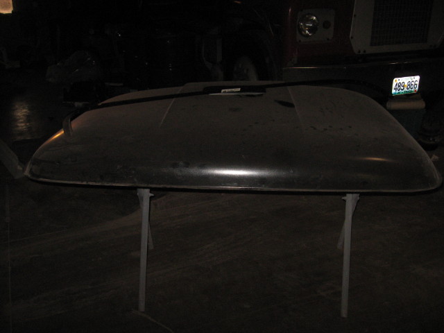

I have some NOS rain gutter, and roof skins for an R model cab at the shop and will post photos if there is any confusion. I've put a lot of them on through the years and not saying that a person couldn't fabricate somthing to work, but it would be a lot or work to look and function correctly.

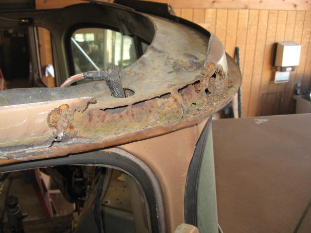

Rob    613
If it's not rusted yet and that sounds like what your saying, I have seen a few guys that filled the gutter in with silicone and it seamed to prevent any rust problems.

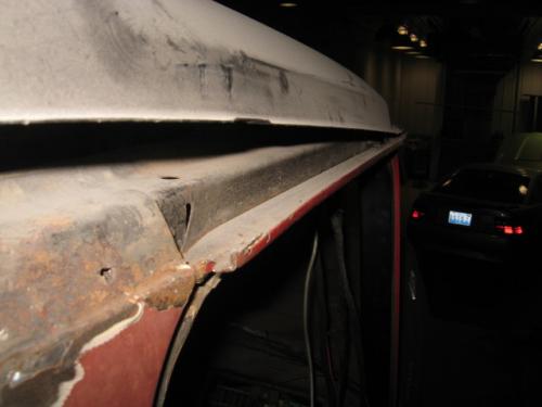

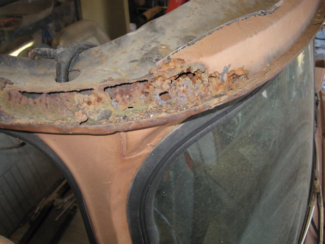

The cabs start to rust in this area for a couple of different reasons:
The roof skin "flange" is spot welded to the drip rail all along the perimeter. As one knows you cannot weld through an insulator so this is usually bare carbon steel when the welding takes place. This produces a "sandwich" of sheet metal, (one layer on top of the other) and there are inherent voids between the spot welds. This is usually not adequately sealed on the inside of the cab and the condensation of a cold roof panel, coupled with a warm operators cabin produces condensation that accelerates the sheet metal corrosion. The seam sealer that is poured and worked into the gutter is to seal the outer flange area and bury the weld seam. It does nothing to protect from the inside where the corrosion starts.
The best way to delay the onset of this degradation, (corrosion) is to seal the inside of the cab. Anything, new or old will benefit from this action. I use a product call "Rust Fire" that sprays on almost like a lubricant and litterally runs into cavities, and then solidifys into a wax effectively sealing the area from moisture intrusion. Although this not absolutely perfect, it works much better than nothing at all to counter the elements. It also smells like asphault for about three solid days so there is a delay to return the vehicle to service. The stuff also stay sticky for that same three days!
As was mentioned, one could cut the drip rail off of the cab and fabricate some type of arrangement to retain the roof skin but it would either not look right, or function properly. Although a Mack cab does not gain major strength through the roof skin, there is a lot of vibration present and if not welded solid in some fashion, will crack. I like the four inch wide band type repair myself. I can just imagine how that would look.
Rob

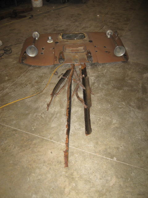

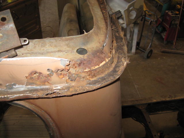

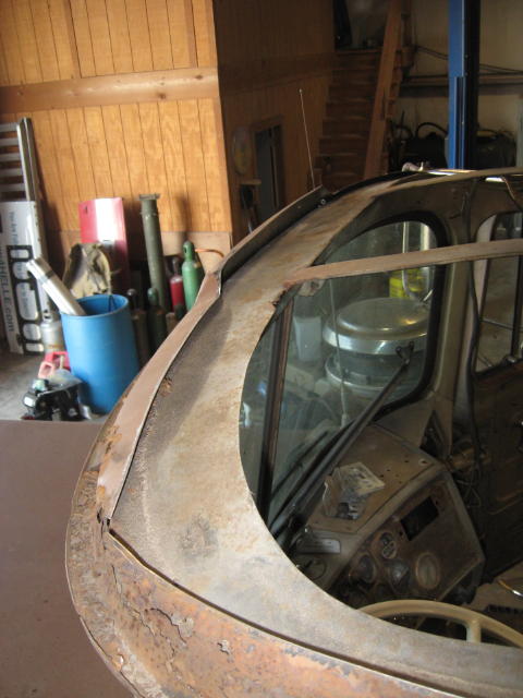

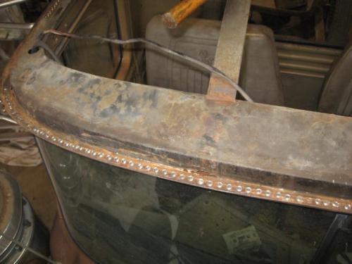

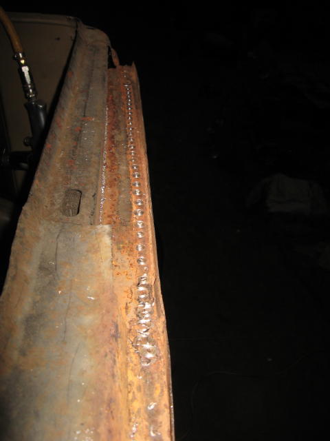

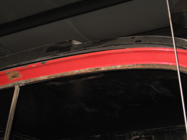

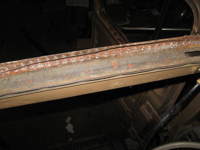

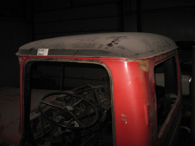

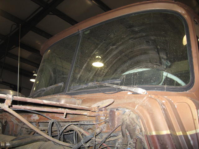

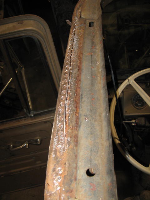

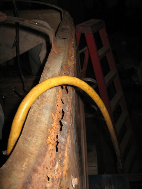

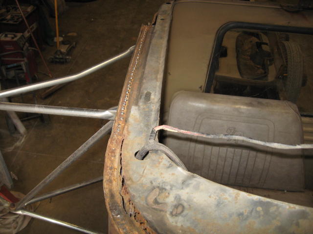

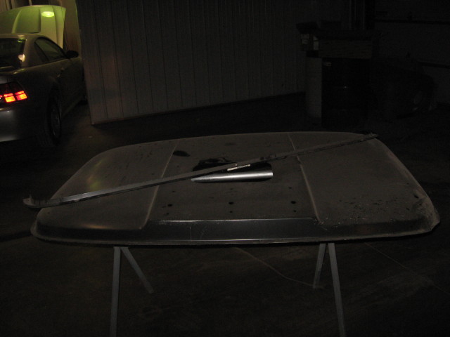

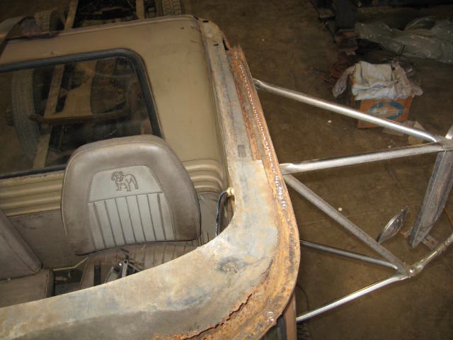

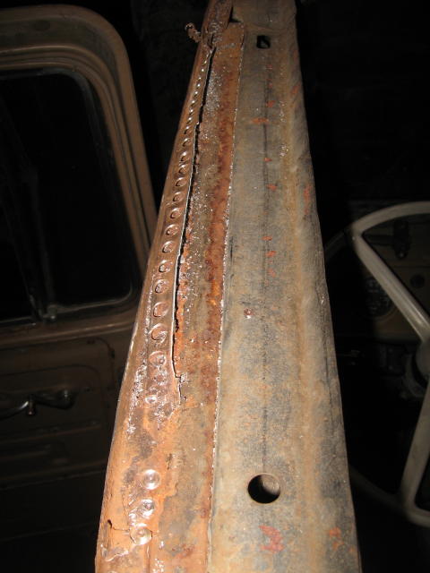

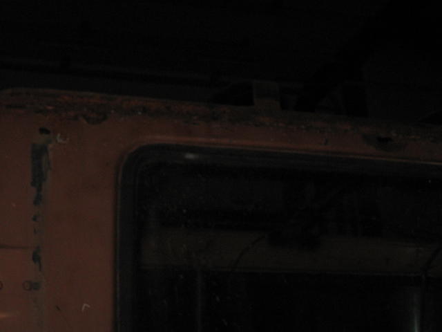

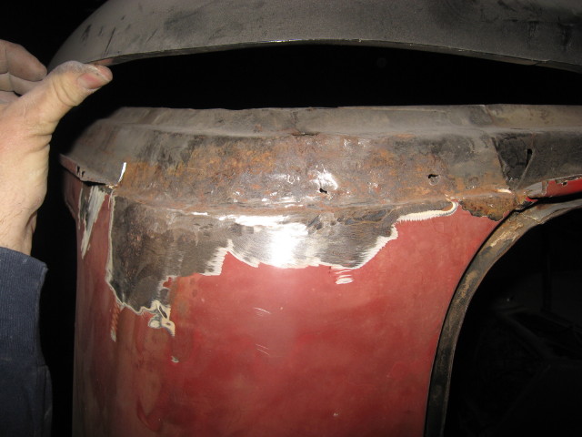

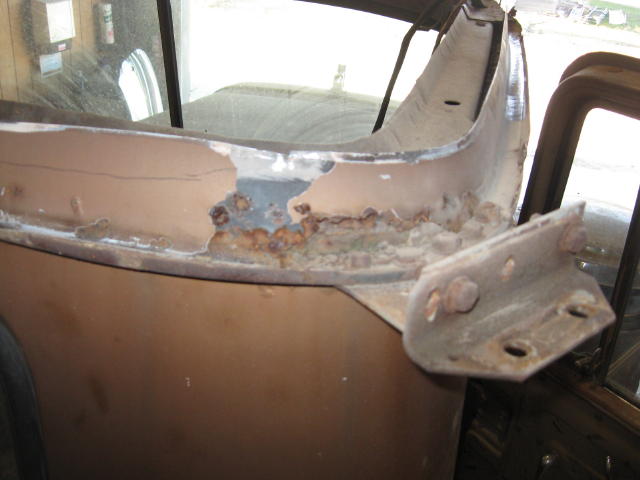

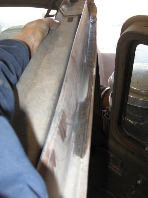

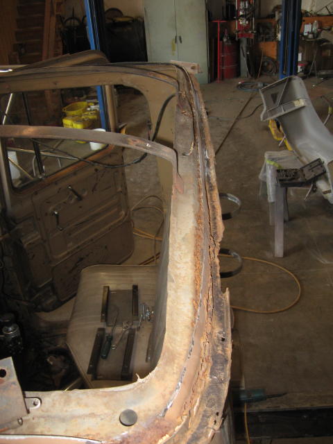

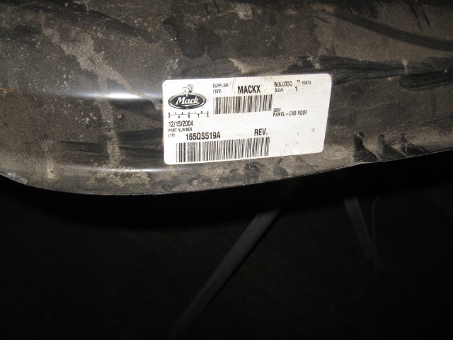

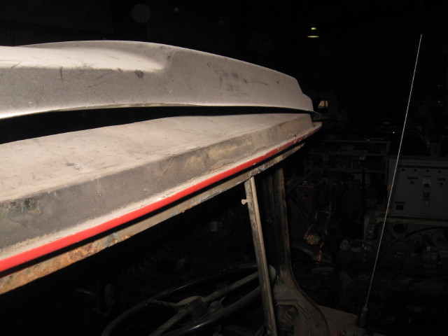

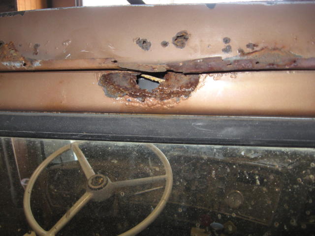

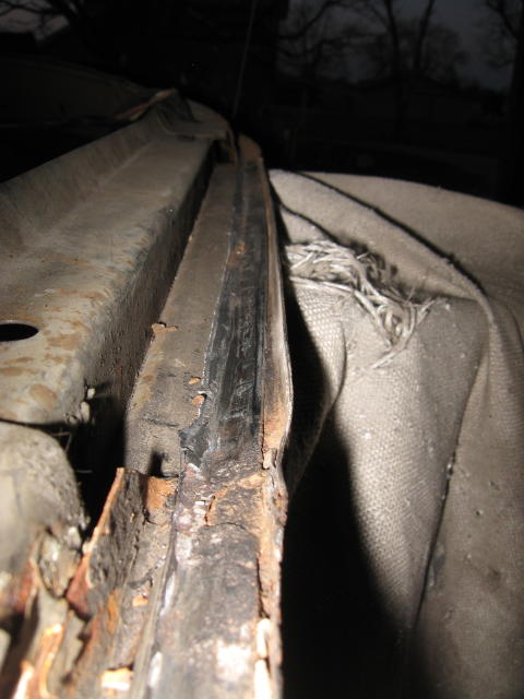

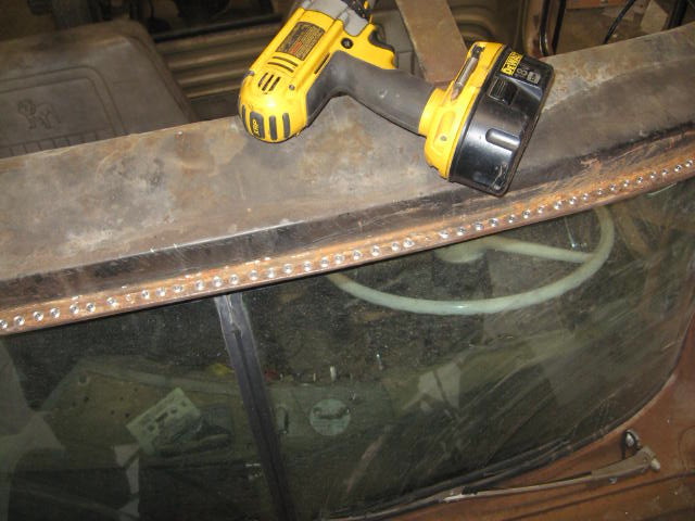

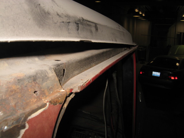

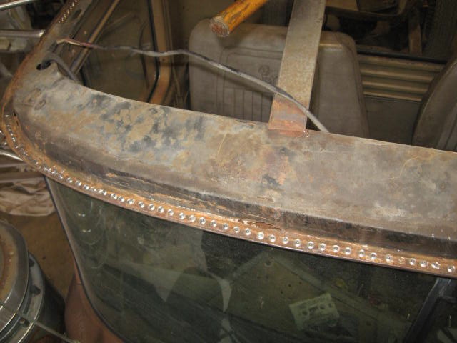

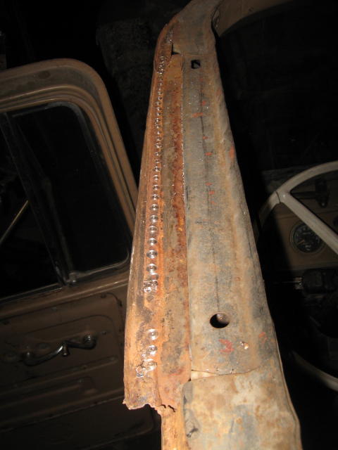

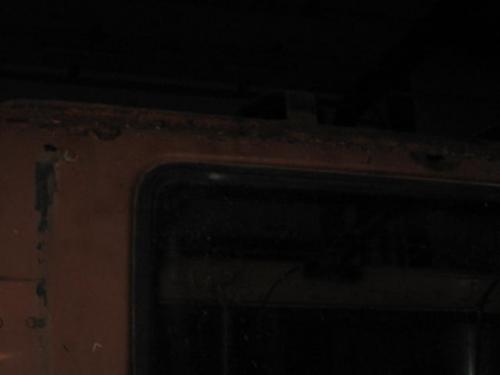

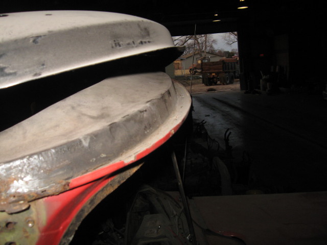

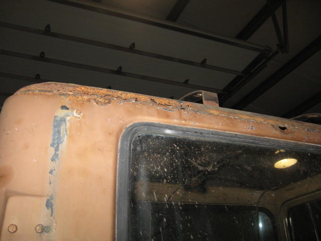

Here is you some entertainment value. The red truck is my RL755L, the brown one my RL797L. The red cab will be replaced as it is too far gone up top to work with, but you can see how things fit together.
Rob

Rob    613
Rob I should just gut the interior. Drive down to your shop on a friday. Bring a case of beer and some pizza and have you school me as I do the job at your shop LOL. you make it sound so simple LOL
Always a good idea to remove the interior. There is a lot of welding, then dressing of those welds for a good job to be had. You can see in a couple of photos the shape of the backlight in the brown cab from someone welding, or grinding in close proximity to the glass as it is destroyed. It is by no shape, nor form a "cake walk" to perform. A novice will find it intimidating, (and they should) although it is not hard. A lot of planning and thinking is in order prior to a satisfactory repair.
I've done this shit for far too many years to not be comfortable, but there are still times when I have to think how to make a repair as I don't know it all, contrary to popular belief.
Rob

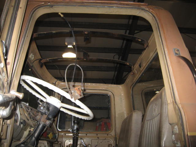

Lmackattack    763
thanks for the pics Rob. I must have missed that post? On the tan truck...did you cut the roof off first before you went around with the rotobroach and remove the skin welds? I dont think my cab is this bad as there was one small spot above the windshield and the rest is all in the back.
Do the skins have all the holes drilled for the horns roof lights etc and have the incerts to retain the bolts to mount them?...?
Share this post
Link to post

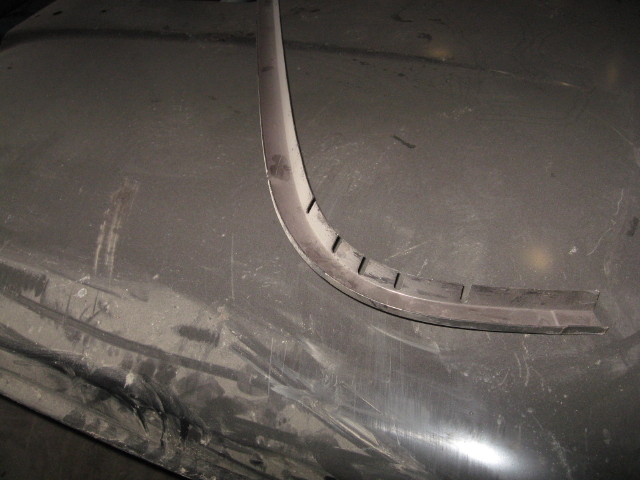

Rob    613
I always cut the center loose from the perimeter of a panel as it is much easier and faster to handle small pieces rather than large. Yes, all the roofs have the holes punched into them. What is kinda funny is they are punched for the old style marker lamps such is on a B model. If I remember correctly you need to drill the rear hole for the newer style lampholder such as were on the Superliners. The dual airhorn holes are there also.
The threaded inserts you refer to are called "Rivetnuts", or "Rivnuts", and they are not in the holes, neither are the braces to hold the interior overhead console. It is just an empty stamping.

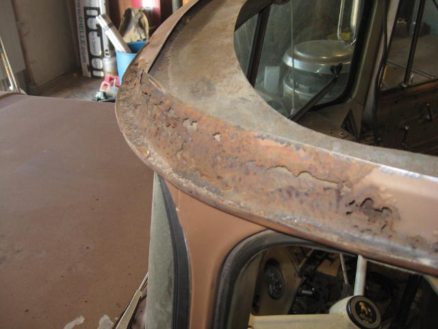

There is rust in the front also, you just can't see it yet. If it's rusted in the rear, it's rusted in the front too. I'd bet with 80 grit on a DA sanding the corners you'd see slight discoloration to the metal and would be able to push a screwdriver through it easily. This is just from what I've experienced, your's could be an exception. Sure would hate to not check into it closely and need to redo in six months however.
Rob

Rob    613
thats what I was afraid of ...rust in the front. hopefully It will be light and some patches will take care of it. Sounds like I need to get the truck inside for a few weeks and pull the roof off, fix all the little rust issues around the rail and hope it lasts for another 30 years? Figures I just start dressing up the interior and now I need to address the roof!!! When I got the truck I had to put in some brakets to support the newer style headliner with over head console. this was not that hard to do. I guess at that point you pull all the stuff off the cab and just repaint the whole cab and be done with it LOL.. talk about a can of worms!!!!
Trent
It's always better that once the decision is made to do the job, Do it right. Lot less headaches in the future that way.

Lmackattack    763
thanks rob... I just went out and got a 3/8 rotobroach kit with 3 double sided replacement cutters. the auto body shop had some por 15 so I will likely use that to paint the surface that I can see and then find some rust fire spray yo coat the semas that I cant see.
all I have to say is Wow... a week ago I was just going to put in sound dead meterial. now the roof is coming off!!!
having a guy come out to sand blast the frame, new stainless side box and 1/2 fenders on order as well. Busy few weeks ahead of me here!!!!
thanks for all this help Rob!!!

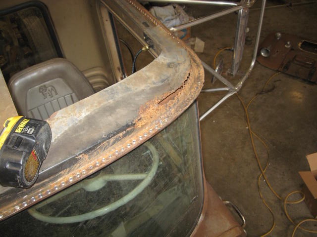

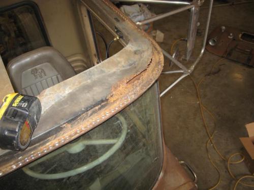

Lmackattack    763
Hi Rob
I just got back and have 1/2 the roof off the cab. the roto broaches dont cut as nice as I thought they would. They dig into the glue and then try to take off in a diffrent direction. I may try a diffrent brand as you suggested.. Anyways the whole back half of the roof was held on by paint. rear corners seame ok at the radius. front half of the sides and whole front are solid.... from the out side.
I was able to cut into the drivers side and its is almost done so I am almost half way there getting it off. I figure by Sat after noon I will have the roof off and making repairs to the rails. So far I can see that the rear cab wall gutter has some issues as rust is above and below it. I may need to remove the back section to clean behind it and re seal it. Kinda glad I got into this now and not replace the cab in 5 years when it was two far gone.

Rob    613
Hi Rob
Did you remove the seam sealer before starting to drill? Those hollow cutters always dig, take off different directions, and snap with you usually sporting a bandage and pain afterward.
I used to purchase them by the box until the other type came out from the same company, (Blair). Never have went back and I've used prolly all of the tools over the years available.
Rob
