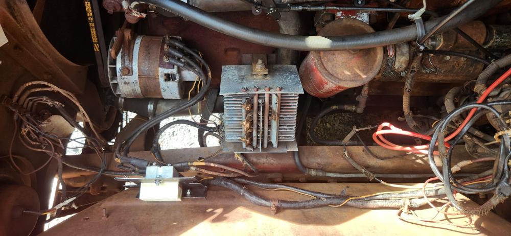

8 hours ago, T-Mack1 said:
Finally for this update,  Installed the solid-state 3-Phase rectifier to replace the selenium one.   Mounted it to a piece of aluminum and for added measure, added an addition small heat sink to the back.  It's mounted on the inner fender.  The B-model fender insert hides it well.  Plan is to fake out that we still have the old one hooked up, for looks.  Note: we and going to be rewiring the truck real soon, so forgive us using the old wires for now.
At the risk of sounding dumb, what is the rectifier for ?
Not a dumb question.  We don't have a generator.  We have an Alternator.  They make AC voltage so it needs to be converted to DC and that is done with a rectifier.   Although many generators make AC, automotive ones generally make a pulsating DC so no need to convert.  The pulses of DC go into the battery and that smooths it out so you have steady voltage.
And, the question many people ask, what's the difference between them?  Generators have magnets in them.  Some of them, big magnets that do all the work,  some small magnets that excite a voltage on the parts of the gen to make a voltage that then gets spun to amplify and get the desired voltage.    An alternator doesn't have magnets.  It uses two wire coils, one spinning , one fixed.  By putting voltage on one coil, you can get the desired voltage on the other.  By varying the input voltage you can control the output power to get the desired amount.
Which is better????   Both have good points.  In the automotive world, a generator will create voltage even if the battery is dead as a door nail, where a alternator needs a voltage to start making voltage.   A vehicle with a generator can be push started with no voltage on the battery and will run.  An alternator vehicle  needs a tiny bit a voltage so it won't work on a totally dead battery .   A generator charges at a fixed rate, where an alternator has a variable charge rate, so will charges the battery faster.  At idle, a generator usually drops in voltage (lights dim) where on a alternator, you can vary the input and get more output at idle/low RPM's.
NOTE: : Since energy doesn't just come from nowhere, the energy to get to the desired voltage output is from what ever is spinning the generator (Gas, diesel, Hydro etc etc.).   That's why, once you get a vehicle with an alternator running by jump starting it,  it can make voltage.
Automotive alternators and generators both produce power to recharge the vehicles battery.
Both have electromagnets, neither have permanent magnets. (Some small engines use permanent magnets as do some motorcycles, but the amount they can produce is limited)
Modern car and truck alternators all have rectifiers, but they are not separate, they are located inside the case of the alternator, where they can be cooled by the fan.
Generators are somewhat limited in their power output. The field is the stationary coil and the power comes from the rotating (armature). The biggest generator generally fitted was a 50 amp unit, and to make those 50 amps, it had to be turning fairly fast.
Leece Neville was the 1st to produce automotive alternators, but at the time the only rectifiers were big metal oxide types that had very limiting characteristics. Still, they can produce more power at lower RPM.  They had to have remote mounted rectifiers because they were so large and needed a lot of cooling surface area. In most applications the early alternators weren't worth the trouble. In police, fire and tow trucks that might be working at a scene for hours at  a time, lights etc on, they were worth it. So they were retro-fitted or installed when the vehicle was ordered.
Once silicon diodes were invented around 1960 (late 50's) then the switch to alternators with internal rectifiers became ubiquitous.
Before most fire trucks had 120 volt inverters or generators, you could also tap into the AC output with a transformer and run 120volt lights and universal motors for saws and such.
 Even after the silicon diode, many mfg of large vehicle alternators kept external AC taps for use with a transformer (Delco DN40 and DN 30) as well as various other.
In the late 50's Leece Neville sold a "conversion kit" to convert their early external metal oxide rectifier alternator to internal diodes. I did a write up about installing one on my early Leece Neville.

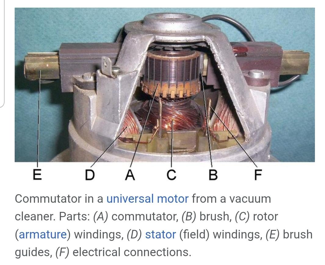

Alternators last much longer than generators in the automotive world as the spin so quick and the generator has a commutator
And a alternator has slip rings
The commutator by it's design us very aggressive on the brush gear and it wears very quickly
Slip rings are nice and smooth and will often last the life of the motor
