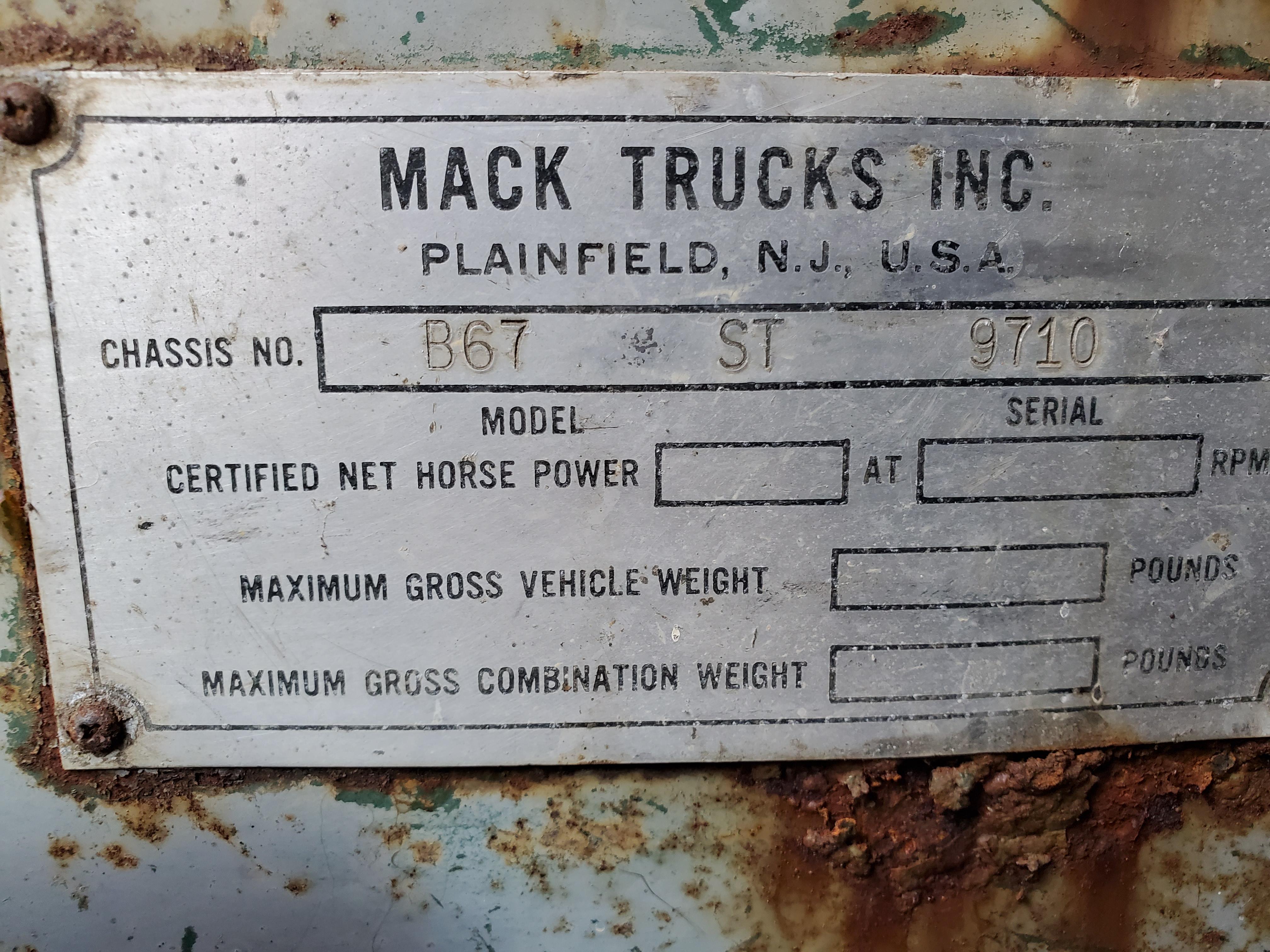

Please what engine is in your B67?
In all the Mack books that I have seen and the internet I have never seen a B67 with the alloy radiator. Your truck may be a rare B model, 1 of a low number built with the alloy radiator, most B67's had the small metal radiator cowling. The same alloy radiator was fitted to the B615 with the V8 - 864, B73 series with various motors and B75 series with various motors. The B73 had the split radiator shutters, with the center vertical post.

END711 and 3-piece aluminum radiator according the order sheet. It was a build-to-oreder for Gateway Transportation in St. Paul MN.
The attached PDF is the build sheet

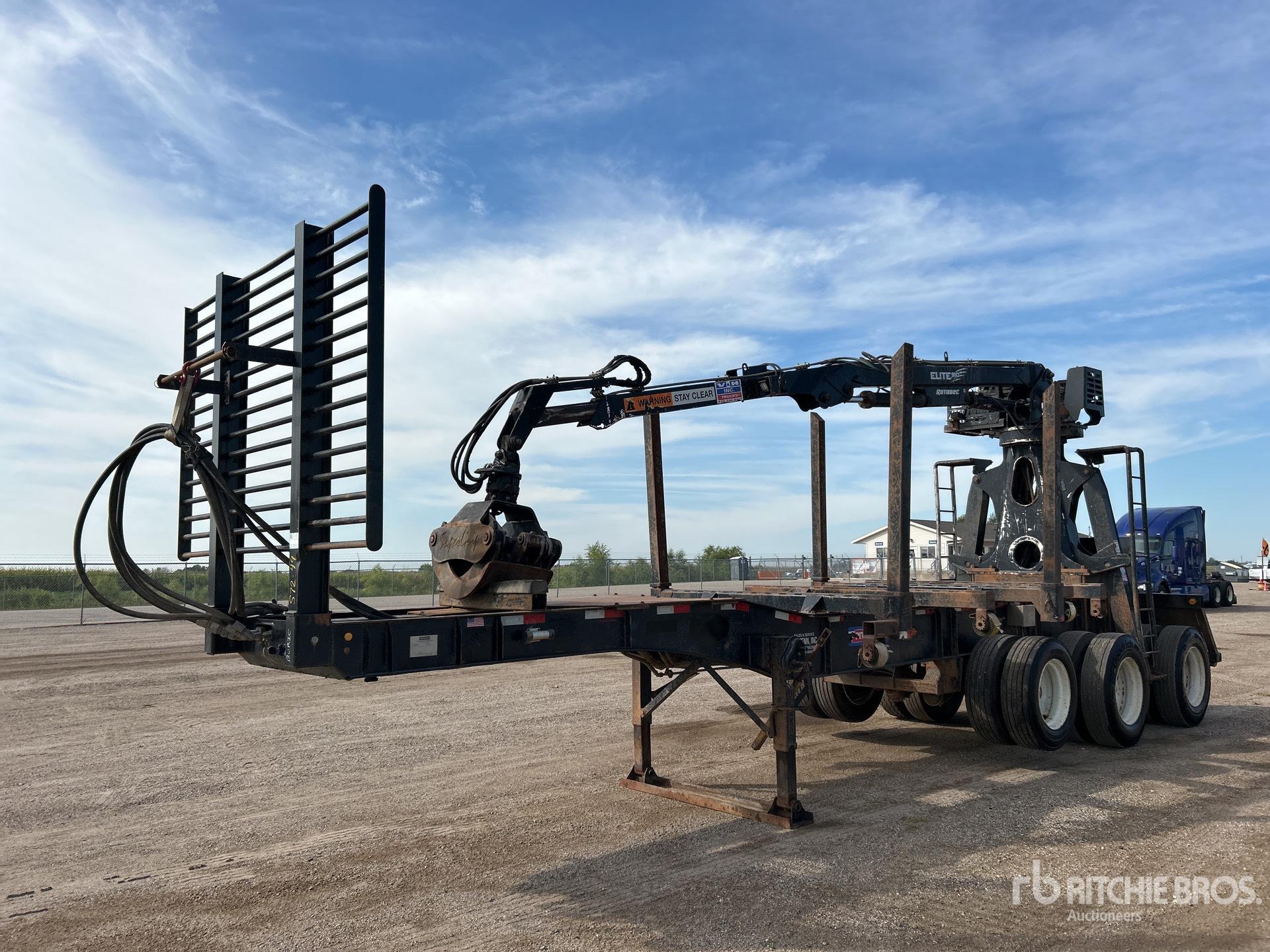

Slightly off topic, I want to move the loader off of the truck and onto a trailer. The original inspiration for the truck purchase is to haul logs & lumber, and I have since acquired a circle mill as I had wanted to. I want the loader on a flat deck with log bunks so it can self load pallets, lumber packs, or logs. The attached picture is the closest example I could find to what I want. It may not be perfect for any one of those tasks, but I'm going for a versatile jack-of-all-trades use of the loader. I'm open to suggestions.
