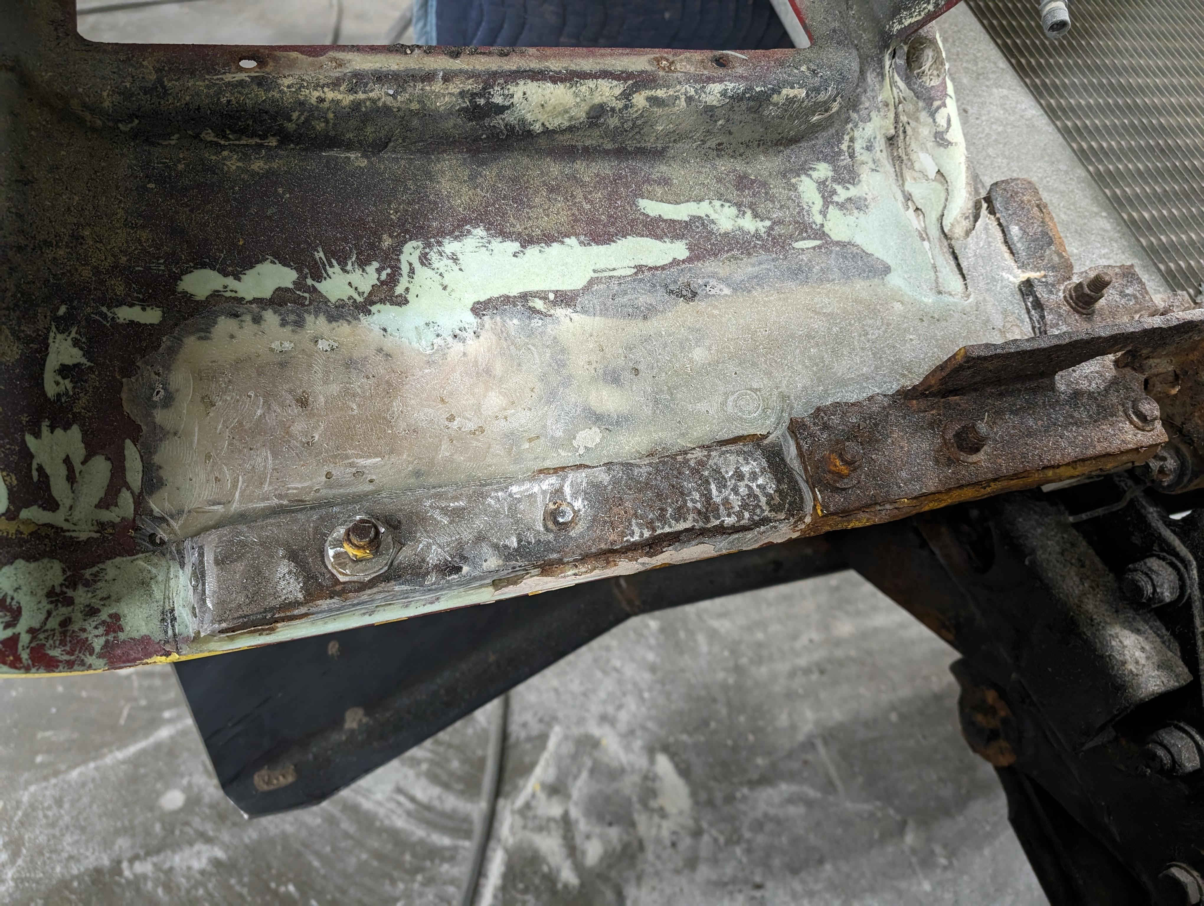

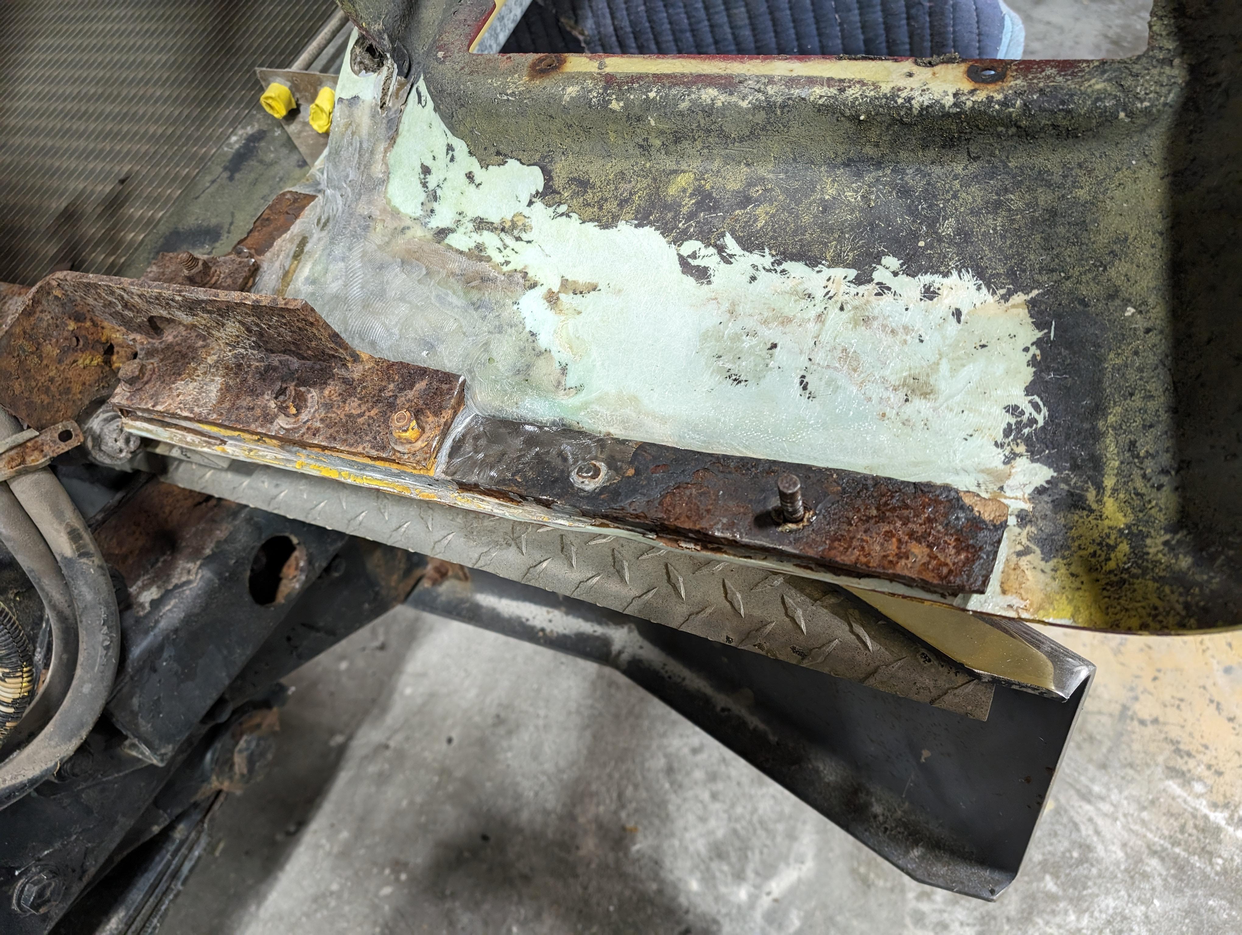

The other question I have is in regards to the hood hinge. Someone at some point did some pretty haggard work under the hood where the hinges mount. I'm finding a piece of 1/4" steel wrapped up in fiberglass. The steel is about 2" or so wide along the front edge of the fender underneath the headlights. It is also under the hinge. What is proper for this hood?

I dont think I need hinges. I am just inquiring about what is supposed to be there in regards to the strip of 1/4" steel.
this is probably not what your  looking for but mine doesn't have anything like that behind the fenders and the hinges just bolt to the fiberglass DM offset cab,,,im thinking someone put those on for possible fiberglass repair reinforce...bob
That's what I was thinking too. The problem is that with that plate behind the hinge, it moves the hood back towards the cab. So I'm not sure what the best option is at this point.

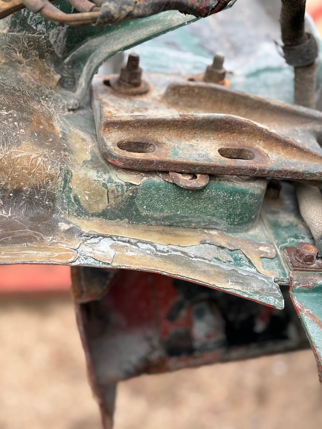

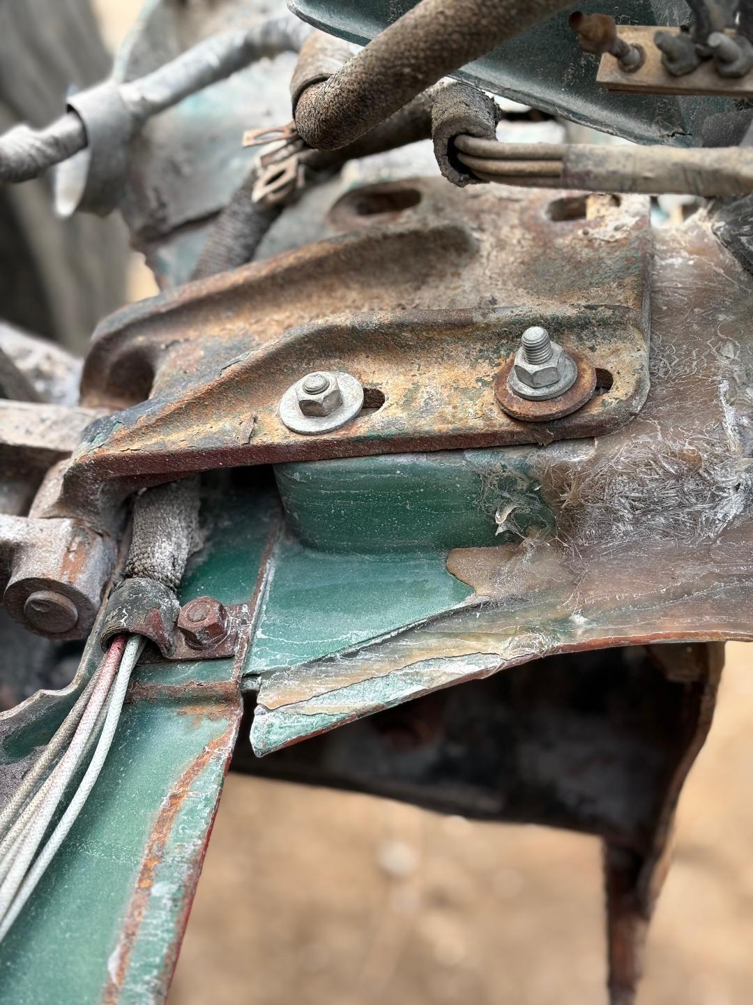

There is a piece of steel imbedded in the fiberglass that provides support to bolt the hood to the hinge.  Even in the best cared for trucks, the steel rusts and damages the fiberglass.  If it gets bad enough the hood can fall off.  That is likely what they were trying to fix with the metal bolted one.

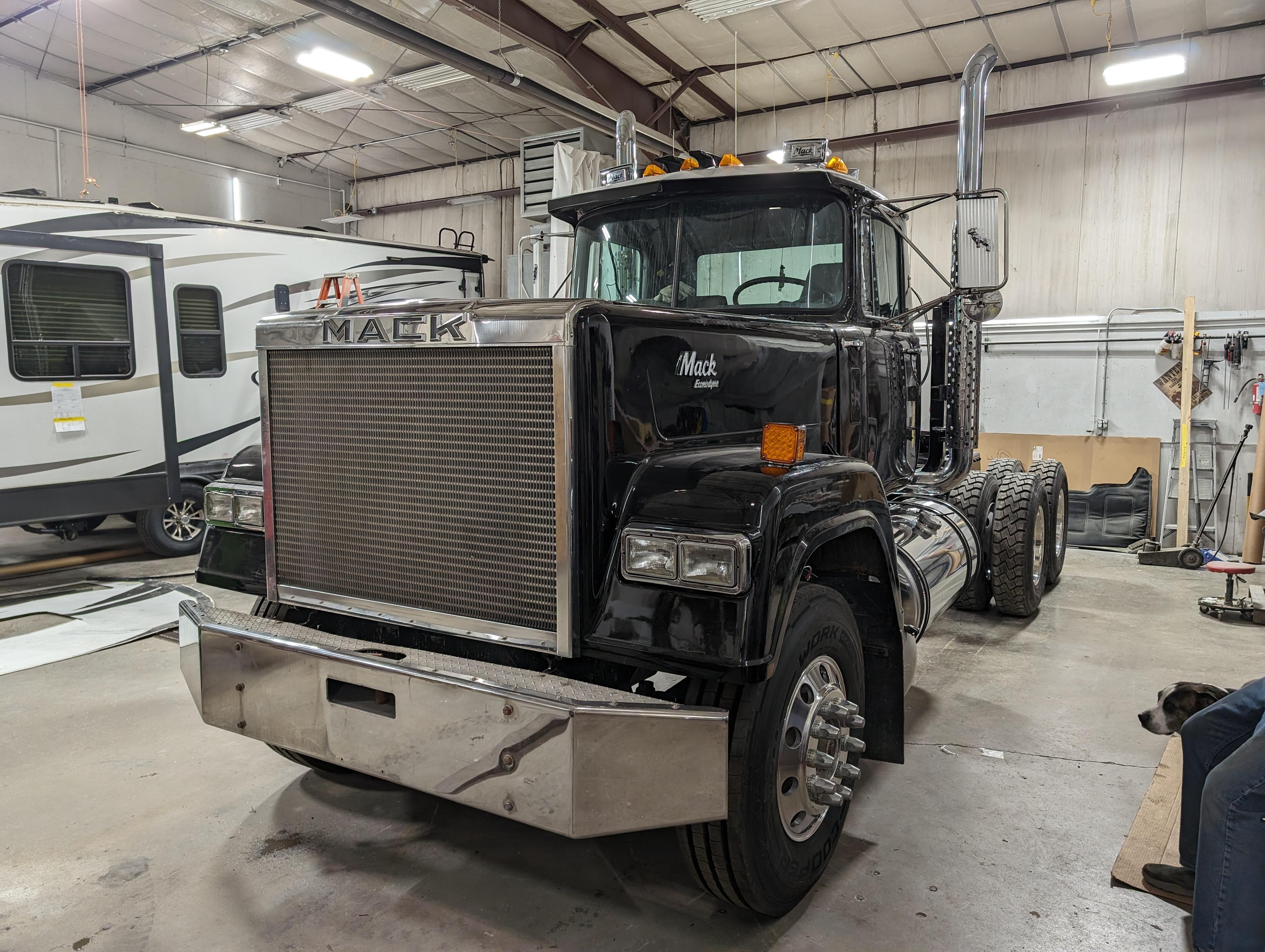

let’s see some pictures of the whole trucks.
mike.
I’m told the repair is to cut out the bad peice of steel and rebuild it like it was originally.  I would think someone on here has done it.  Maybe someone else will chime in.    Nice truck.
That is my plan. Im struggling to figure out what "original" is supposed to be though.
