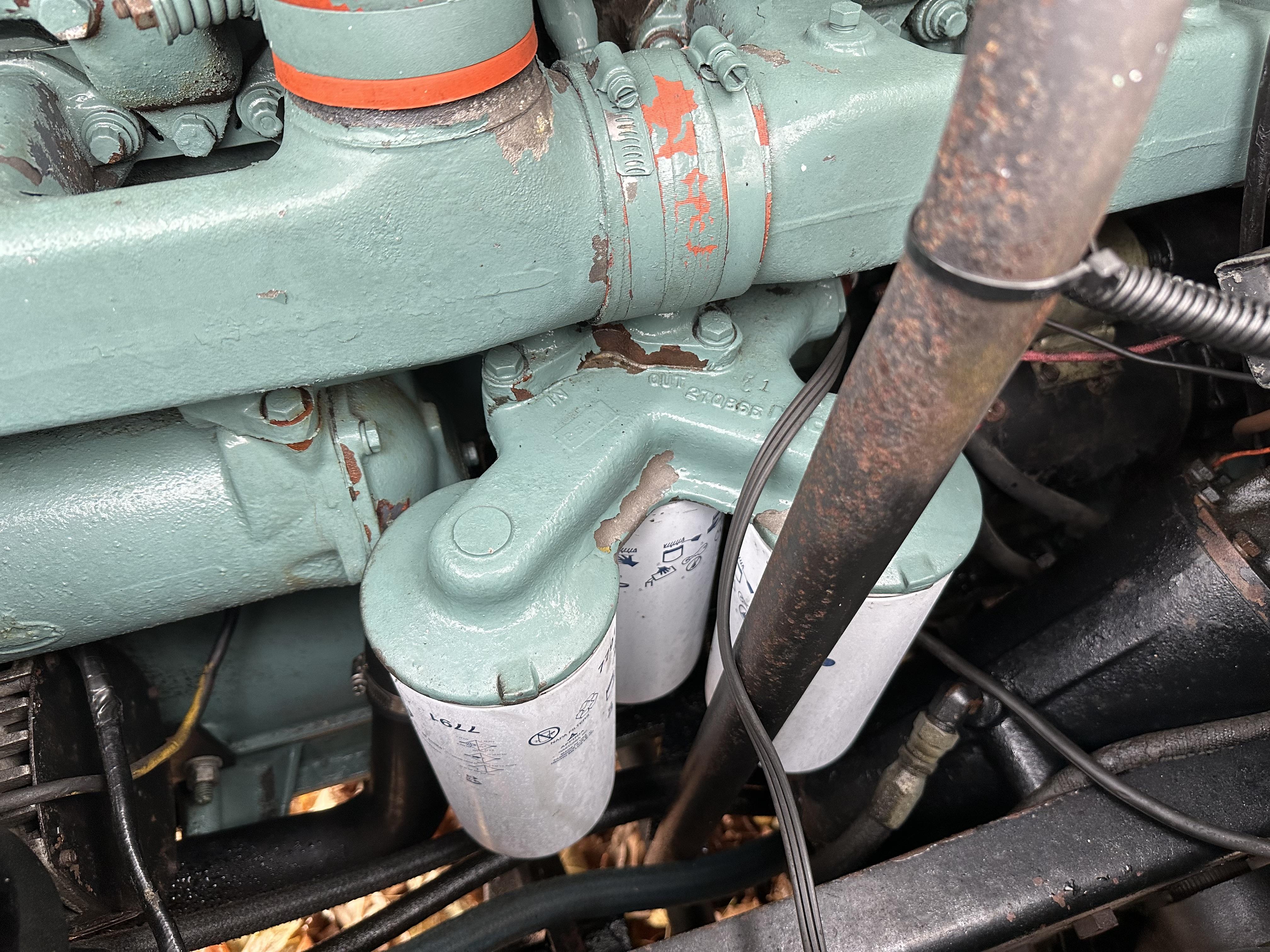

237 came out about 68, last B was 66 I believe.  Terry:MackLogo:i have never seen that oil filter in the third pic.  Does the first pic. Engine have a oil cooler on it?

237's are transplants. I did some research into converting my END-673 to spin-ons, but had to replace it before that with the 237. It was pretty straight forward with the filter housing bolting directly to the oil filter pad. Port alignment was not an issue and there are several gaskets available to line it up. I was looking to do it because the filter elements were getting harder to find. Another plus is that there are no external oil lines to route or worry about. Filters can also be had that are shorter in length to get you around clearance issues.

If you have an oil cooler, it'll sit just below the left side of your intake manifold and to the left of the oil filter pad. It'll be round, about 3-4" in diameter. It should have two large flex lines running into it and back to the filter pad. If you look at my photo of the spin-ons you'll see it.

I’d have to look, I think those might be hard lines. I may be thinking of my original installation on the 673 where I added an oil cooler to it.

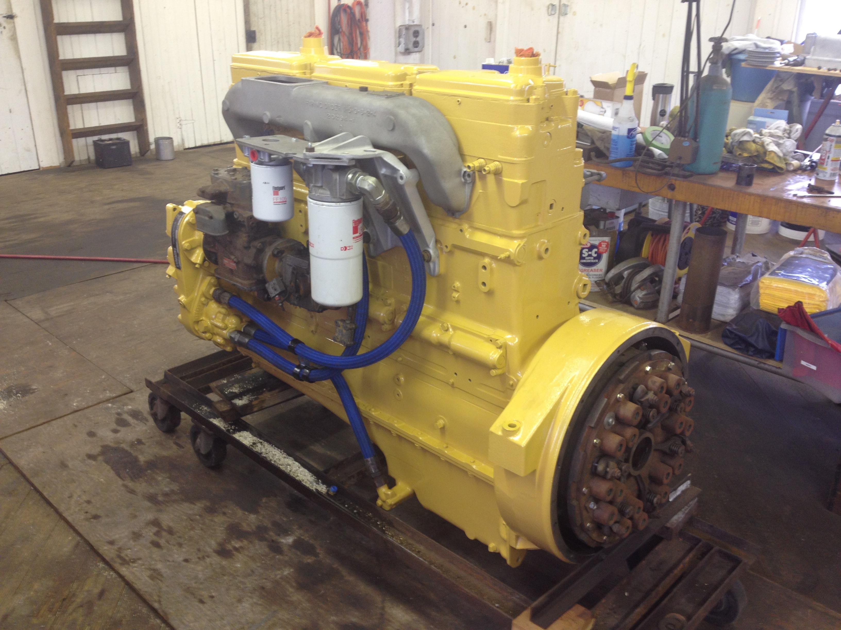

This should be the same one and at a good price I know cat wants over 600 for it the filter holds about a gallon and was used on 15 liter engines one thing to check on them is where it says bypass remove the plug and check for the spring and plunger if it’s not in there oil don’t get filtered IMG_0223.thumb.png.32c14d826218cc9f79820ec6ccfe9d16.png
