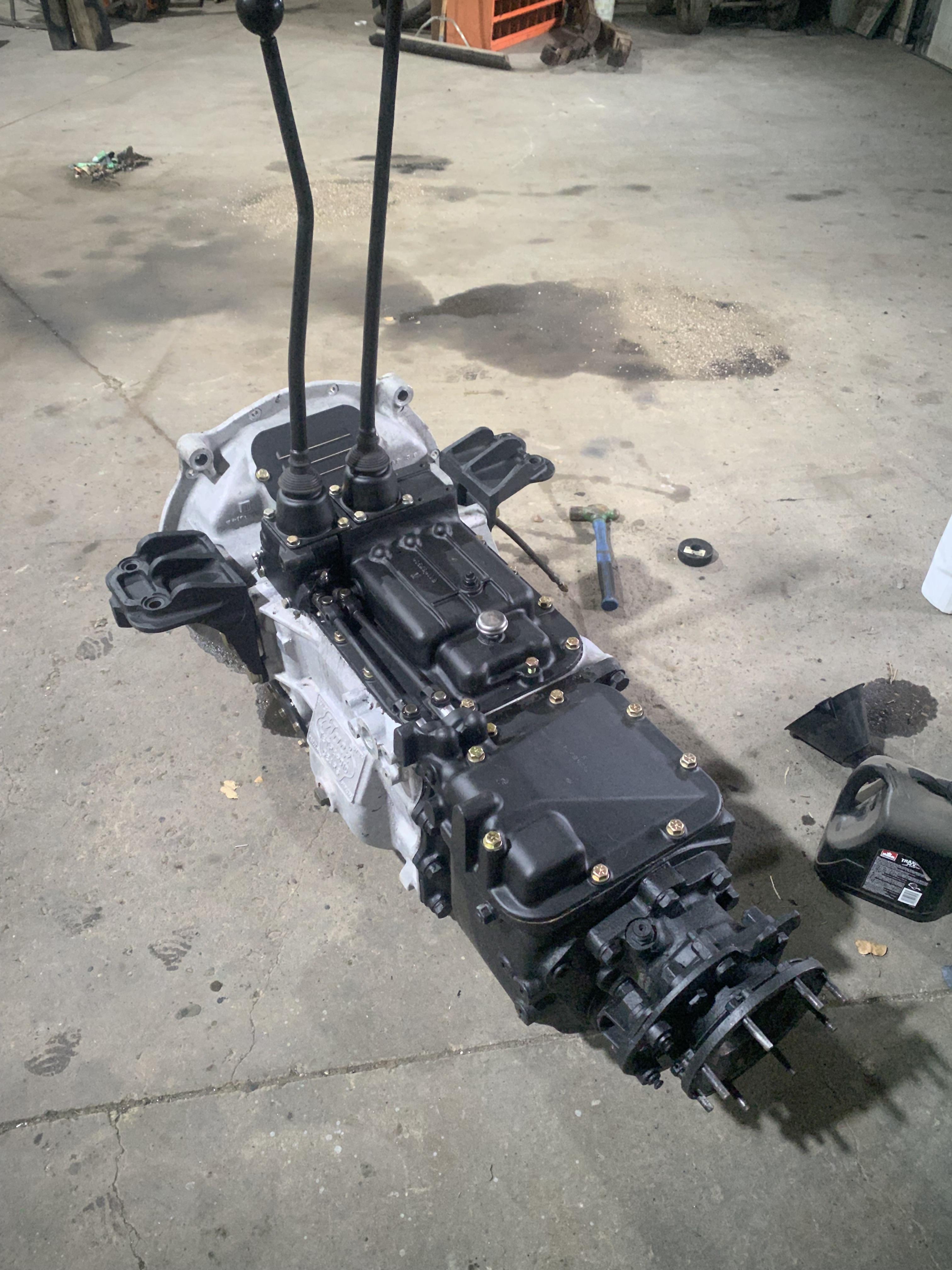

Picked up a fish scale today to check the preload on the countershaft. Manual says 4 - 5 1/2 lbs and I get 5 lbs. sounds good to me. Went to put the drain plug back in and noticed the threads aren't great so gaunt to find a new plug. As near as I can tell the threads in the case look OK. Tried an "experiment" on the shifters. Didn't want to take them apart to remove the rubber boot to powder coat and didn't want to paint sooooooo, I bought a 4' stick of 3/4" heat shrink and put that over them, shrunk it on and looks pretty decent. Of course it formed to the shaft shoeing most of the tooling marks that were there but that's OK. Should help quell any vibration noises coming up from the trans also. Pretty happy with the way that turned out. Also had a broken bolt in one of the PTO covers so got that out. Powder coated the PTO covers (that I had to make since one was missing and the other bent) as well as the shifter rods for the aux box. Making a little progress.
The main shaft end play is managed by the main box main shaft rear bearing assembly. There are two cone bearings in a housing and also some special "nut" in there which you turn to tight up the bearings and which is set in its (new) place by a set screw you need to drill new hole for its new location. That procedure can only be done with the main shaft removed from the transmission. It gets off together with the rear bearing assembly and requires the compound box to be off the tranny. When I was doing mine I honestly forgot about that and when both blasted and painted boxes were together with a gasek on a sealer I just cheered myself up with checking up and down end play of the main shaft front end and feeling "Ok in general" rest it as it was.
Haven't understood did the discussion went along the in-between the housings gasket. Maybe it worth to point out its thikness influences the countershaft pre-load/end play. So the figure which exceeds the specs may be result of thicker gasket installed in the past.
