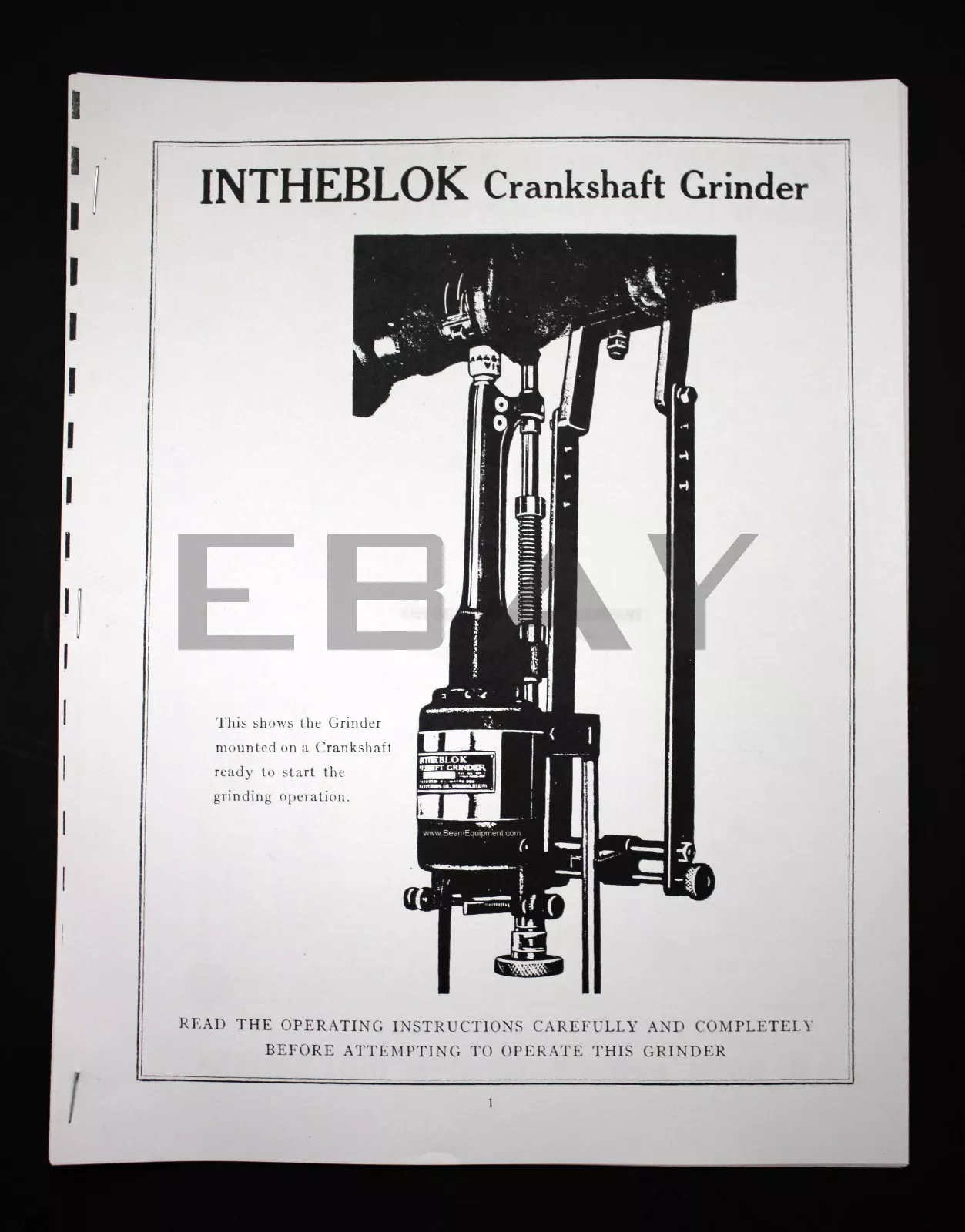

Thanks for that I have heard of turning journals in the truck i never knew how they did it that’s good to know if I ever have an issue… I have no idea what my engine looks like inside it I have great oil pressure and no blowby

  On 3/22/2025 at 4:34 PM, Mark T said:
Looks like you can get one of those things on ebay too Bob. ez peezy
Expand
Excellent thanks for that Mark I should sign up with eBay. I have never used them, but they do have a lot of cool stuff for fair prices.
If you think about the in-chassie crankshaft grinding, it is a band-aid repair, and the real problem will have to addressed at some point.
When a rod journal goes, often the main that feeds it also is part of the problem. Doing 6 rods and 7 mains in chassie is not cost effective.
I'm not saying it doesn't have a place. An antique truck that isn't going to be working year in year out, can be given a 2nd life for minimal cost.
I have knurled many valve guides myself with excellent results, but also know the life-span of the repair is not the same as a new guide.
Labor costs "back in the day" were a tiny fraction of labor costs today, that is both good and bad. I don't want to be slaving away for $5.00 or $6.00/hr grinding crankshafts  from below on a dirt floor. I don't want to get into an "in frame" to find all different under-sized bearing either.

  On 3/22/2025 at 4:38 PM, Mark T said:
IDK about the Ebay thing. I just noticed it on the liturature in the picture.
Expand
I never had any problem with any of my in-chassis rebuilds not lasting. In construction or city service one million miles really never happens. By then the truck is worn out.
And when you are working on a contract, what are you going to do, have a month of downtime while some automotive machinist plays with his wiener? Half the time one of those bastards touch something it comes out wrong anyway. They hire from the same pool of idiots that everyone else does. It's not like they have guys that grew up in a machinist monastery.
And I think it's a hell of a lot faster and cheaper to cut one journal and roll in rods and mains than to take the engine out of the truck and tear it in a million pieces. Again, it all comes down to downtime. Contracts have lots of penalties in them for not completing them on time. Not to mention if you play around you can lose your ability to get a performance bond. Even without contract issues, if you let a customer down and he has to call someone else because he needs stuff done, you stand a good chance of losing that customer.
I had to do one that lost #5 crankpin. Took out the rod (hot) and #5 piston. (855 Cummins)
Once the damage assessment was done, a used engine was dropped in, ($2500 IIRC) and the truck back out on the road. Original engine had rear head pulled, new piston and rod, then flipped over and a re-ground (.010/.010) installed (about $750 IIRC). The engine was then installed back in the truck and run to 1.3mil on the original build (not counting the new crank) and then out of framed and re-installed in another truck.
$2500 was the cheapest and quickest way to get back on the road, that used engine is still in my shop "core" pile and is complete. (also listed for sale on this site)
I did call around for an in-chassie crank grind, but in both time and money, a used engine was faster and cheaper. IIRC it would have taken -.030 or .060 undersize on that pin as well, not a good bet.
